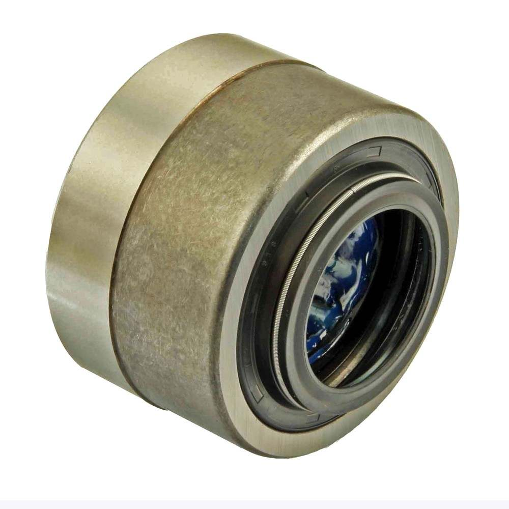

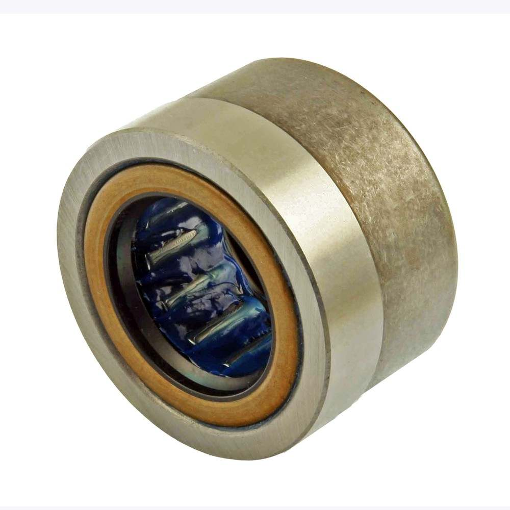

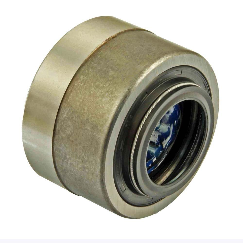

Larry, GM makes a bearing that uses a different part of the axle shaft to ride on. As you can see it comes with an integrated seal.
RP513067 or 19340164:
View attachment 424337View attachment 424338
Yep, I have used these. When you get the old seals and bearings out, these are a breeze to install. Like @swathdiver said, it moves the bearing location to a different spot on the axle. It is a money saver and works well.
I heard about those before, but didn't realize they were available for the Tahoe. I'll wait until summer when I have some time, then pull the axles and see what they look like.

How would this requirement be any different from installing a regular bearing? I would think any bearing should be a smooth tight fit.
It is not different. Sometimes people remove old with wrong tools or wrong way and then booger up the axle tube or the tube itself is enlarged a little over time from a bad bearing. This part is not a fix all. It is to relocate a bearing surface, that is it.
