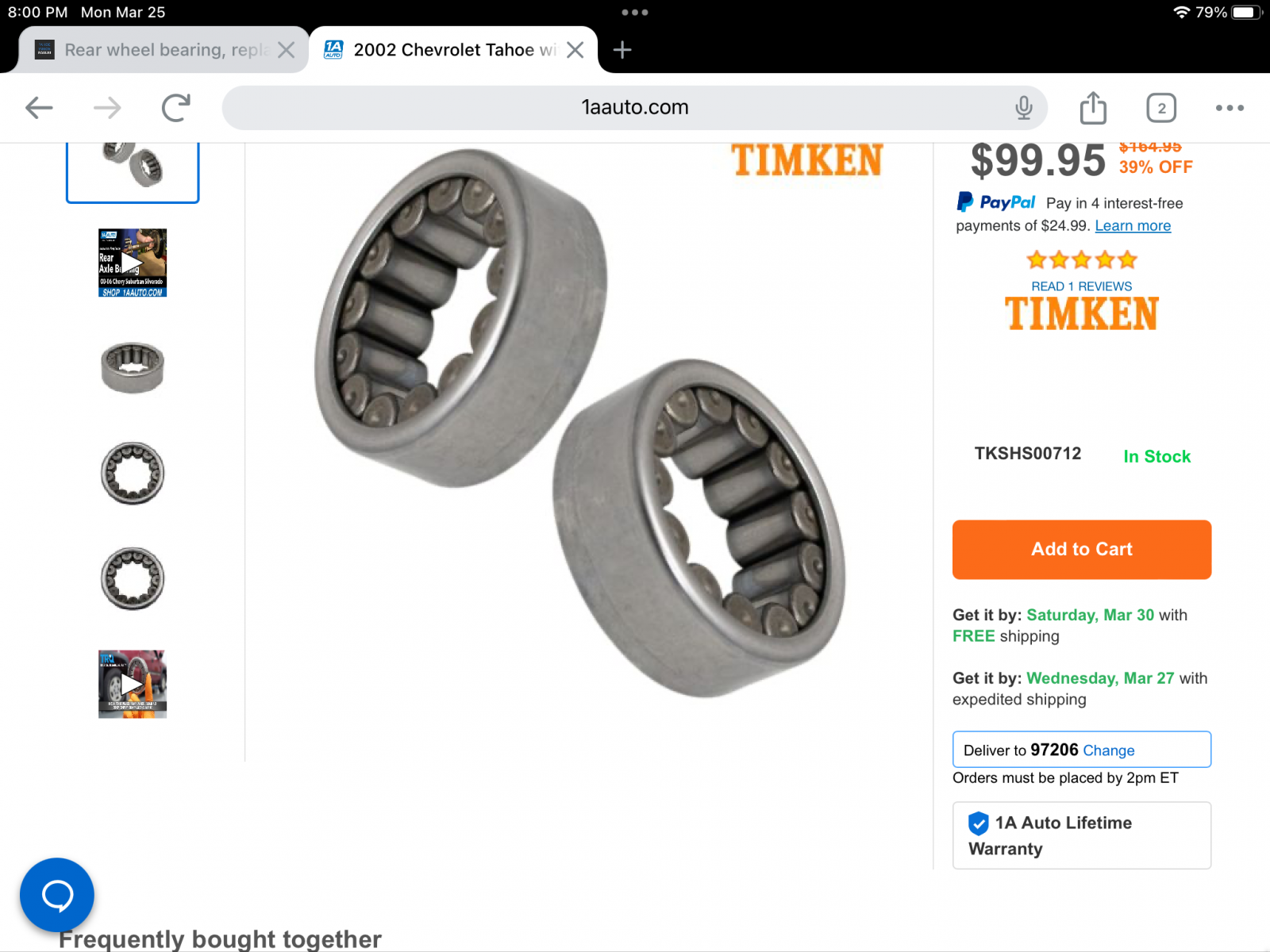

There’s no way imo for the axle to be damaged. I replaced my rear wheel bearings on my 02 a couple years ago. The bearings were like new. At 150k. There wasn’t any visible wear to any of the rollers period, nor axles, and these things are beefy. I replaced them with new OE. Just don’t get carried away with the puller and make sure to not insert it too far where the reluctor is, it’s pretty easy to tell where it’s hooked the back of the bearing. You’d have to go pretty far in to hook the reluctor, just be aware there is one right behind the bearing.
52,954
This is the bearing design of the OE ones.
