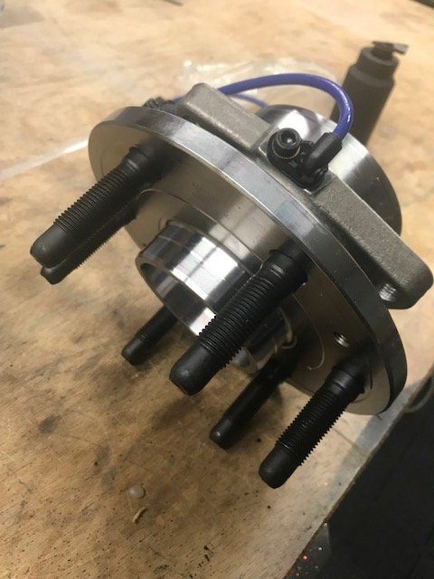

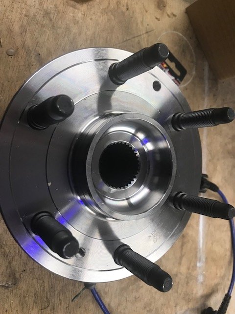

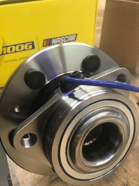

Had same issue at about 150K miles on my 2002 Yukon but it was a grinding sound that got worse over time (I don't drive a lot). Ordered Summit Racing brand hub for about $80. Problem solved.... for about 12K miles. New/different sound but coming from the same area, front drivers side. Traced back to the hub again. This time replace with Moog Hub from Summit Racing (about $118), problem solved. Hoping Moog lasts longer. Replaced with Moog less than a month ago so can't attest long-term durability. Summit was good about the replacement/warranty. I have been told a hub going at 150K mile range is normal. After reading responses, wish I would have ordered Timken

The MOOG unit that I put on the drivers side recently looked pretty good to me. Only a few thousand miles so far so I cannot attest to the longevity yet.....
