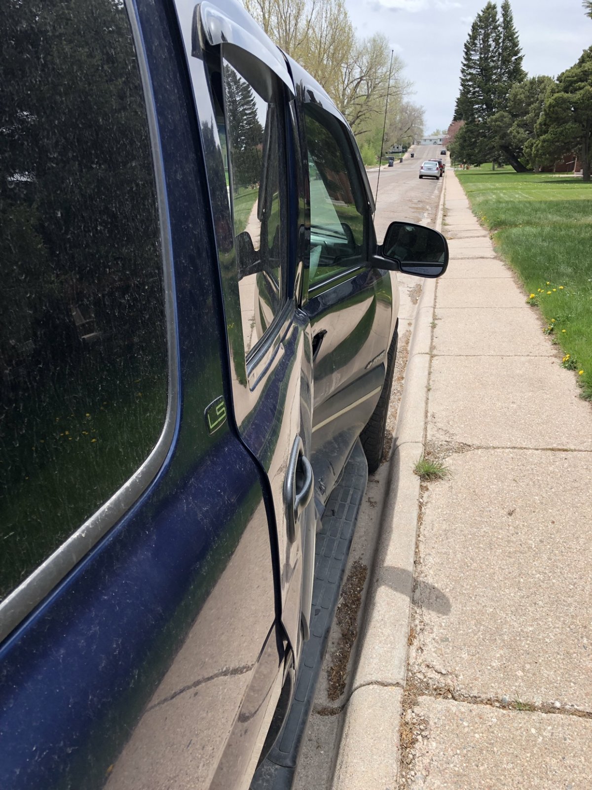

I think is safe to say your b pillar is bent. Body shop with frame machine can pop it out. If you do the prep is much cheaper than you may think. (Altho nothing feels cheap in your sitch).

Rocker looks fine, which means floors are fine. I would yank doors, come along on a tree to yank the b pillar out and hit the junkyard for doors seatbelt and any trim inside that cracked. Cut the airbag off the seat and be done. That, my friend, is the cheapest you’re gonna get away with.
Not saying its right but its by far the cheapest way.

Sounds like what im going to do!

I tried to use a toe rope and my truck to bend out the car we were working on. A winch or come along would have been better. However if is just b pillar, should be pretty cheap for shop to put it back to factory spec. Their machine has laser measures and will get it just right so you have no problems with doors. You may see a crease in metal from impact but other than that will be like new. If you prep i wouldnt be suprised if you could get it done by shop for around 100$ or even less. At lwast here in arizona where i live.
