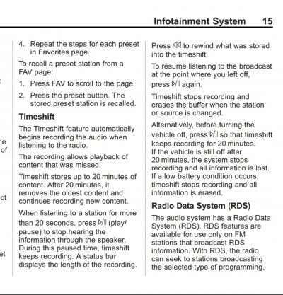

Pausing live radio is called Timeshift

Timeshift sounds so outdated even though it’s a new feature to OEM Navi systems.
“Try GM’s new Timeshift feature on the all new 100% electrified People Mover for 64”.
