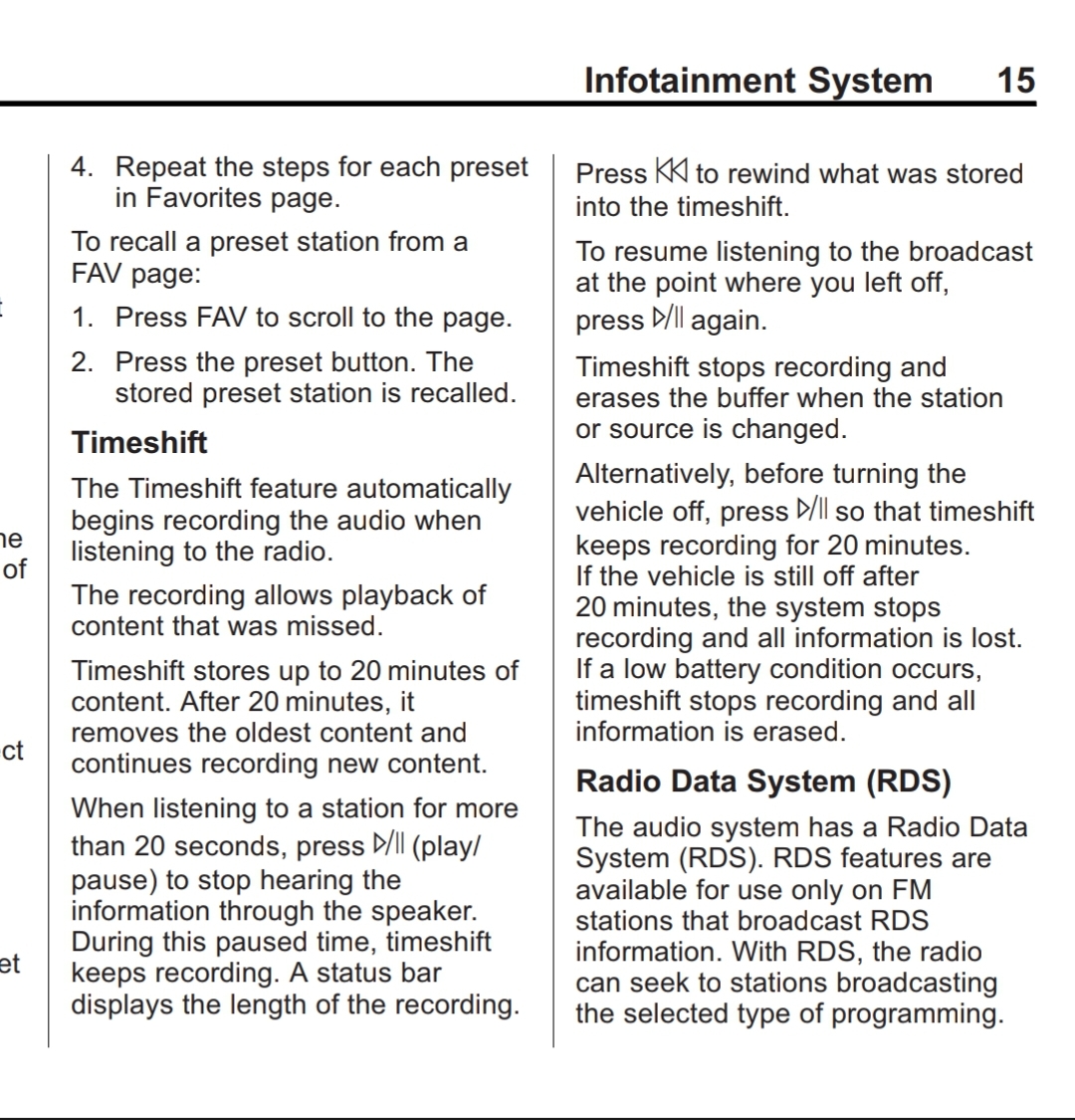

I know about pausing live radio, but that secret menu trick where you tap the screen so many times in the corner then enter a code only works on the 07-11
Pausing live radio is called Timeshift
