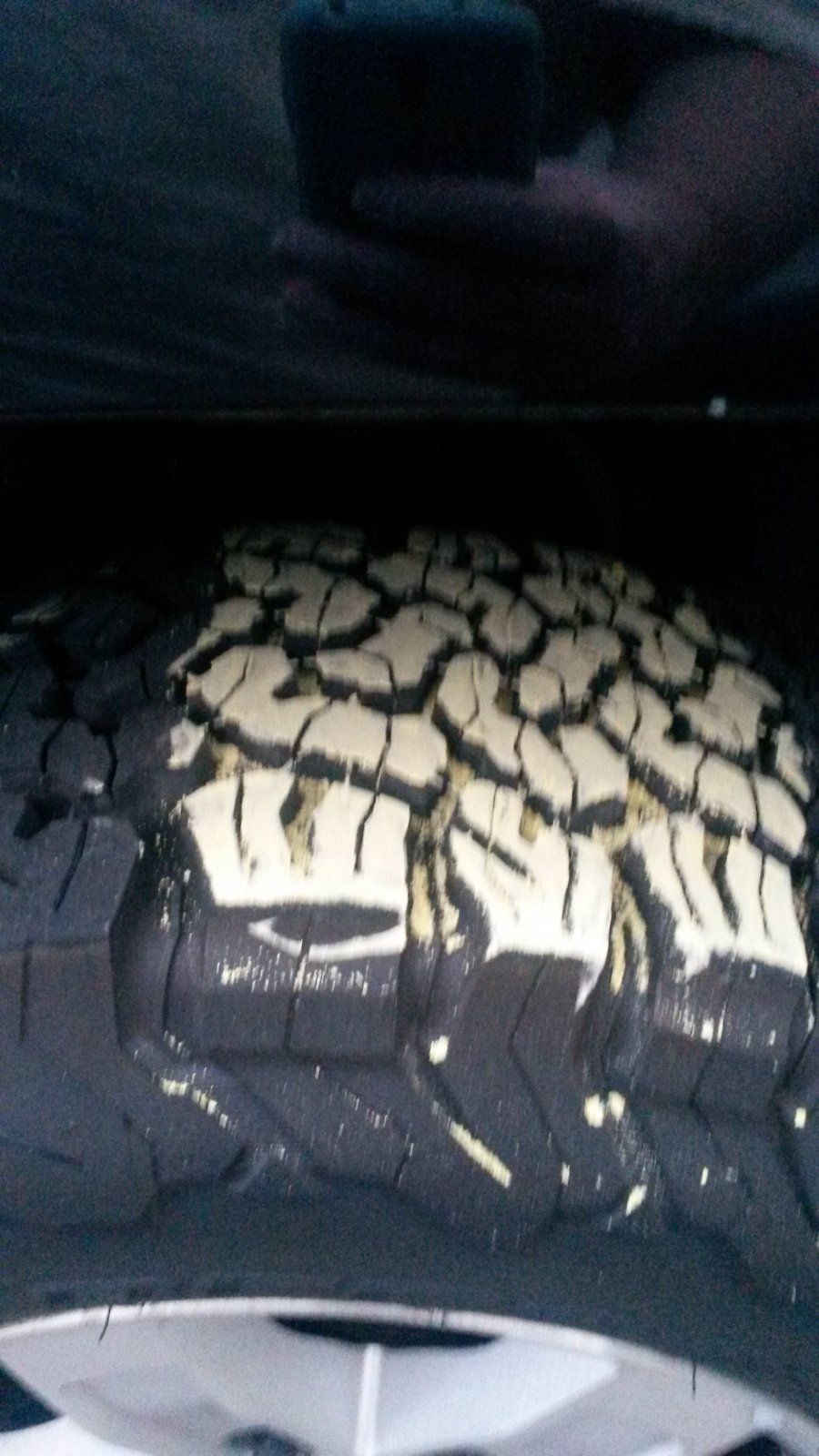

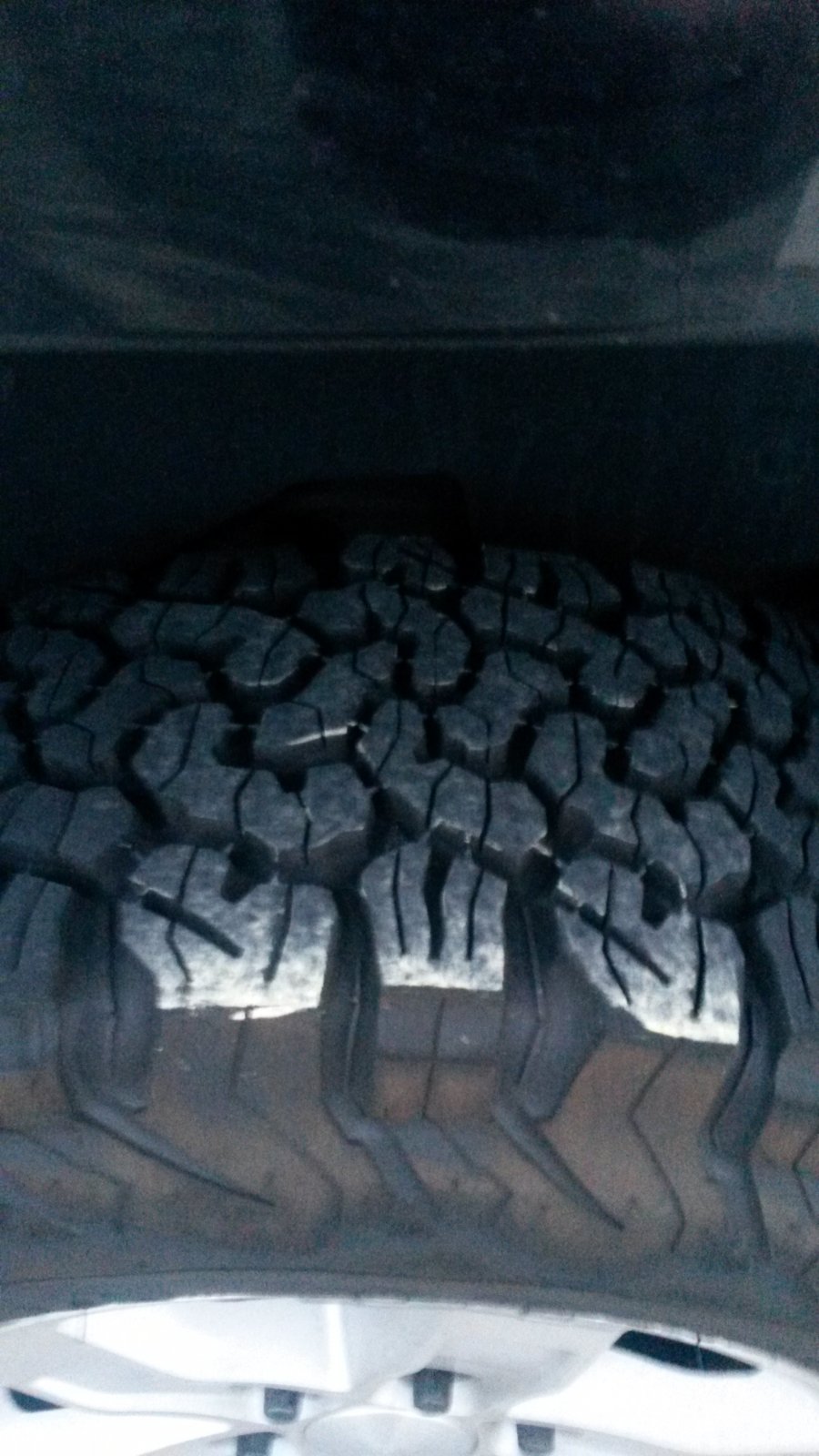

A tire dealer once suggested I go to a vacant parking lot or quiet street with a piece of chalk, mark a front and rear tire tread with a couple of lines across the tread, then drive straight for a short distance. The chalk will show you if the inflation is too much (center wear) or too little (outside tread wear).

^ make sure tires are at operating temp for that ;)
