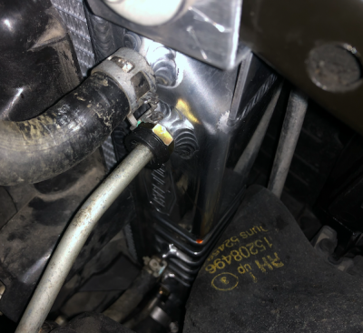

Also don't forget to install a restrictor in the port leading to your suge tank or the radiator will over cool and throw a CEL and "engine hot" message on the DIC.
Ask me how I know.
I used the aluminum valve stem from an old TPMS sensor i had laying around.
There are pics of it in my build thread.

Not having a restrictor in that port will cause the truck to run too cool, especially in colder weather. It doesn't actually cause the truck to run hot but when the ECU doesn't see the temperature rise to a certain point within a certain amount of time from a cold start it "thinks" there is a problem, like no coolant getting to the ECT sensor and it shows engine hot on the DIC.
I don't have any experience with the Mishimoto radiator but it would be easy to check by pulling the small hose that goes from the surge tank to the passenger side end tank on the radiator and seeing what size hole is in the port.
I suppose if you think you are still running too hot you could drill out the restrictor in that port, assuming it has one, a little bit but it may cause over cooling when not towing.
The problem is that this port feeds the cooled water/coolant from the cold side of the radiator into the surge tank and back into the engine BEHIND the thermostat.
So at higher rpm it pushes more coolant through the surge tank and into the engine, effectively bypassing the thermostat.
