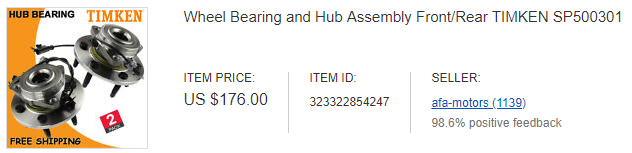

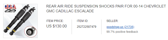

That's a fantastic deal! Just paid $97 delivered for one and in August of 2017 paid $130 for another.
My new favorite thing is stuff on eBay with the "Make An Offer" option. Hahaha.. I'll shoot them a crazy low offer, they counter, I counter, then I often end up getting things super cheap I was already prepared to just pay market price for. That's what happened on those Timkens. They were listed at like $215 or something, got them for $176.
