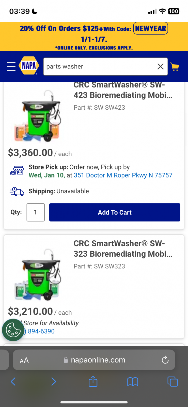

Hmm.. so that’s a service I guess? I went to the Cintas website, and found it, but I’d rather have a dedicated washer I can use when I need it.
Ok, I re-read the post you provided. Thank you. These are definitely not cheap! lol. I am not seeing anything looking around that uses the “real” solvents anymore. Perhaps another victim of EPA “guidelines”?
