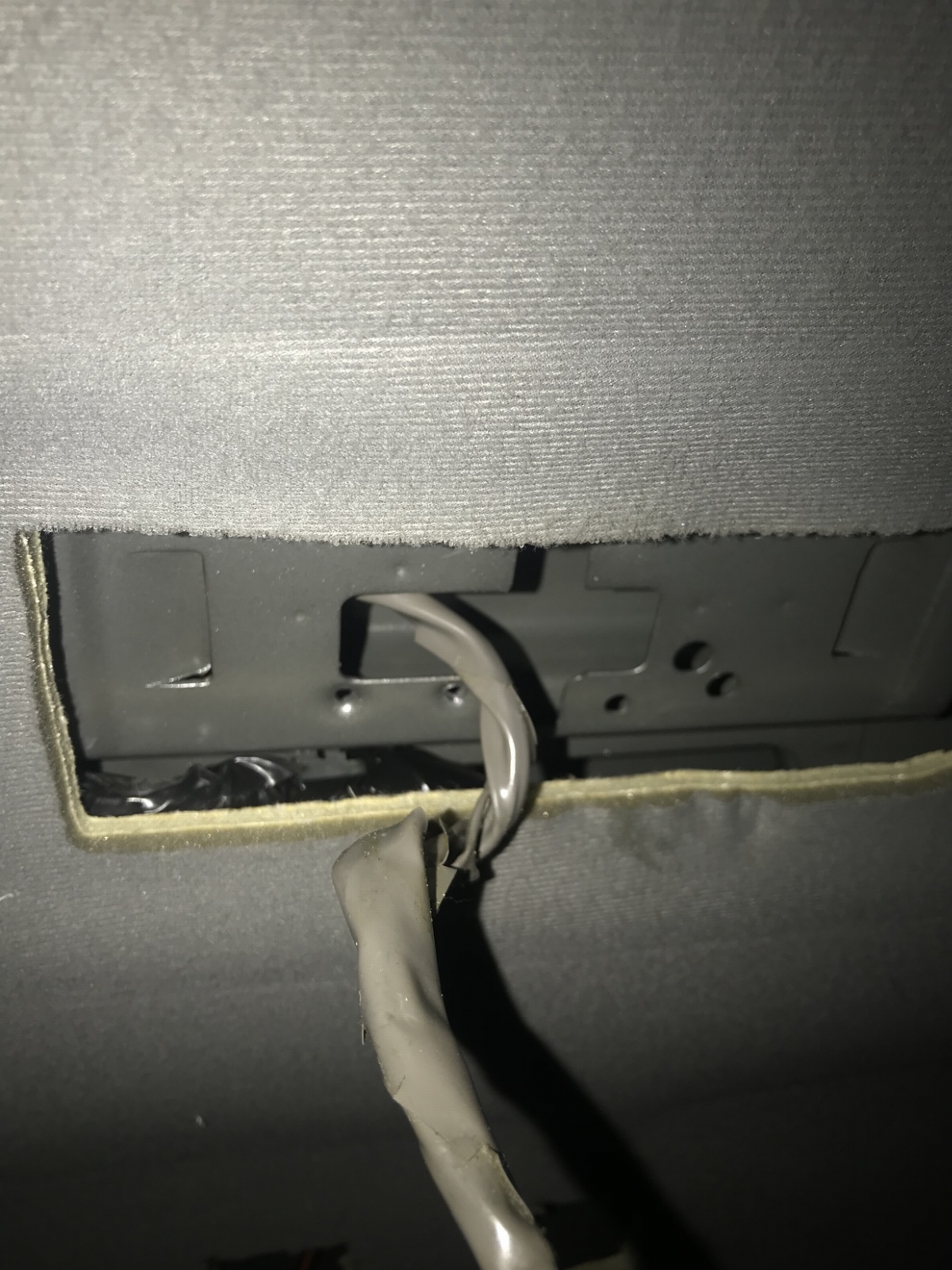

Installed my overhead console tonight. Even found the wires for the map lights tucked away so it was just a matter of cutting the holes for the rear clips, pulling the map light plug up to the front and swapping the rear heat/ac controls( i know mine works so keeping the other for back up). Headliner was a pita but got it done in a few hours. Here is the finished look and some along the way pics.
