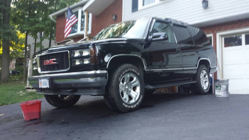

De-pollenated the Black Box ... she looks like a different vehicle without all the tree **** on it.

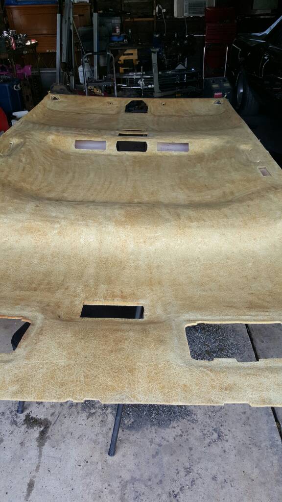

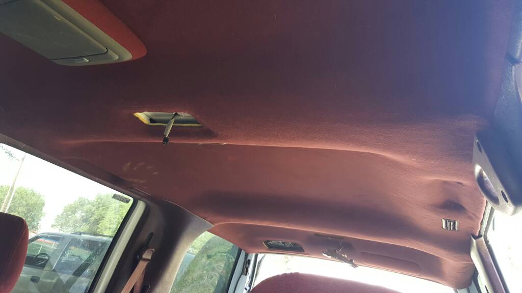

How are you going to do the visors? I just finished my headliner the other day and the visors are much more faded
Fwiw I'm very pleased with the fabric from stockinteriors.com

That's where I got mine, they will send you color samples for free, I got the 3.5 yard, extra wide kit, cost like 120 shipped and included the adhesive. Removing old crap was the hard part,I ended up using a 3m white rolloc disc on an air grinder
Blew it off and washed it with alcohol and started glueing be patient and work in small areas, the hardest parts will be the rear Gump going into the cargo area and the side where the c pillars are

Beautiful truck man what year are those factory rims? Been looking to get some oems for mine but worried about if they'll fit my 98 Yukon
Czykats44
Dis Member
Aug 25, 2015
218
85
Glenville, NY
Dallas, Thanks man! They are '15 z71 rims off a silverado. Look up a seller on ebay called ezdealin they sell factory takeoffs fair prices too.
