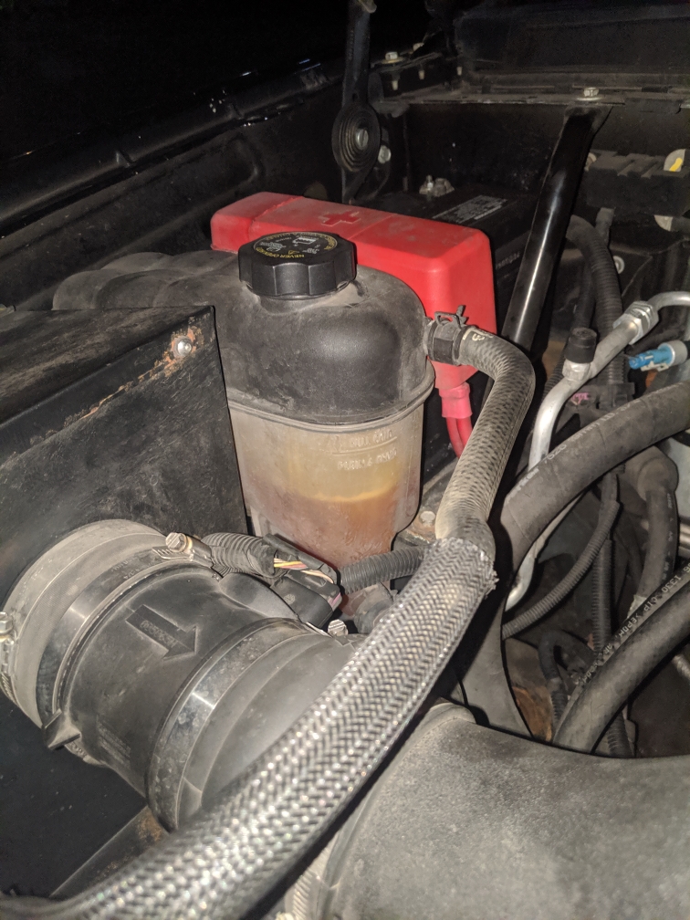

on second thought, how low was the coolant?
I put the half gallon I had left over in the Tahoe just now. It's drained that much since I topped them off recently.

as long as it's not going to freeze you can just add water until you can get it replaced, I think you said it was a short trip to work anyway?

I think my radiator is cracked.
When I was a young man, when we had metal radiators, we used plain old kitchen table pepper to stop leaks in our radiators. Sealed up some pretty big holes on the side of tanks with pepper. Those are your transmission cooler lines, cost about $50-75 for both new ones, very common repair. I have to do mine and the engine oil cooler lines too.

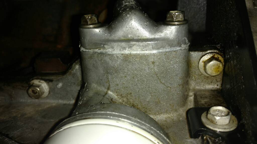

You'd have hoses running from just above your oil filter to the radiator. It'd be an aluminum block with aluminum tubes coming off of it going upward then forward towards the front. Like this:
Otherwise, you'd have a factory block-off like this:
Yours is an LS optioned Tahoe right? Even some LTs don't have the external engine oil cooler and big fans and such, especially since she has 3.08 gears if I remember correctly.
