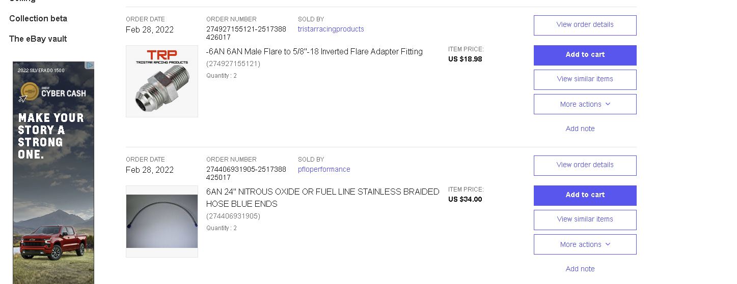

looks good but those worm clamps will start to leak in about 2-3 years at the most, maybe sooner facing down like that
these adapters are the sizes needed if you even wanted to make it leak proof
need 2 of each size for plug-n-play with the trucool
View attachment 449993View attachment 449994

mine leaked (after a while) and I don't know about the chevy grillls but on my gmc I couldn't even reach them to try tighten them up without pulling the grill or bumper off so I researched the sizes needed to adapt the trucool thread to ANC and gm quick connect to ANC and just did a permanent fix and I had to relocate it anyway because it was making the engine get hot under a heavy load in the summer. I have to kind of wonder too if my clogged 3rd cat was creating part of the heat problem I guess I will find out this summer.
doing a 100mph up a steep upgrade at 8000ft when it's 80deg out will stress the oem cooling regardless lol
