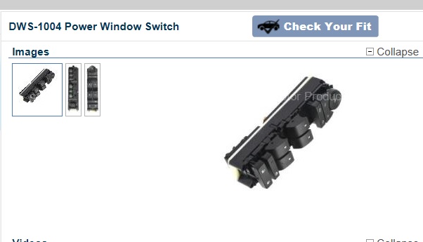

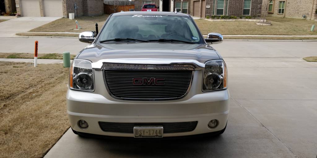

3 Screws later, the switch was in.
I plugged in the wire hookups in the right locations, put it all back together, started the truck, and BAM! Nothing. Nothing worked on the switch. Wouldn't move the mirrors, wouldn't adjust the mirrors, and would only let down the driver side window.
That SUCKED.
So I started Tshoot. Checked window switches on each door. They worked. Crap. Bad new switch, i thought. I unhooked the wire harness from the new switch, and plugged them into the original switch. WORKED, including the blinkers on the mirrors! Bad new switch! So, I installed the original switch back in the door panel, put the door panel back on, and boxed up the new switch for return.

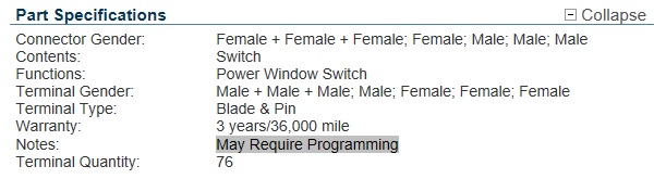

Then I said, let me go look on the manufacturer website to see if I missed anything (no instructions included with the switch):
Yeah, so adding power mirror functionality is NOT a plug and play evolution.

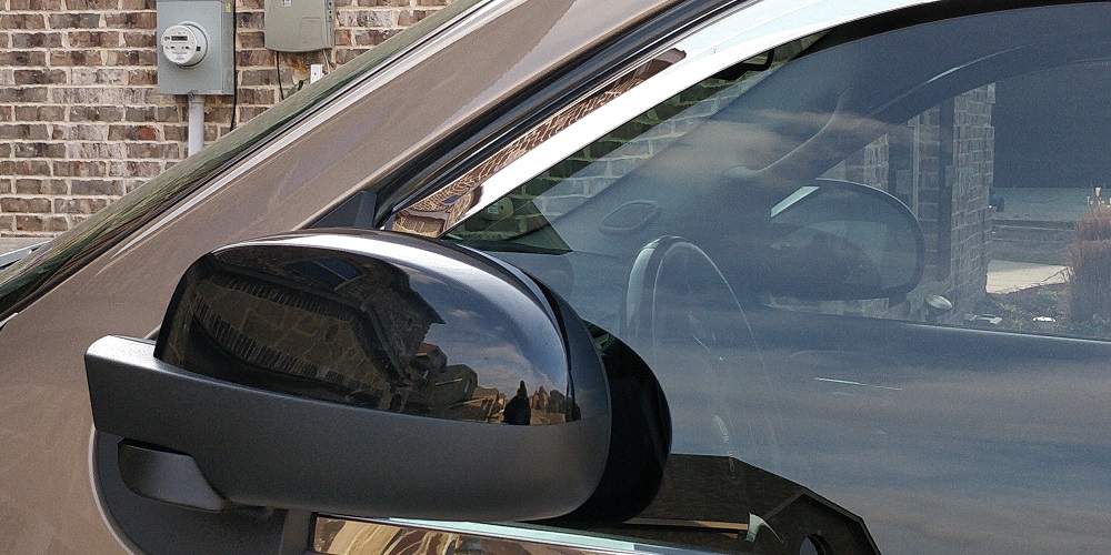

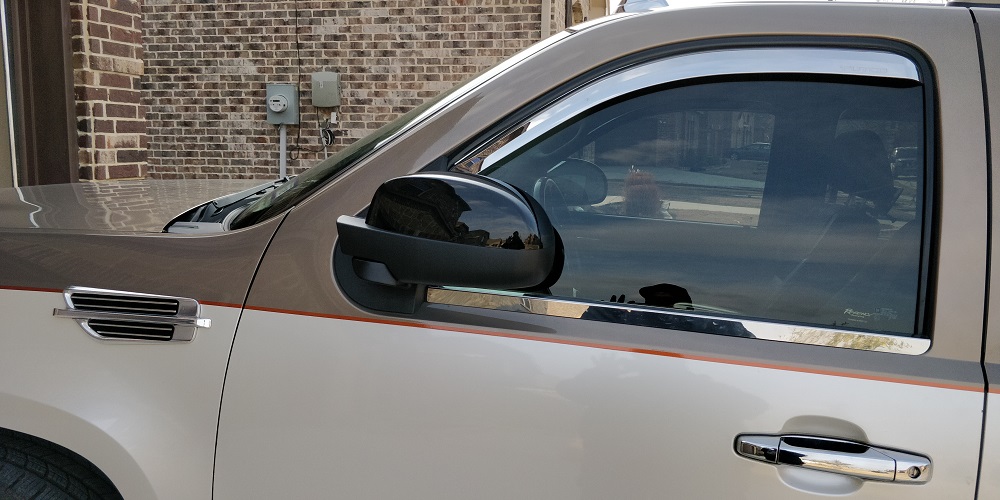

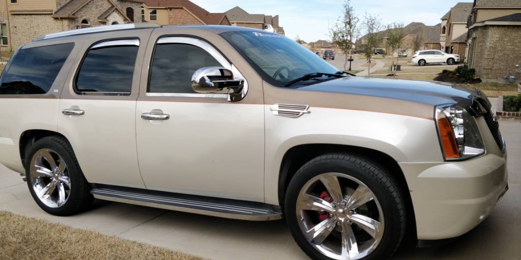

EPILOGUE: I slapped the new switch back in the truck this morning. A trip to the dealer and $95 later, I HAVE FOLDING MIRRORS!!!
I'm now waiting on my chrome covers, and I'll be 100%. Yay me!

You need a USED switch that is already programmed. If you buy a NEW switch, it needs to be programmed. You also need a USED programmed PS switch to control the PS fold function.
Edit: nevermind. You figured it out, lol.
