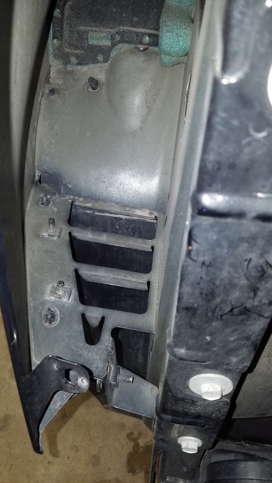

Does your model have the louvers cut into the inner fender? I think their purpose is to keep large debris from being sucked up into the airbox.
it does, I thought it was a bit weird, something to do with how air flows around thru the fender? they are angled up, like air would flow down into the fender well. it's pretty sealed up really, besides what comes in around the headlight, I didn't see a real air pathway to the box they made behind the air box.
just for a test I ran my hose from the fog light hole, up to the louvers and just zip tied it there. didn't see the point in cutting them up just testing stuff.
I very well could be feeding it with two pressure sources, around the headlight and the hose. I may move it so that the hose gives it an exit to a lower pressure area. get some fresh air flowing thru it to cool off the area. still seems weird to me I'd pick up over 10deg from the grill to 6in after the air filter. I was able to check this morning. the outside air was a little different reading than intake, but as soon as I started it. it jumped straight to the same temp, and then maf temp slowly climbed as I drove to work, while the outside air stayed the same.
right now I think my maf is just getting to much radiant heat where it's at. so the temp reading might not be reliable.

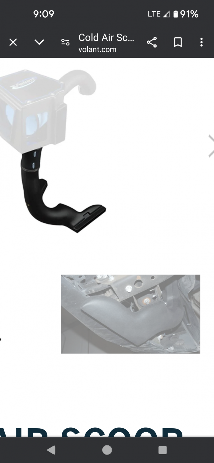

that looks like the volant box, I've almost bought it twice. they seem to have a ram air tube for it, but I'm not sure it would fit mine.

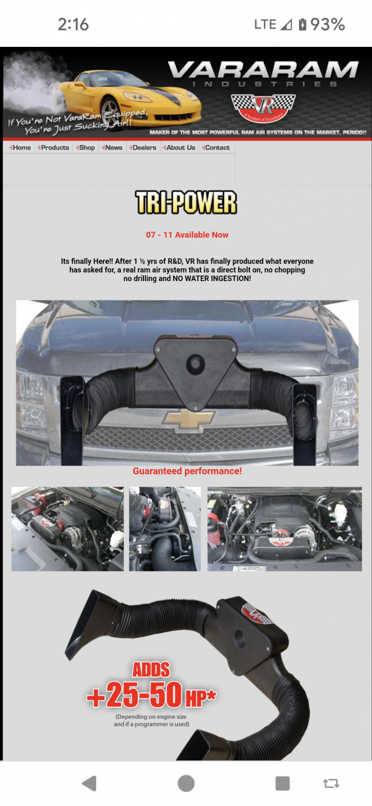

have you seen the vararam intake? I really like that design, gets completely away from the hot fender and gets it's air from a nice cool high pressure source right in front. but sadly mine has its 2 coolent reservoirs and 2 coolent pumps right where it runs. so not something I can easily move around.
I’ve not seen the vararam intake :shrug:
The air filter box opening is right above these louvers. The is where the engine gets its air and my Yukon has no real opening under the headlight, so the air is brought in from this low pressure area of the fender just in front of the wheel well. I think the louvers are there to keep any leaves, plastic shopping bags, etc getting sucked up into there
I'll have to look at it again next time I have it up in the air. I was looking for air coming from the front and didn't see anything. that's why I was thinking just the space between the head light and bumper cover. everything else seemed very sealed up.
if it is just pulling air in from the under side, that would explain when it's warmer than outside.
I could have sworn Volant sold something like this for the suv's as well, but it I can only find the trucks now.
