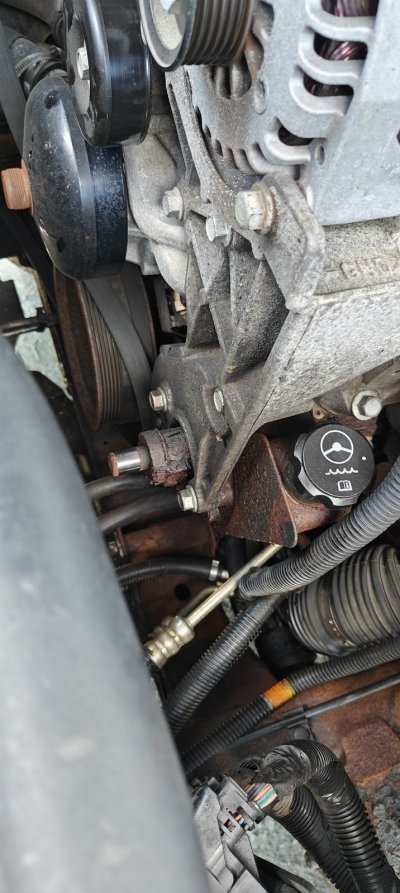

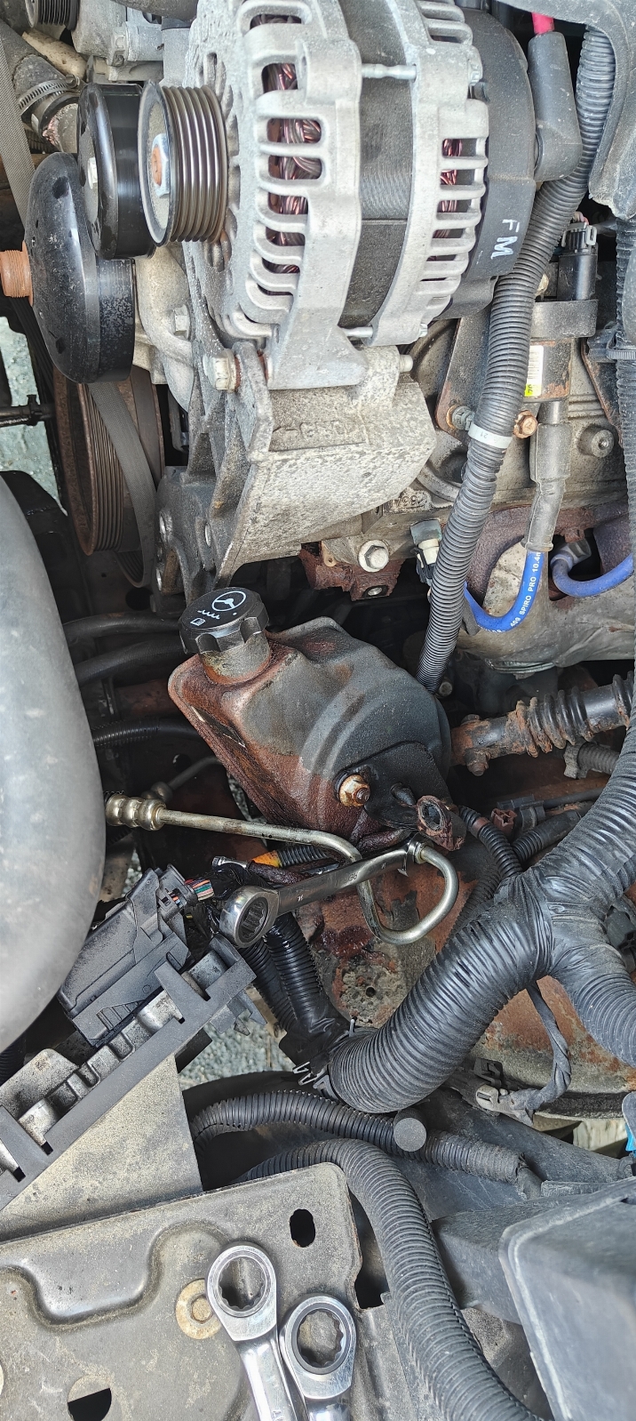

99% of the videos I watched for learning about the removal/install procedure had you spend a bunch of time disconnecting the battery, alternator, and removing the accessory bracket. That seems stupid compared to how much less work it is to just unscrew four 15mm bolts, twist out the PS pump, and disconnect the high-pressure line in plain view, instead of fumbling with the fitting after the pump is reinstalled.
