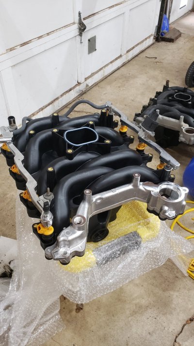

New intake with injectors and fuel rail swapped over....
I've actually got it all back together and everything torqued to spec. I don't have the alternator installed yet though, I'm going to go pick up a new one tomorrow. This one is going bad. It low charges when idling and causes the charge light to come on when sitting at stop lights. Like on out trucks, It takes only about 10 mins to install it.
