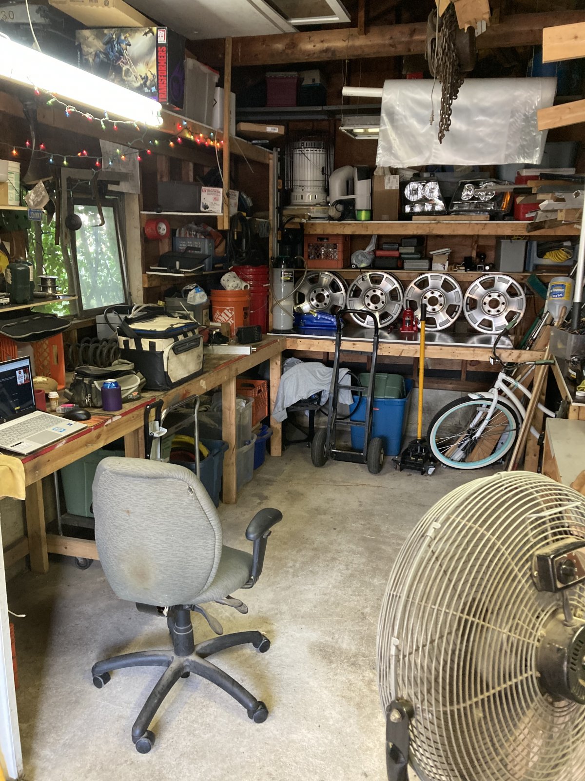

I made garage bling out of those rims.

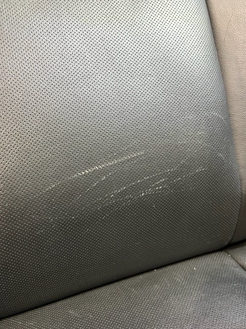

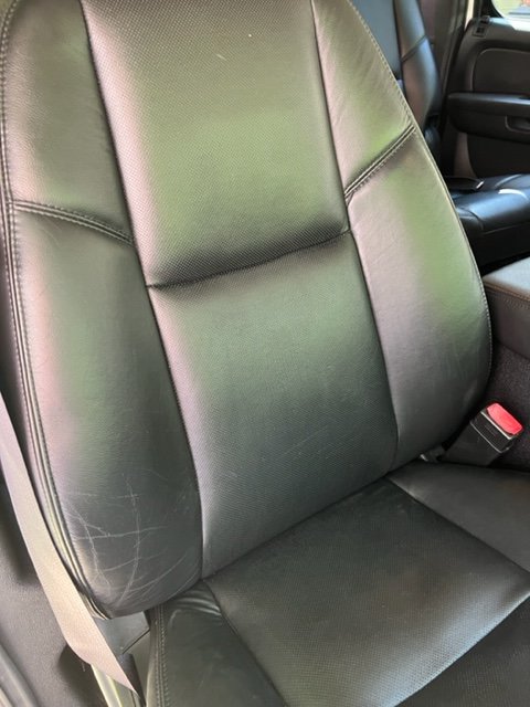

I fixed some scratches on my passenger seat. These were probably caused by some web gear or suspenders during hunting season. I used an autoleatherdye.com kit. So far I only did that center panel where the scratches were as a test. You have to put the dye on THIN to prevent plugging up the holes. I put on two THIN coats. It came out pretty well.
