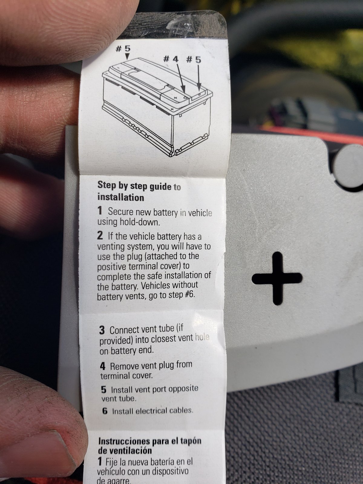

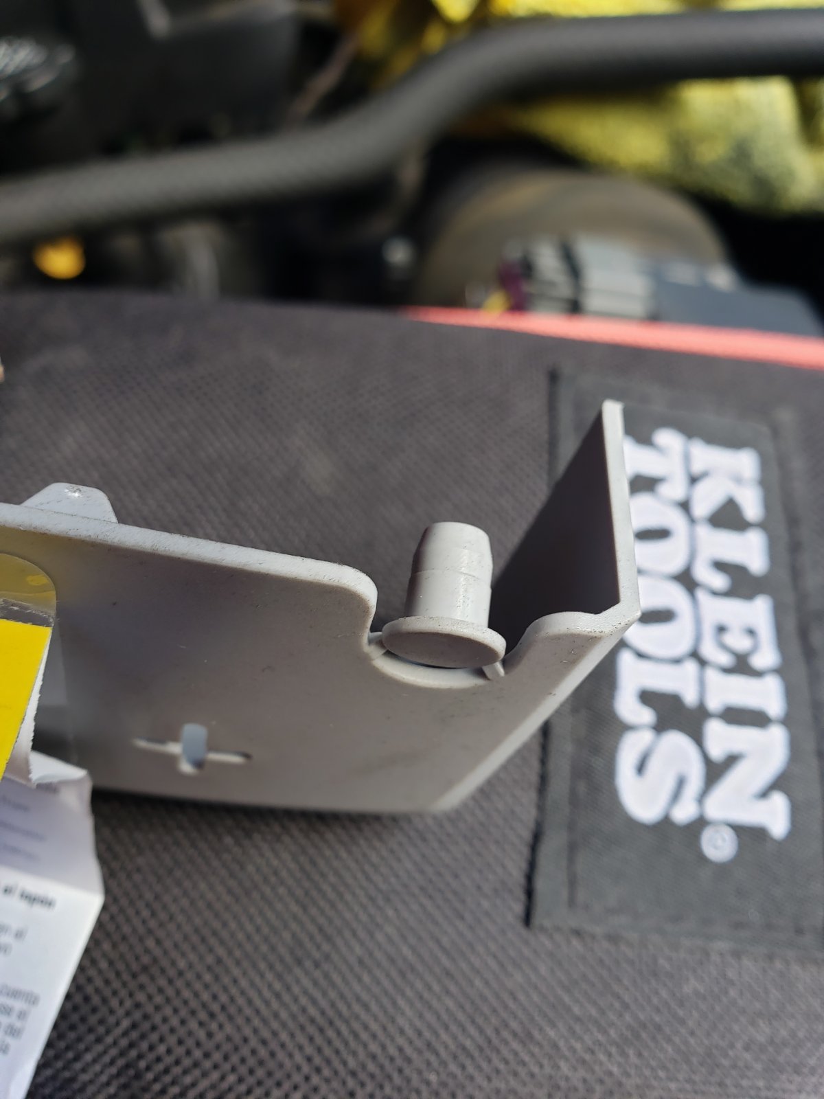

Installed new interstate flooded battery. Instructions say to cap vent port? This is new to me. Old battery had no ports plugged. What say you? Plugg

Yep do as they say. You don’t have a vented system. Be glad you don’t, those batteries are a b*tch to get to. They’re usually in a compartment inside the vehicle.
Mild Cobalt had that garbage in the trunk, and had a vent tube that went down through the spare tire well and vented under the car at the back.
