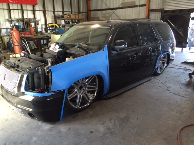

Rear 2" drop springs arrived from Tony. May order the airlift 60769 1000 tomorrow possibly.
Do most folks t the lines off ro help equally distribute the load, or do yall run the air lines independently to reduce body roll from the transfer of the air from bag to bag? Just trying ti get my game plan together.

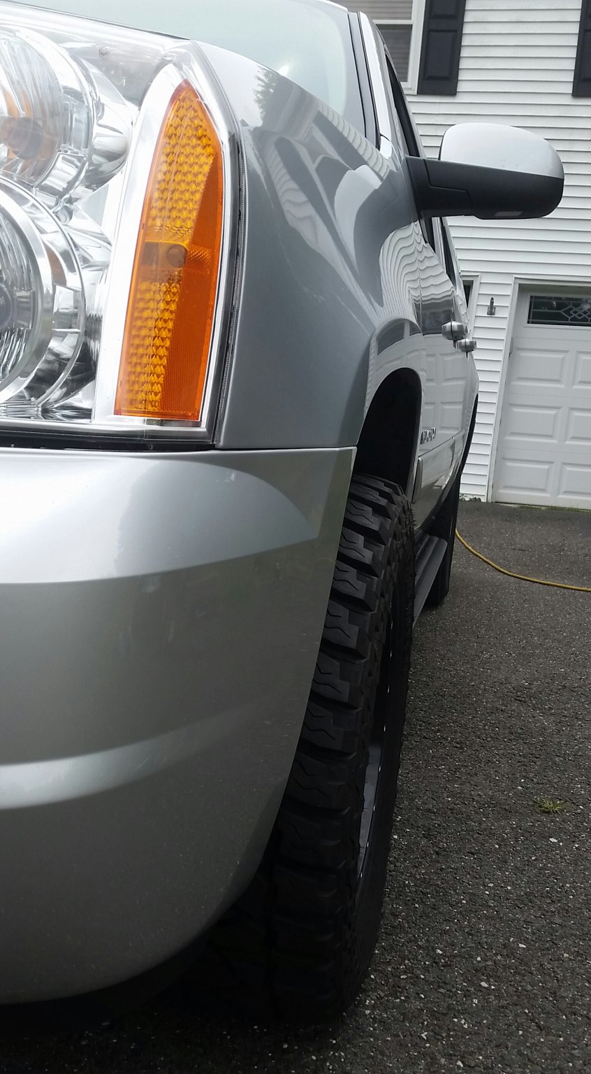

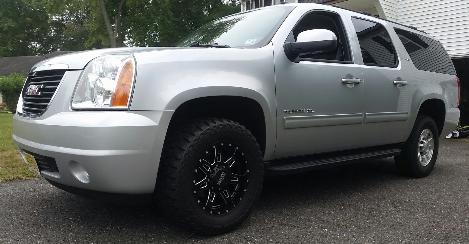

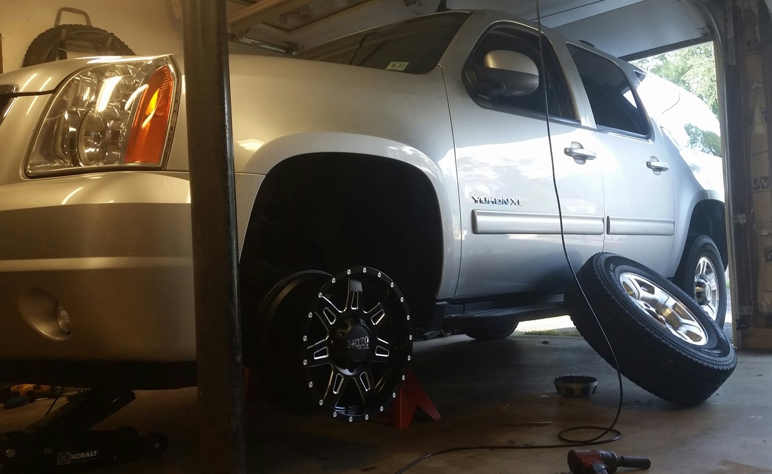

Did some more wheel well trimming in anticipation of the new tires, and test fit a wheel for a preview... hoping to squeeze in some 305/60/18s I got for a steal on craigslist..
305/60r18s aren't too tall, they're just really wide. I don't think you'll have much trouble fitting them on your 2500 though.

Nice. What's the make of the side mirrors?
I am not sure I got them off eBay if you would like I can get you the sellers name he shipped very fast and price was good
Man it looks bad ass! I really like the lift and mirrors. It's much more beastly.
Thanks man I can't decide if I wanna leave it like that or add a 20" light bar up front
I just picked up a second set of rims for my LTZ, also 18". I'm debating on what size tire to go with, but I'm leaning towards 275/70r18 because they're generally lighter than the wide tires.
Yeah I was looking at 275 and 285 options that were 32-33 tall, then these 305s popped up on ebay, basically new for $500.
There are two areas where I think they'll be close after the trim work I did. Going to mount one up today or tomorrow and see what I'm working with.

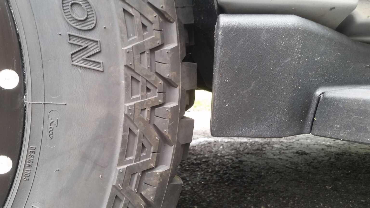

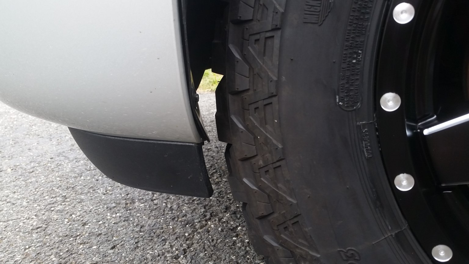

Test fit the tires and wheels. 305/60/18 ATZ P3s, 18x9 +18mm MO975 wheels, bars cranked ~1", front and rear of wheel well trimming, a bit lessthan 1/2" clearance at the closest spot when turning.
