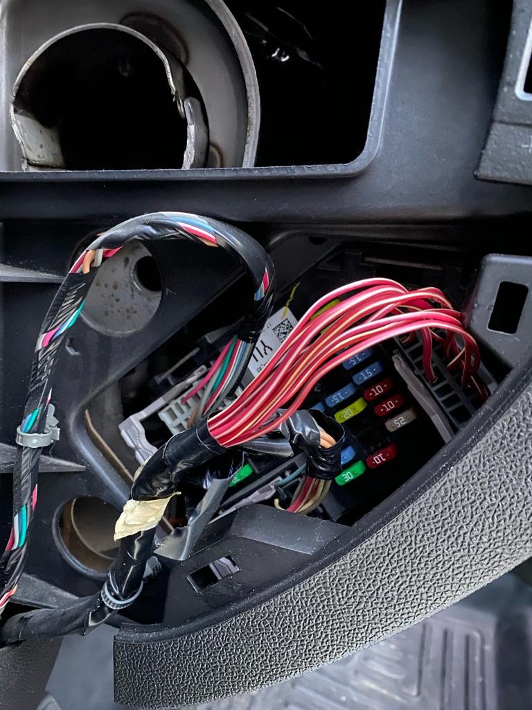

Going to install this tomorrow but wanted to know what I can tap into in the side fuse panel so I can hard wire it. Any suggestions?
if it has a option for 12v hardwire then you can just tape into the footwell kickpanel down by your left foot area, or use a fuse adapter and tap into one in your photo.

Do you want constant power or switched? Switched is easy, right at your rearview mirror.
Recommends constant power. Because there are small fuses attached in the wiring I can’t tap into the mirror and tuck the fuses in the headliner.
You can get all you need, (ground, constant power, accessory power, or RAP) from the upfitter box just to the left of the brake pedal.

Good to know. You by any chance have a pic letting me know which ones to tap into?
