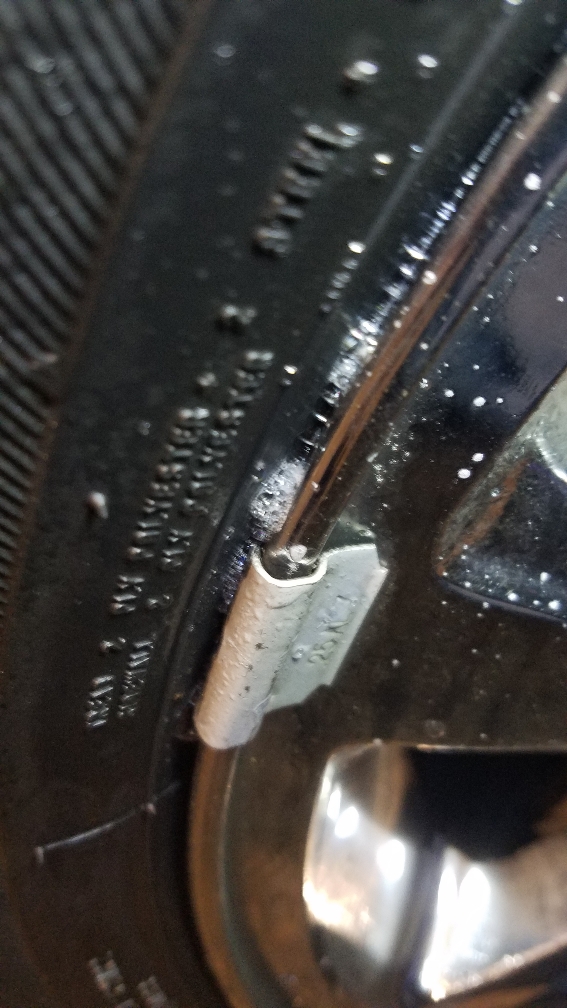

Put air in a tire. It was about 5 psi low and I had to put a couple psi in a couple days ago too.
Sprayed some soap solution around the stem and along the bead and found these bubbles. Looks like a small leak along the bead right where the wheel weight is attached
