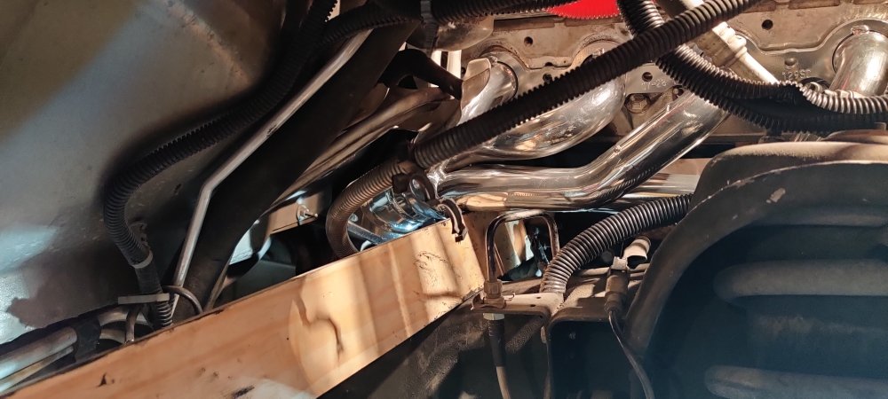

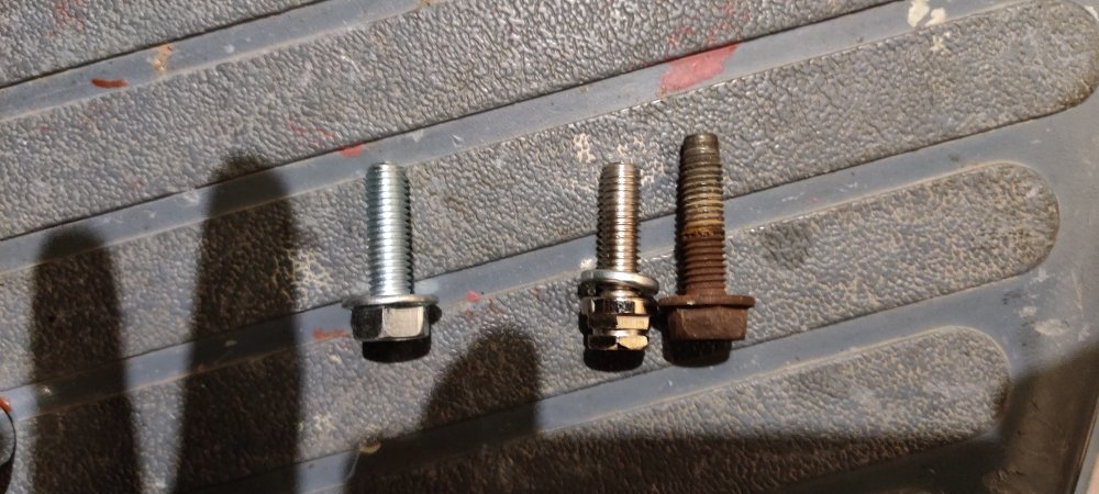

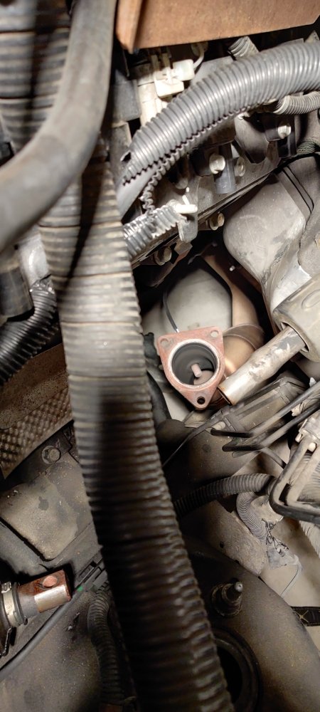

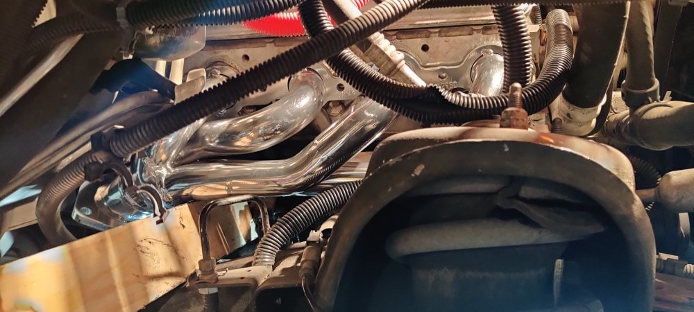

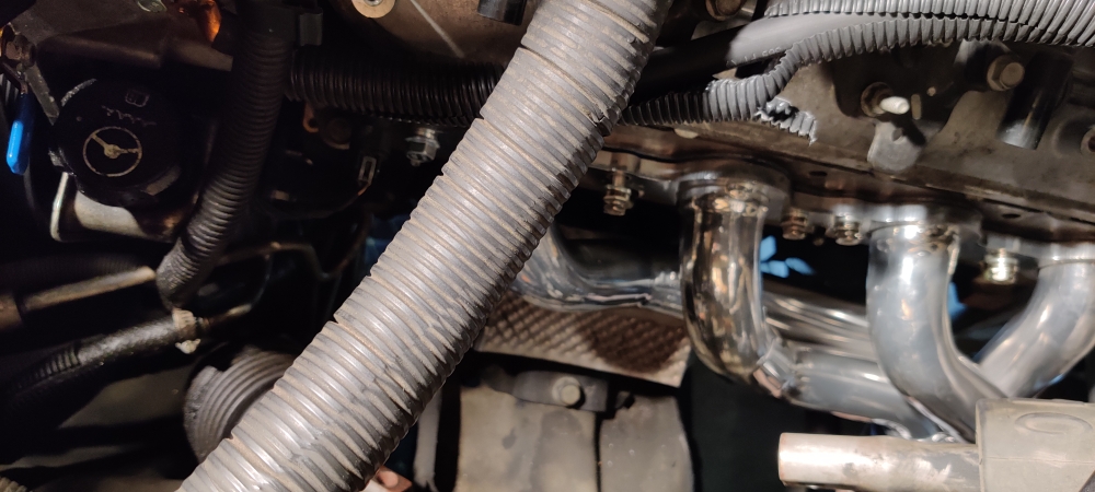

Well, I've been trying to get my shorties installed since last Friday, and I have learned 1 thing. I am too old and out of shape to be crawling on my back on a concrete floor, on my knees for long stretches, and doing things that require I remove pieces from the engine.
I finally got the damned original manifolds of Monday evening. It is Thursday, and I finally got the drivers side header on, only to find that my stage 8 bolts are apparently TO LONG.
@kbuskill, did you have to use washers with your stage 8 bolts?
I added washers, and they still seem too long. I can't get the headers snug to the block. I am open to suggestions...
Problem number 2 is that the passenger side rear bolt is KICKING MY ASS. I cannot get that bolt started to save my life. Ivm too short to reach it from the top, and the space is too small to get my hand in there from the bottom. Frustration does not even begin to describe what I am feeling. Suggestions are welcome here as well.

A couple thoughts:
What is the difference in thickness of your original header plates and the new ones and how does that compare with the difference in the lengths of your bolts? Your new ones look a little shorter in the pictures.
Might try and run a tap into the holes to make sure the threads are clean.
To get the rear passenger bolt on, might try taking the wheel and fender liner off and coming in from the side.

I didn't have any issues with my stage 8 bolts... they do have two different versions for our engines though... the standard length and a longer length... maybe you got the long version by mistake???

Fender liner already off. It seems that the angle is a bit weird on the rear passenger bolt. I cannot get it started. I don't want to cross thread the bolt. What I need is likely an extra set of hands. If I put a bolt in one of the other holes to hold it, then it doesn't exactly line up. It needs to go in first, but I need a 6' friend with long arms to start the bolt from the top, while I hold the header from the bottom.

I just found the part number, and I have the shorter bolts... The OEM manifold is thicker than that Gibson header, but it doesn't look like that much... I'm going to try putting the bolts that shipped with the headers in, I think...

have you tried a flexible shaft socket driver? they look like a wound up spring and bend in any direction, there not good for torquing anything down but are great for getting bolts started in impossible places, or a milwuakee cordless ratchet?
