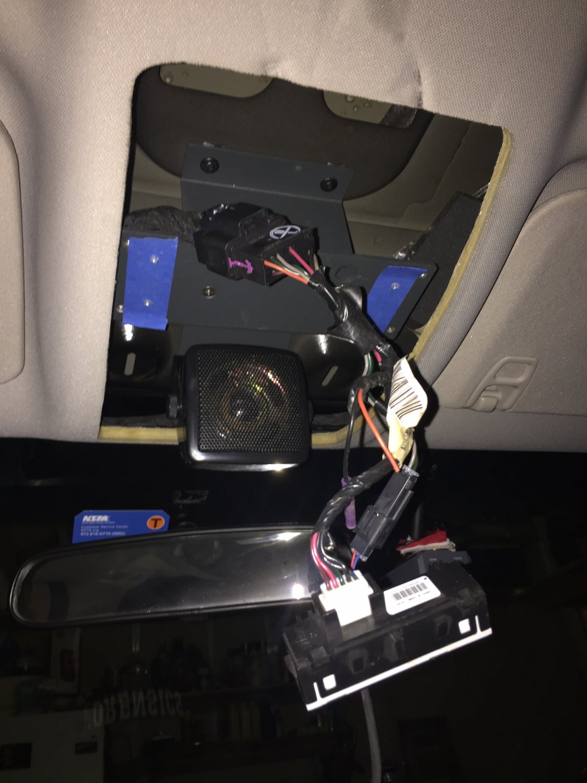

Is the hot lead for the front dome light somewhere in this bundle? I’ve been thinking about trying to install a red/white ticket light, and would like to use the harness if I can tap it.

Yes there is a 12v hot and ground there. Use a multimeter and you can stick it in the rear of the connector. Start by doing a continuity check with body ground to find the ground wire in the harness; probably a black or brown wire. Then lol for a +12V accessory or constant depending on what you want. I found a +12V accessory wire to power my 12v to 5v USB adapter that will automatically power on my dash camera. It’s a nice clean install.
I was hoping it was there. Finding it should be easy.
