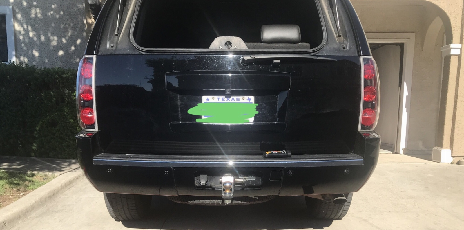

Well, it’s not much... but I got bored and decided I would finally take the badges off the rear hatch before I give him a bath [emoji41] I put this off for years just out of pure laziness but glad I finally followed through.
