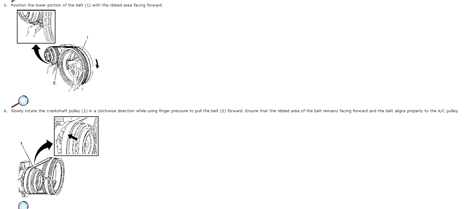

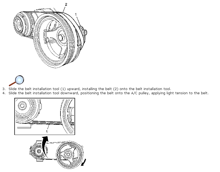

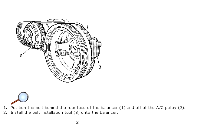

Comes with the tool
The tool is pretty slick.
The instructions that come with the tool are worthless.
One in the FSM are good,

funny it doesn't mention that stupid metal tab that gets in the way, you have to place it just right to get the belt on, getting it off is no problem
at least that's how it is on my 6.2 2012
It took me a few tries before i figured it out.
I even tossed it at one point, and then tried to roll the belt on with out it.
When that was a serious pita, i went back to the tool and figured it out.
