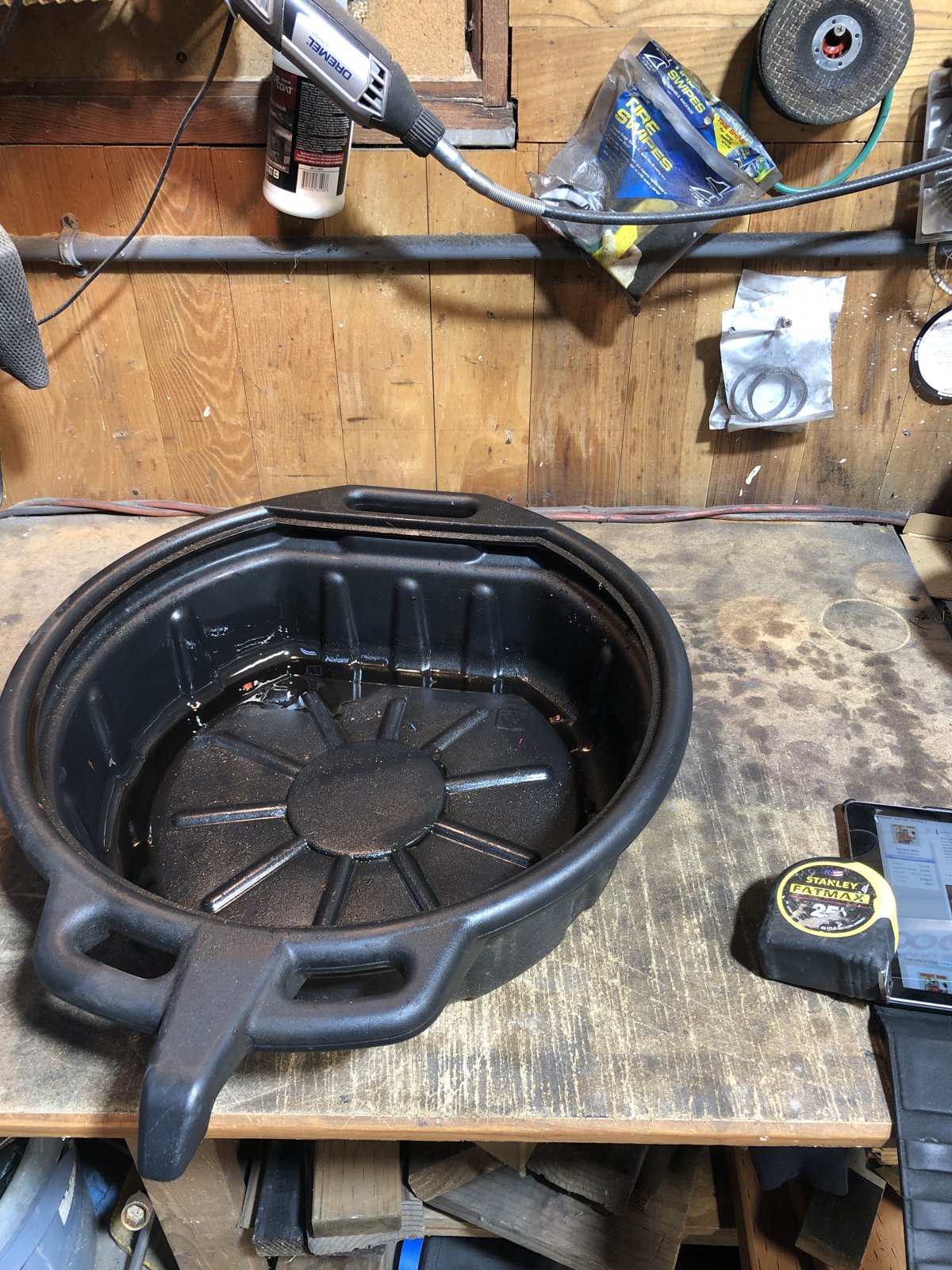

I use a wide one like this, works great.
last time i was around one like that was at my buddy's house, he snapped the plastic nut off the top of the filter for his jeep ( they use that cartridge system ) and we pushed the jeep out of his garage to get the hood all the way open, and i stepped into the pan...in shoes i had bought not even 12 hours earlier. sometimes my luck is the worst

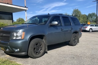

Does anyone know where to get the little clips that hold in the rear Weathertech window visor? One of mine fell off a while back while driving and the visor luckily fell inside... just running the fronts for now.

No but I keep pushing mine up... pretty annoying.....try their website?
Truck looks good

no luck on the website but I think I’ll message customer service. It also looks like they’re offering new stuff that could help protect the rear seating/doors from my dog’s hair and drool...

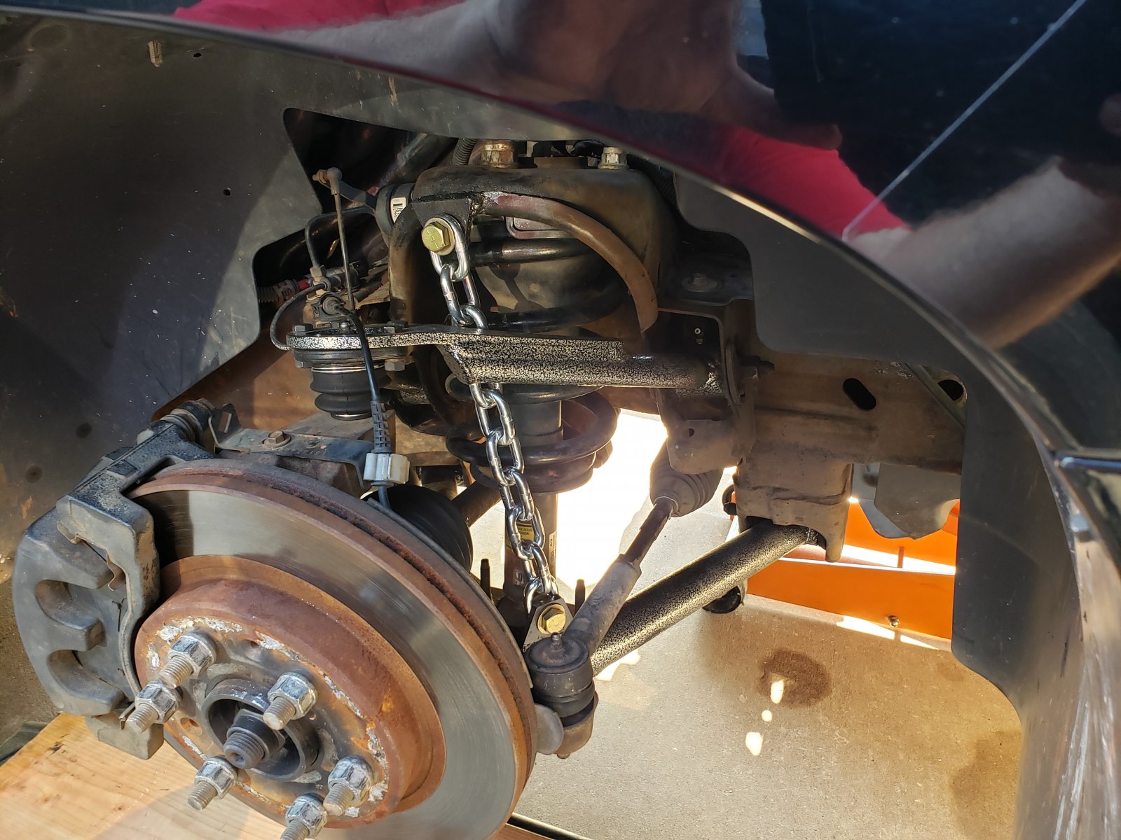

Forgot to post last weekend. Welded up the tabs for the chains. When bolted in there is only 1/4" to 3/8" preload on the strut (yes I will be swapping to a clevis in the future). These plus the rest of the suspension work I picked up .2 in the 60' in ~3,500' higher DA than the previous best.

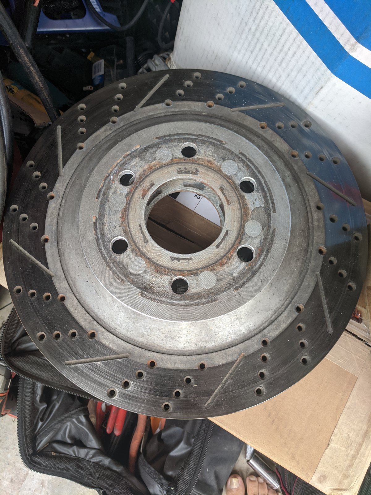

Got these monsters, need to see if I can get them turned before I use them
Pro tip, the old "If I can't warranty it I can't charge you for it". Find an O'Reillys with a brake lathe, tell them that no other shop will do them because they're aftermarket and drilled/slotted and they wouldn't be able to warranty the work. Whether they would end up 1 though under minimum or because they were aftermarlet I have used them, and that excuse, a few times on different rotors and they did them for free.
But keep in mind, you will risk getting small chips on those.

I was going to try car quest first, I don't mind any chips as long as the surface is smooth, picked them up from another member they are not bad but I can feel some light grooves

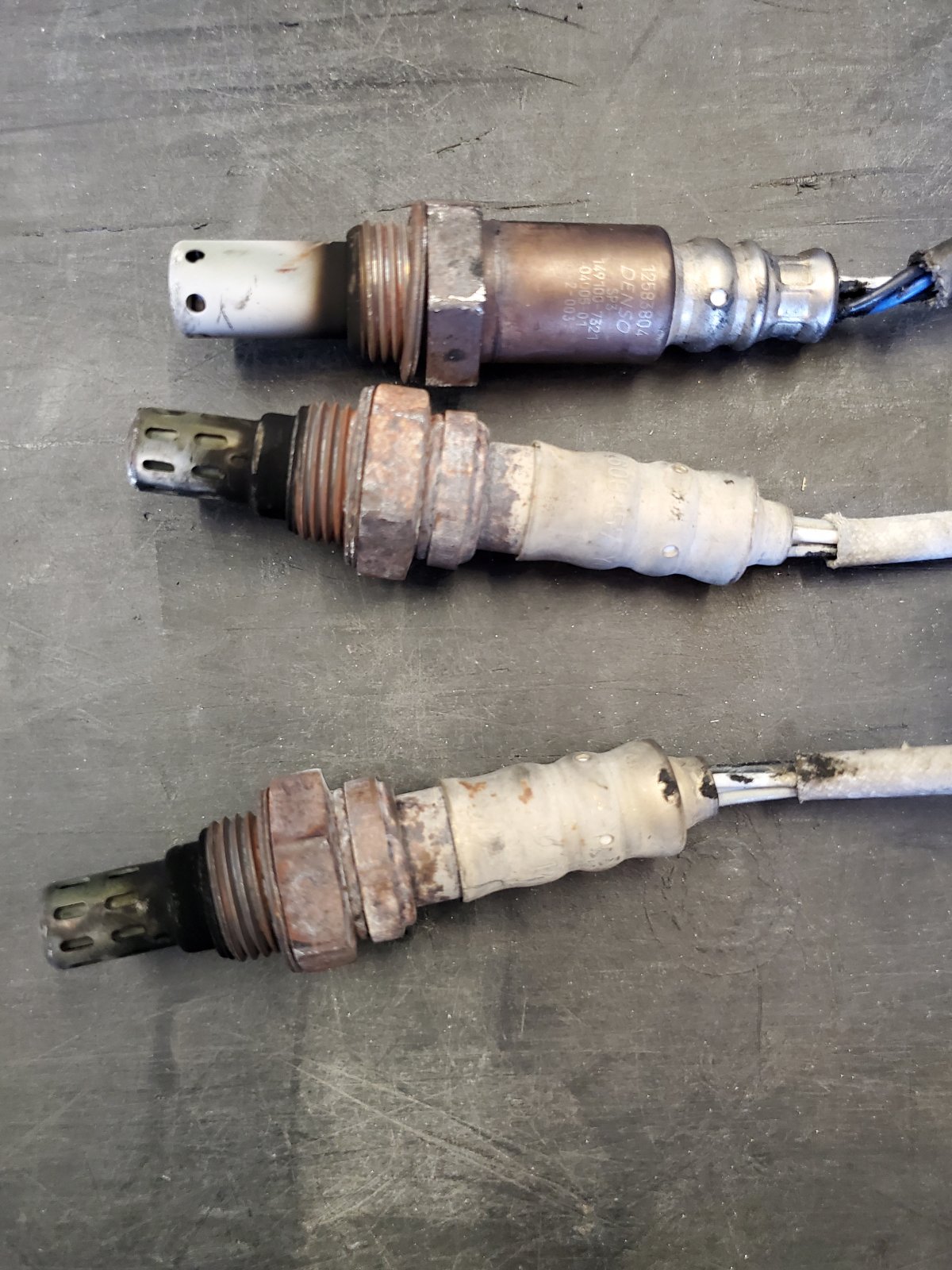

Tried to change all four oxygen sensors because another code was thrown. 3 out of 4 came out easily and went back together beautifully. But the left upstream sensor is combative. I'm reasonably sure the threads are ****** and I will have to weld in a new bung. **** my life.

yeah that sucks

Always gotta be that one ******* in the bunch :mad:

did you try a torch?

I would see if I could find a tap and see if you can clean up the threads when you get it out.
