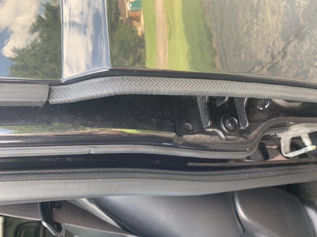

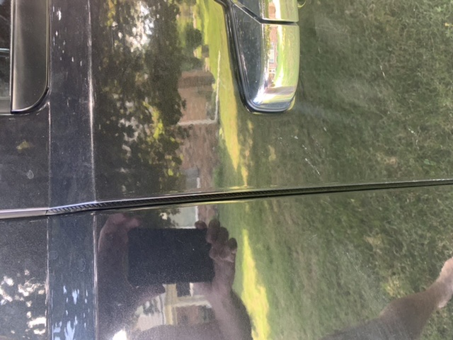

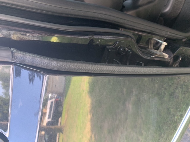

Drivers door.
I butted the weatherstrip up against the upper door portion, worked it in all the way down and cut it just as the door flange disappears. The weatherstrip has a metal strip in it making it hard to cut.

Is there a soft, thicker, rubbery part on that to help seal against the door edge?
Sent from my SM-G930V using Tapatalk
No the weatherstrip is hard rubber. No glue needed. It is noticeably quieter with the additional weatherstrips....
