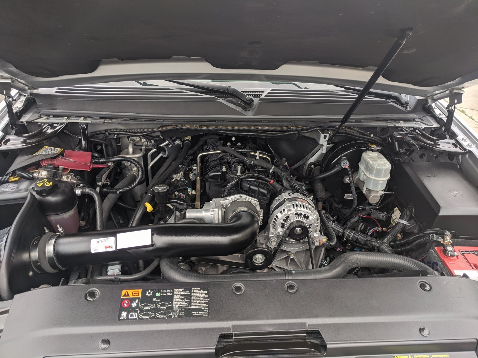

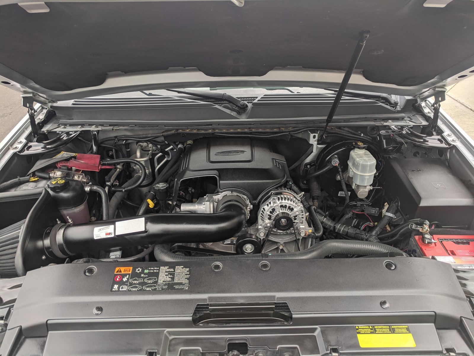

Degreased and pressure washed the engine bay nice enough to eat off of again
30,563
48,043
What is your method and what do you use?
well it really wasn't that dirty because I clean it about twice a year, I took the engine cover off and just sprayed it with a whole can of gunk original and then used the car wash pressure washer with high speed soap and then high speed rinsed it, didn't spray directly in the alternator or ecm and didn't spray directly in the air filter everything else is game.
30,563
48,043
then when I got back to the house I wiped it all down with gunk "shine" which really didn't do shit, don't waste your money I got it just to try it out thinking it would maybe make it all shiny which it it did for about 10 seconds, there is better product out there like ZEP that stuff makes it really shine.

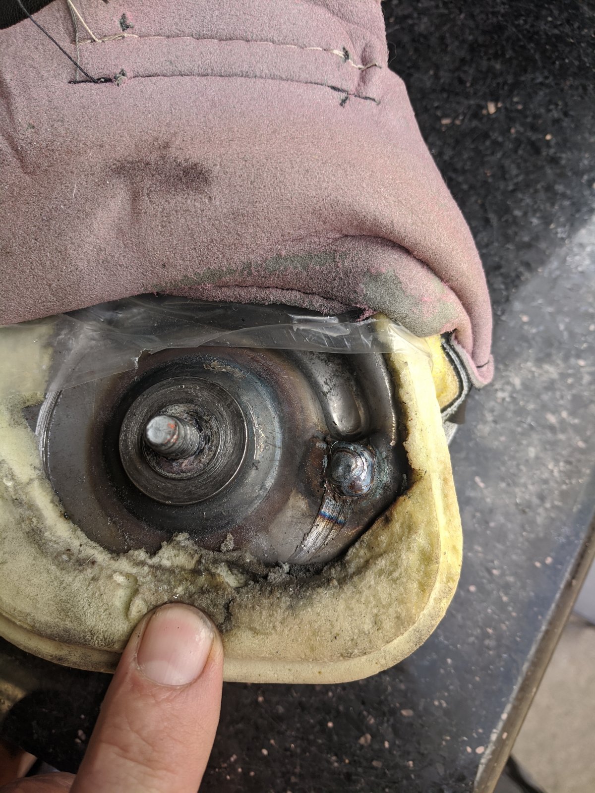

Had the muffler shop put a little bead on the drivers rear seat arm rest, it's a weak spot the arm rest stop wears out and then then it just falls down, should be a permanent fix, previously I used a washer and made the bolt so it would go tighter but the kids keep climbing on it.
