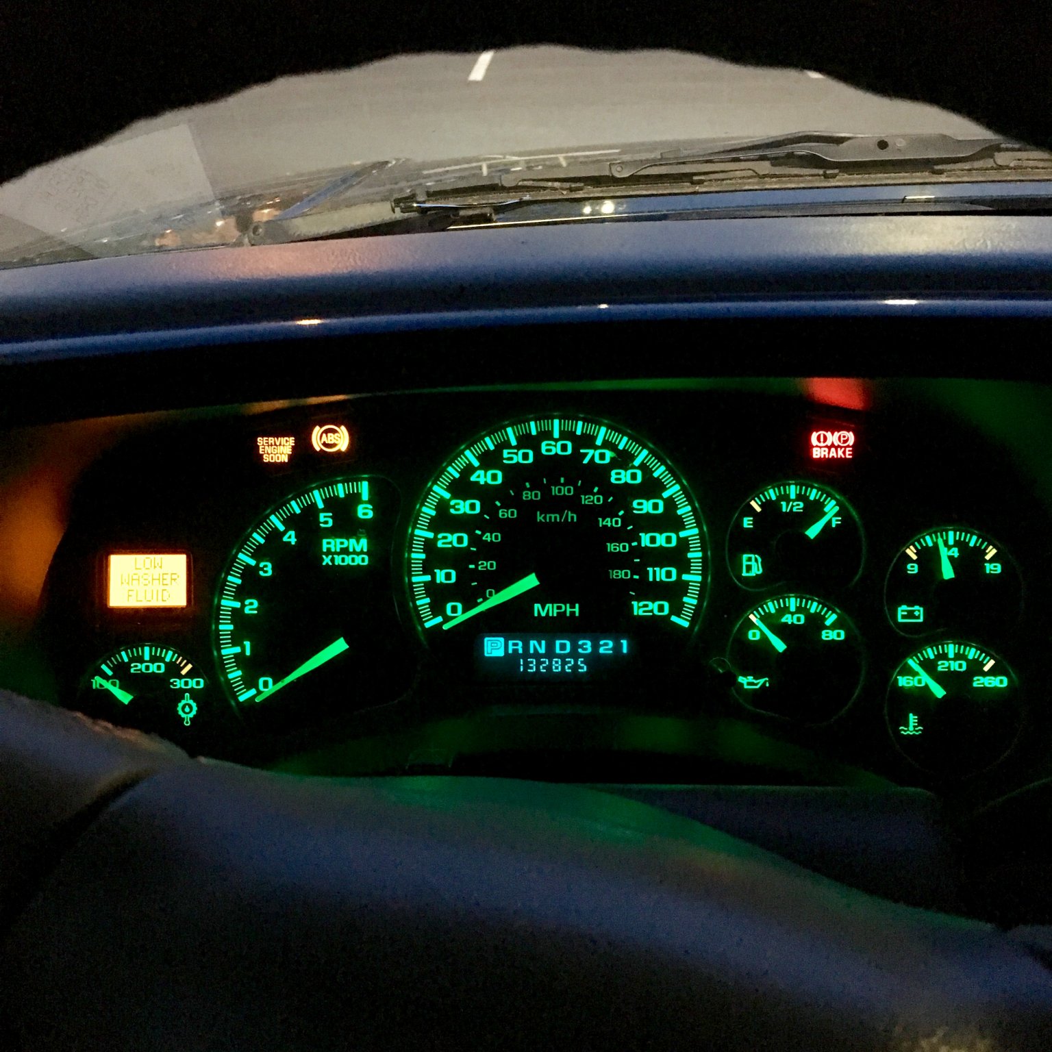

I got some LED's for the gauge cluster. Like the look, but I'm eventually going to get white ones. I plugged in my 6K map lights and it had the same factory blue and the needles were white. I had just the right amount left so I put them in my turd-gen
