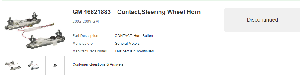

Is this the one you need? Matched it up to my '04 but I'm not sure if your Yukon is the same.
Thank you Sir!
Still having trouble finding one available anywhere though.. guess I’ll get the Dorman from the jungle website.. supposed to be here tomorrow. I’ll keep an eye out for an OEM version, just in case..

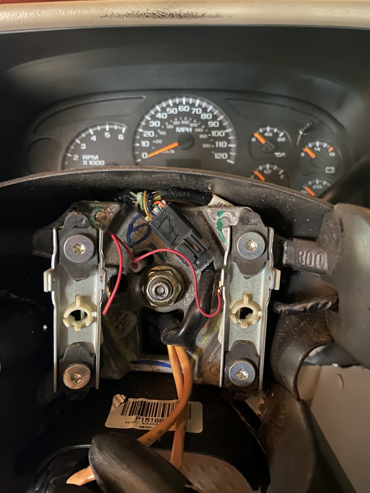

I'm not familiar with how things look behind the airbag, but is there any chance you could freshen up the contacts with steel wool or a steel brush? Maybe there's some corrosion that's built up over time?

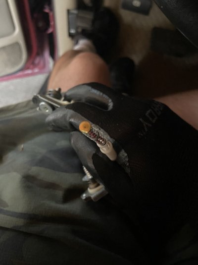

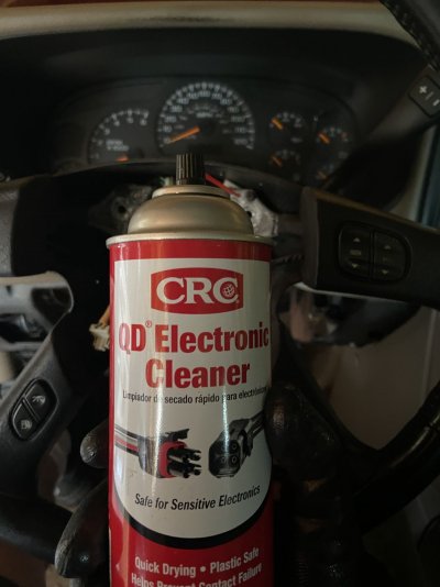

Fixed it.. apparently, the switch was bad. Looked very clean, but used some Electronic cleaner just because.. and a dab of dielectric grease.
