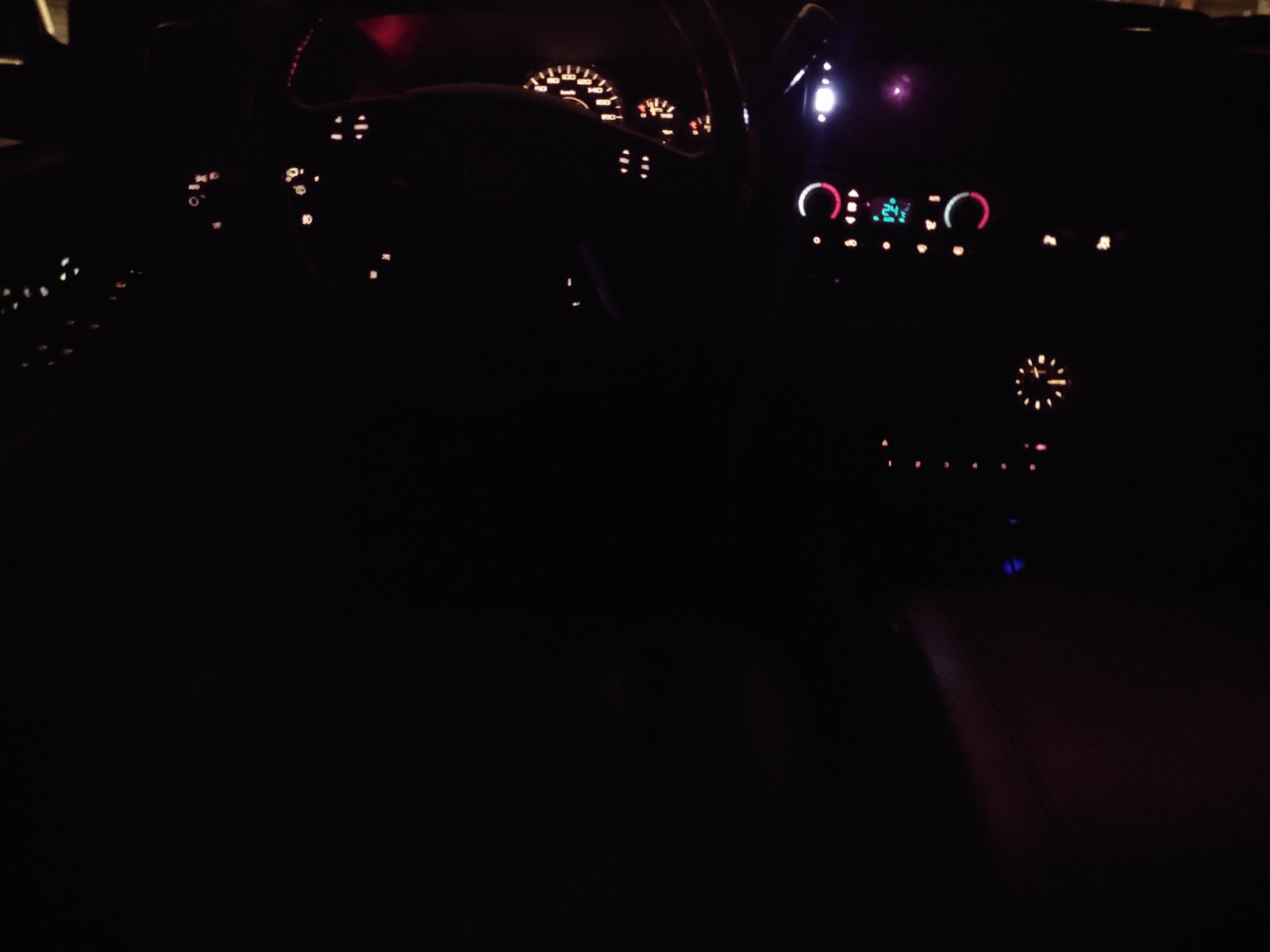

That's how mine look.. Difficult to make a photo without shaking with so few light....
First with interior light on and the other with interior light off....
