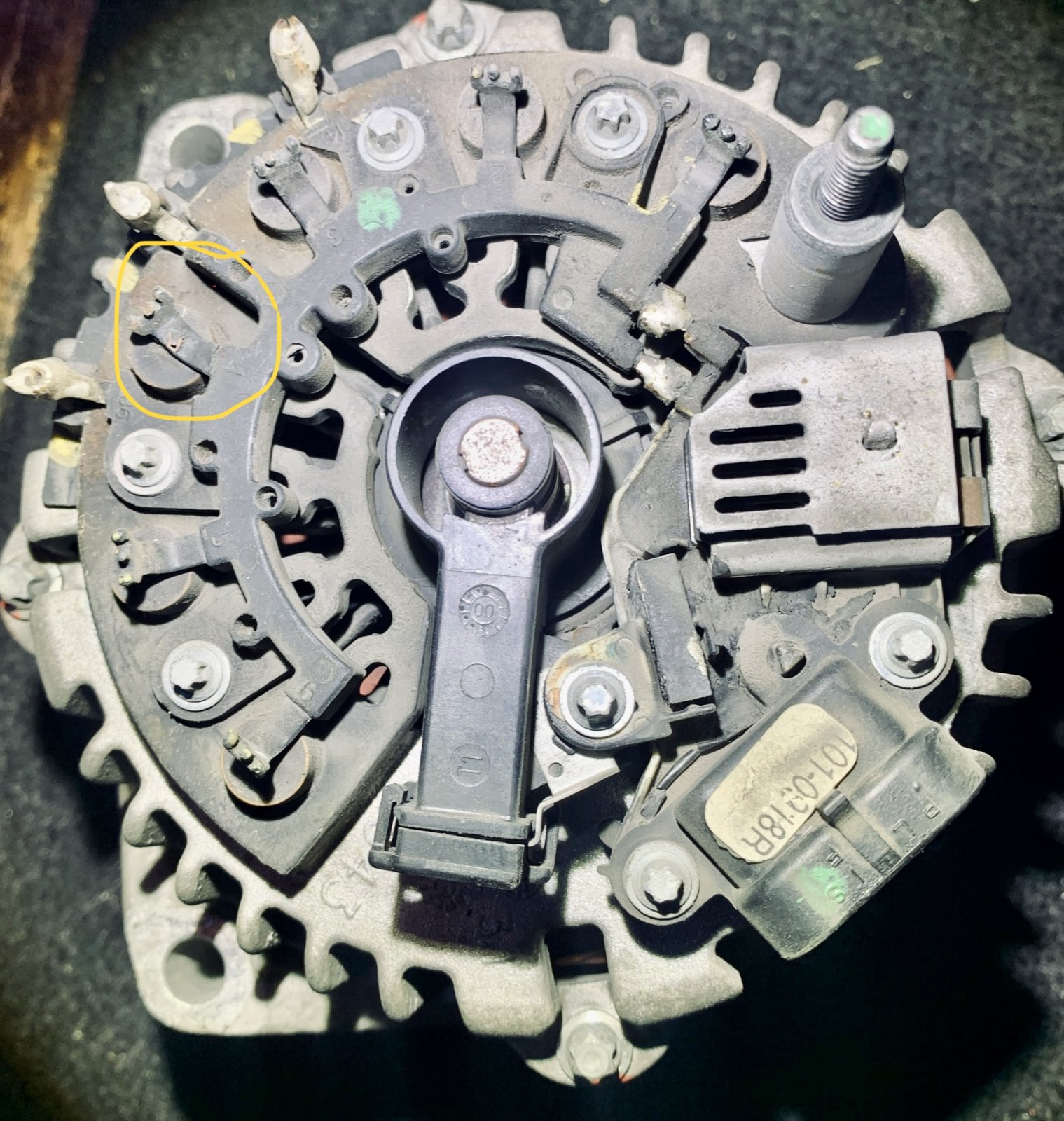

Well the upgrade alternator I got from Pick a Part last year took a **** on me. I've been seeing my Voltage gauge bounce lately and my scanner was reading spikes over 15 volts the last few days. I already assumed bad Voltage Regulator, but I removed the plastic end cap to look and found a part of the rectifier broken. I think I may do a rebuild kit on it in my spare time. Never done one before but I'm pretty sure I can tackle it
New one I had to buy:
Old one with cap removed (broken piece inside yellow circle)

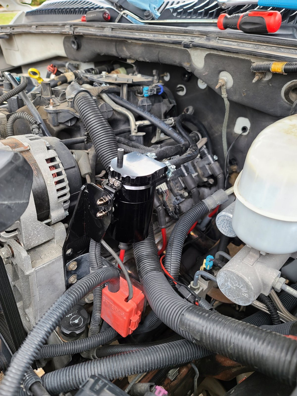

Truck has developed a high pitch whistling which I'm assuming may be coming from a loose end. I'm also noticing the hoses have collapse to almost flat! Any insight on this
Kind looks like of like vacuum pulling opposite directions on each of the two tubes on your catch can.
Is there any remote chance one of the hoses is connected to a fitting where the flow is the opposite way?
Almost like the flow is pulling away from your can on both lines instead of following a one-way direction of flow through the can.
The whistle could be air sneaking in at the connection on one of you puckered hoses...
Maybe there is only two places to attache those hoses and they actually are in the right place. Just trying to come up with possible explanations for why your hoses flatten and the new whistling sound.
Good luck!
Thanks for your insight. The connection at valve cover goes to IN port on can and the OUT port is going to the upper intake port. I used low pressure fuel line for the hose runs. I may go back with trans/power steering hose which tends to be a bit more robust/stiffer to help maintain hose shape. I will take a peak when o get home from work today. Left it st home and jumped in the other truck
OK. I figured there probably weren't too many places to have connections in the wrong place. But I know I can surprise myself on my own projects sometimes, so I had to ask to be sure...

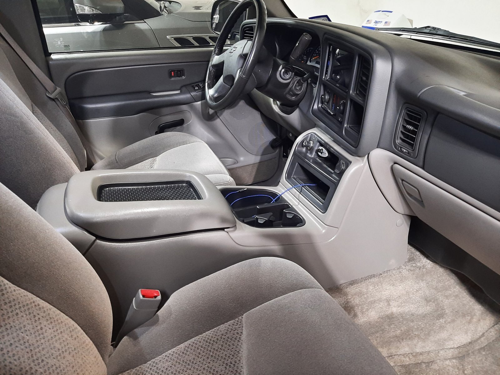

Finally got around to posting these pics. I installed a center console and escalade roof racks on my burban.
