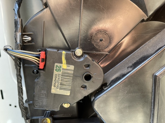

After the battery died front/rear actuators we’re all out of wack. Tried the calibration trick and it fixed all front actuators along with one of the rear actuators. The temperature one was stubborn and would not reset. Ended up uninstalling it , opened it up and reset to the middle position. I initially thought the gears were stripped. Pulled the HVAC fuse and went thru the calibration process. It finally reset.
Did you set the temp to the middle on the controls before doing the reset?
