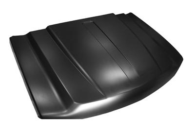

That looks exactly like my non-HD cowl hood but I just looked and they list this one for the 2500 HD Silverado but it sure looks like it's for a Denali/ GMC since it has the angles above the headlights. Sure wish I'd seen this one before I bought mine.https://www.summitracing.com/parts/...r/2005/make/chevrolet/model/silverado-2500-hd
That is for a 2500 Silverado , but 03-06 front.
