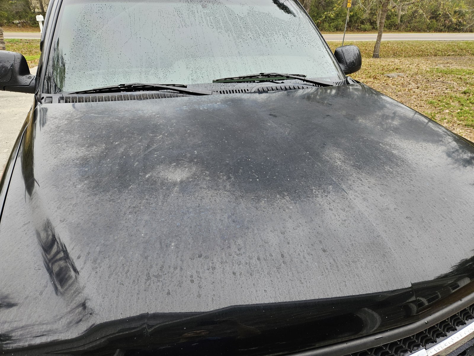

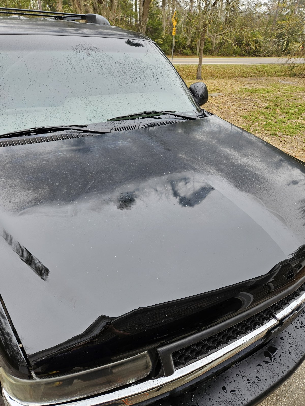

This year I’m celebrating 20 years of ownership. I bought it 1/31/2006. I’m doing an aesthetic refresh of the truck.
Week before last, I dropped it off at a paintless dent repair shop and they did a great job.
Yesterday I picked it up from a local paint and body shop where I had the hood repainted. It looks amazing!
Today I installed new OEM rear appliqués to replace the faded and worn originals. I also installed new front and rear Dorman wiper arms to replace the originals.
In 60-90 days once the hood paint is fully cured, the final step will be having a detail shop remove the side trim moldings, polish the truck, and ceramic coat everything except the hood which will get PPF applied.

Whats that color? Looks midnight blue

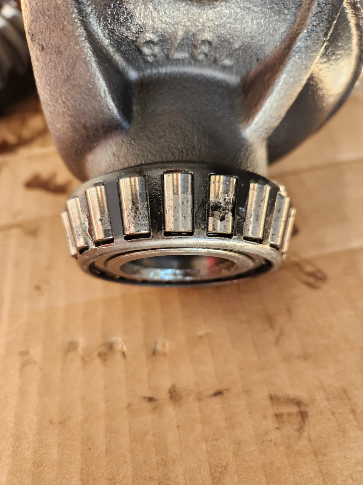

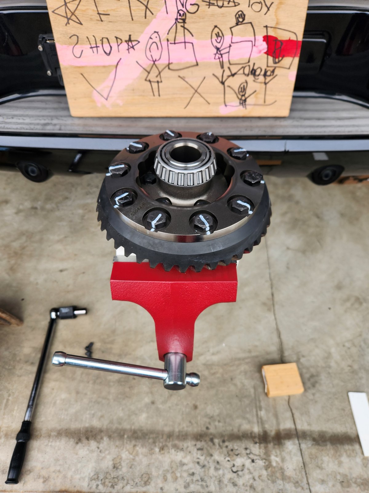

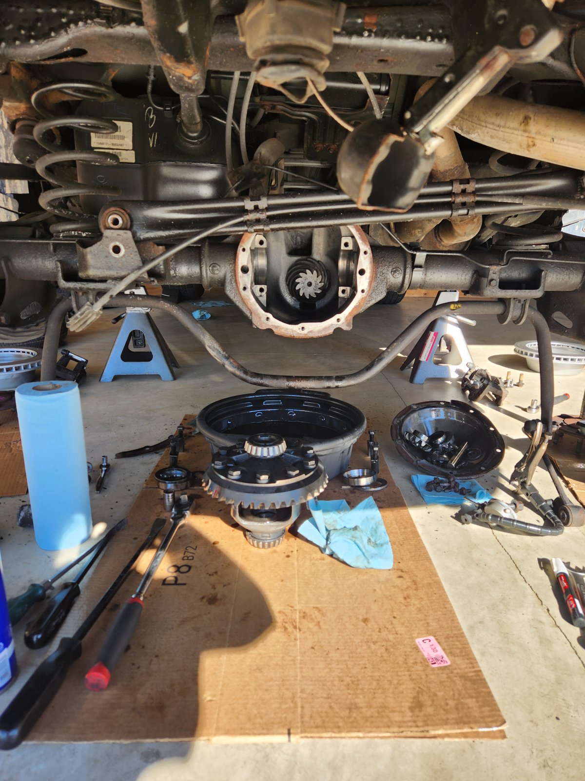

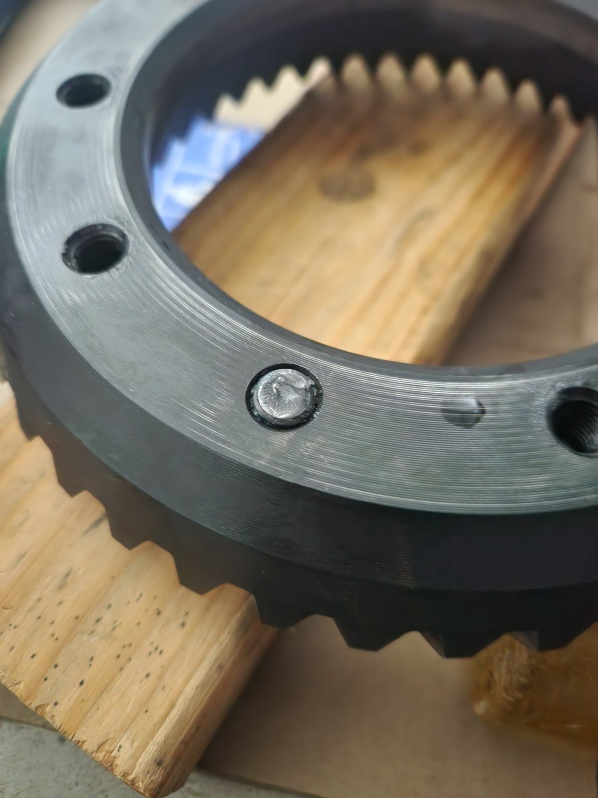

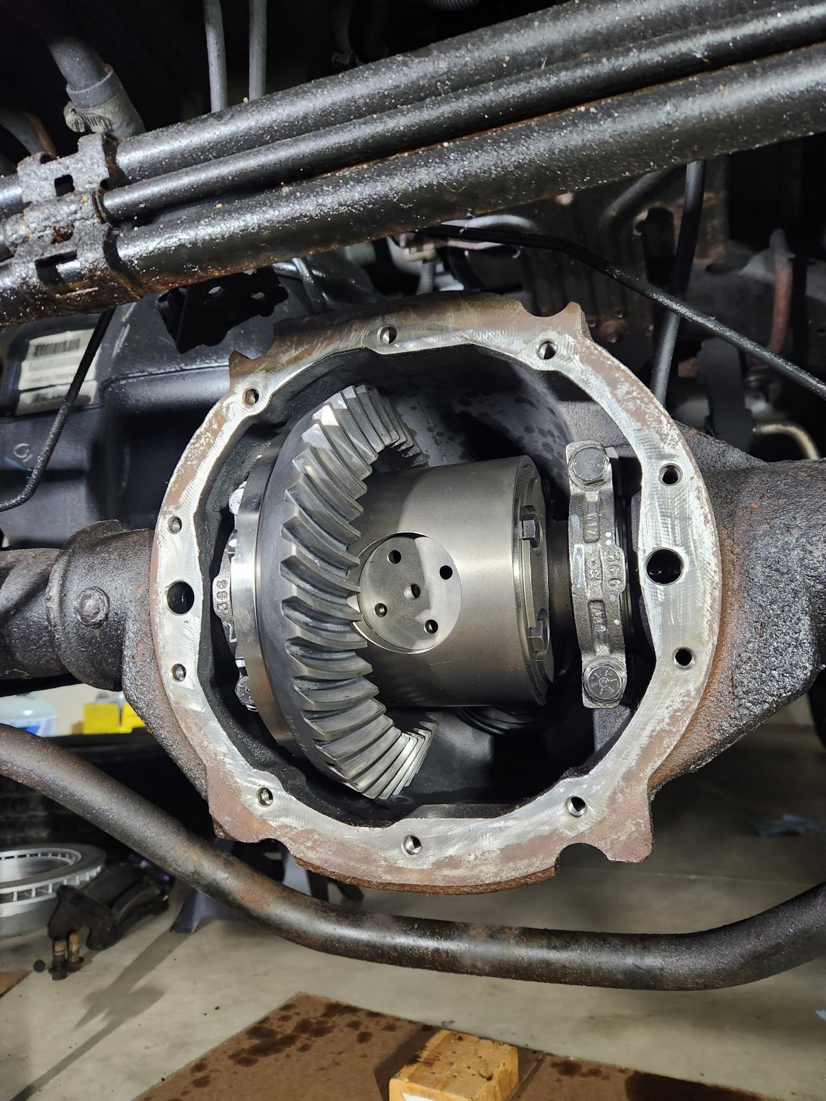

Installed a truetrac in my escalade. This job turned into a bit of a headache for various reasons, but i was able to get it resolved.
I have built probably a 1000 diffs over the years and NEVER had this happen. I was able to get it out super easy, but it still is a kick in the nuts. I was doing my final torque pass and on the last bolt i was thinking, man this bolt feels weird, then snap.
come to find out it looks like my torque wrench went bad and i was significantly over torquing the bolts.
Got new bolts and got that part resolved. I was able to get my backlash to .0045" and tossed it all back together before running out of daylight. Still need to toss the brakes on and button up the cover. But the hard part is done at this point.

I love that box.
