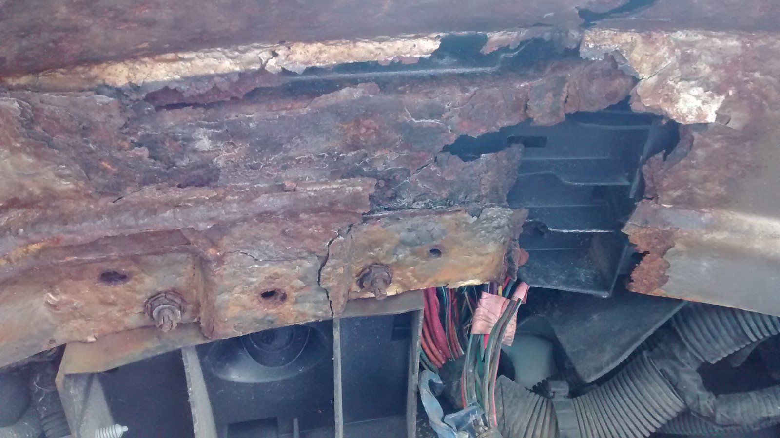

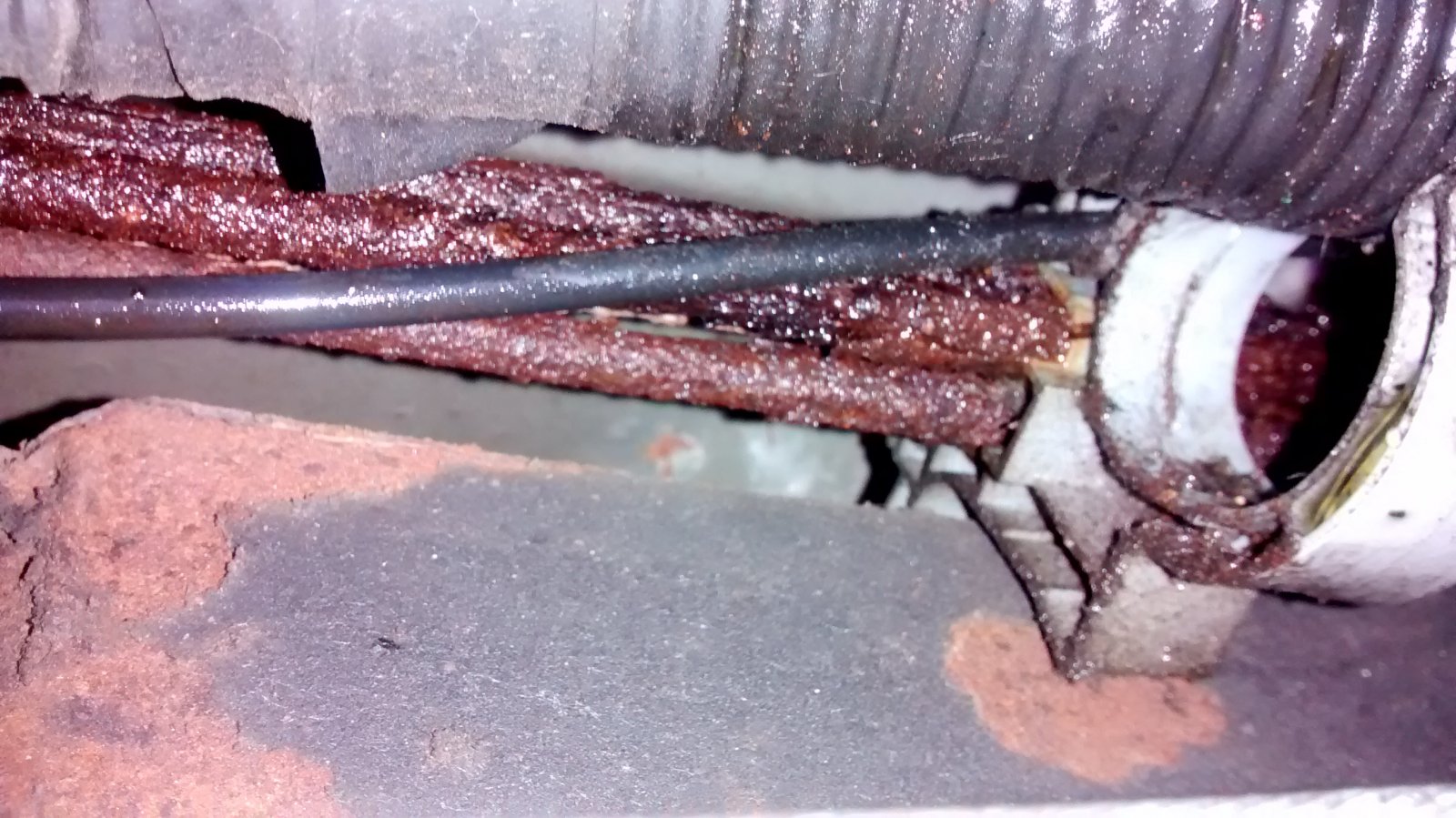

Well, SOAB ! Another flippin' design flaw !
Why the hell didn't GM have their wheelwell liners cover the entire wheelwell.
Found this BS while fixing another design flaw -
Routing the brake lines along the outside of the frame - brilliant idea !

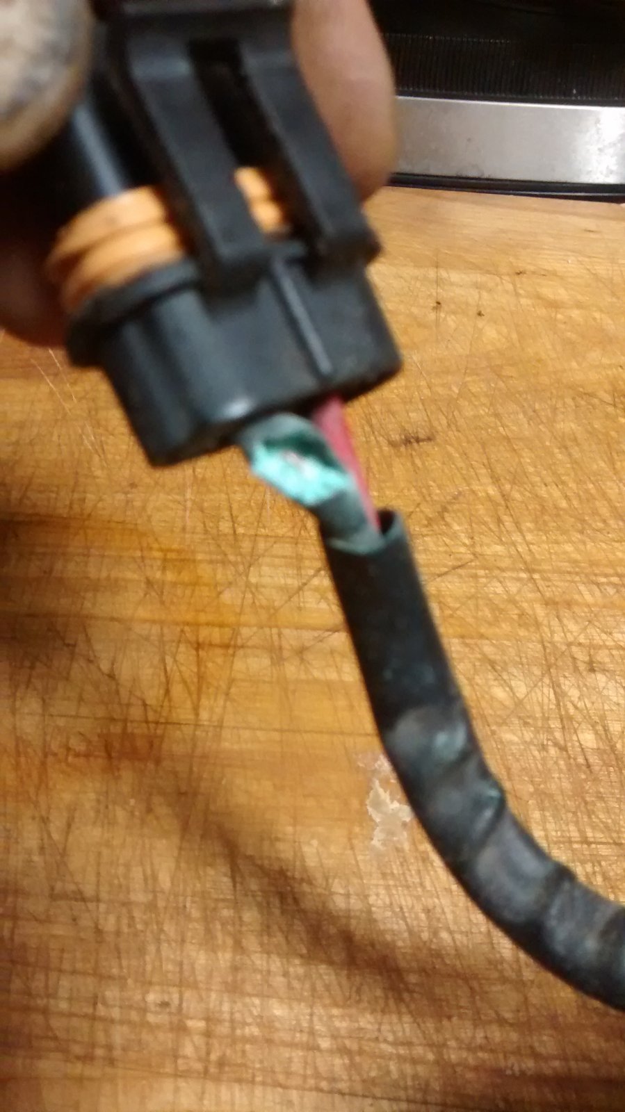

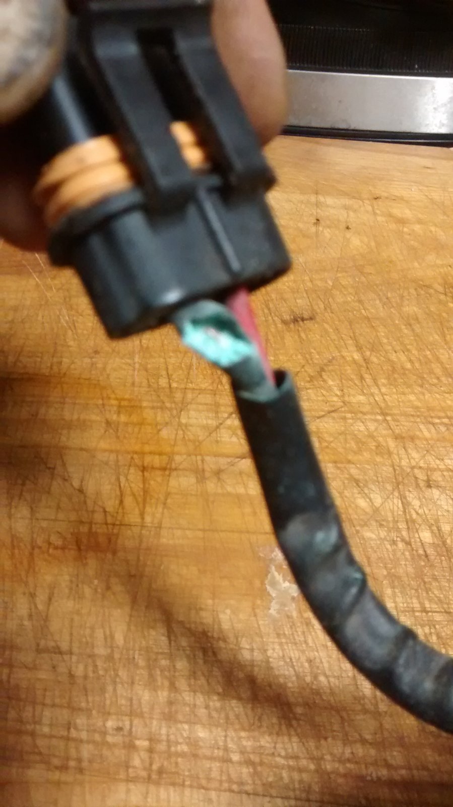

While replacing the brake lines ^^^^^^, I thought I would also remove and resolder the ABS circuit board. I have the common problem of the ABS and BRAKE warnings on my cluster.
Now I have a decision to make :
It's a lousy photo, but the negative connector is almost completely corroded away.
Was this the cause of my ABS problem, or is it the circuit board ? I'd hate to resolder the board if it is still good - and risk making it bad in the process.
I do have another pump unit but the #s are different. I think I'll try that first, and get some stainless hardware to make it easier to remove the module if the problem remains.
Typical - a 1-day project becomes a 2/3-day adventure.
Now I have a decision to make : View attachment 464625
im sure you can buy a new pig tail for that. i found a guy some time back on e bay that will make what ever you need if you dont see it listed.

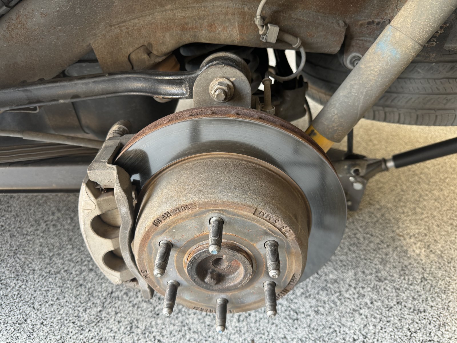

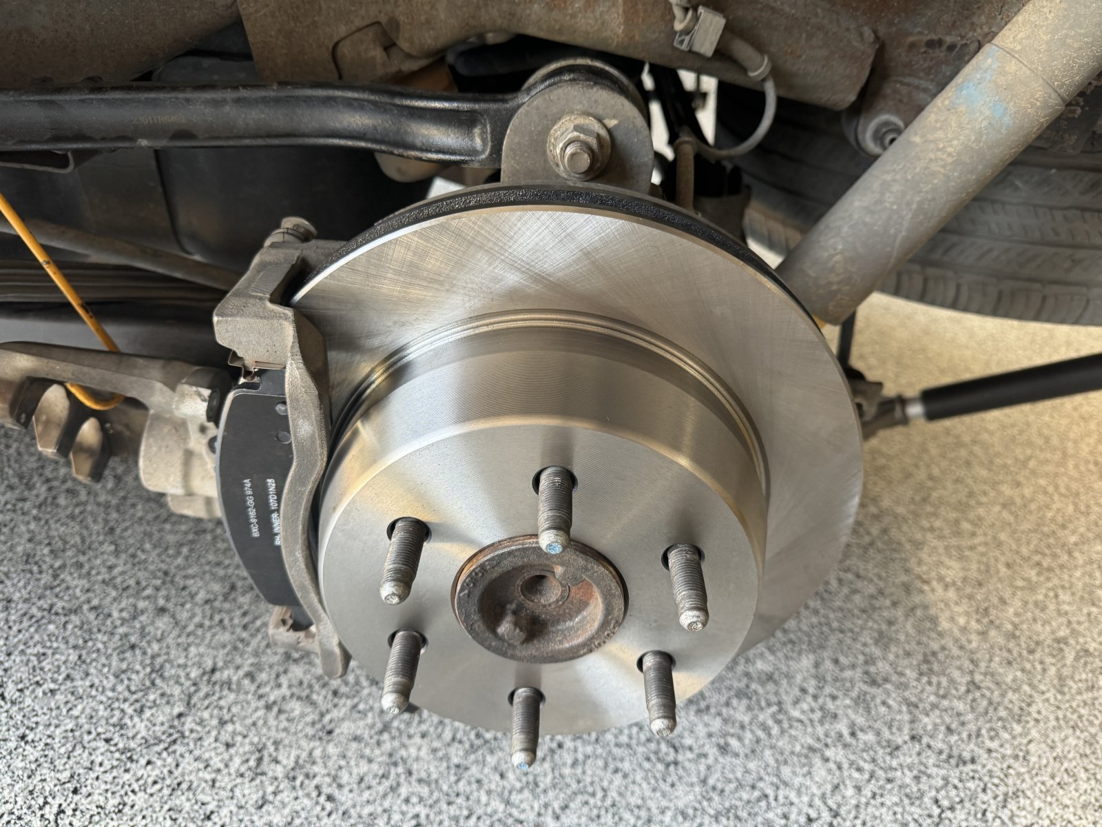

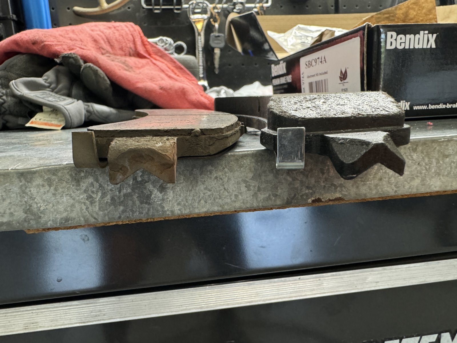

Today I replaced my rear brake rotors and pads. I think these had somewhere in the ballpark of 165,000 miles on them. For some reason my maintenance log doesn't mention rear brake replacement but I know I've done it, and I want to say it was done when the truck hit around 120,000 miles. Based on the old vs. new pad comparison pic, I definitely got my money's worth!
I'm curious if you saw minimum thickness specs on the new rotor. I see them on the face of the old rotor (at least the disc spec) but did they hide them elsewhere on the new one?
You know I didn’t pay attention, but they may be on the inside of the drum. These were AC Delco silver rotors. They seem to have good feedback on Amazon so hopefully they last quite a while.

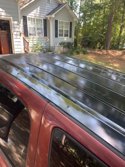

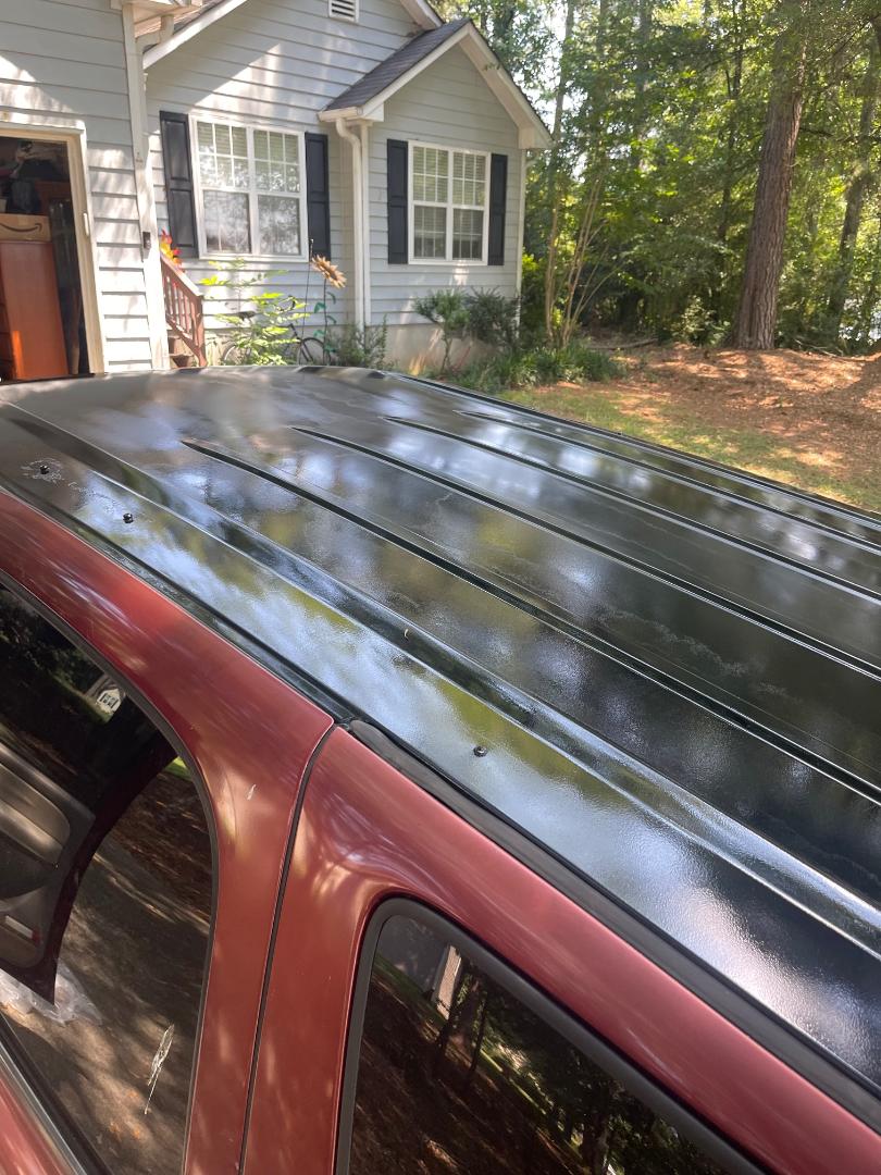

Have this in the "Exterior" section but thought I would put it here since I see a lot of hoods and roofs on the Tahoe's and Yukon's faded. I sanded my roof and sprayed a couple of coats of the Gloss black Rust-0leum in the Turbo can. Came out alright for a temporary driveway job. My hood was the same way but found a nice one in the junkyard a while back for $200.

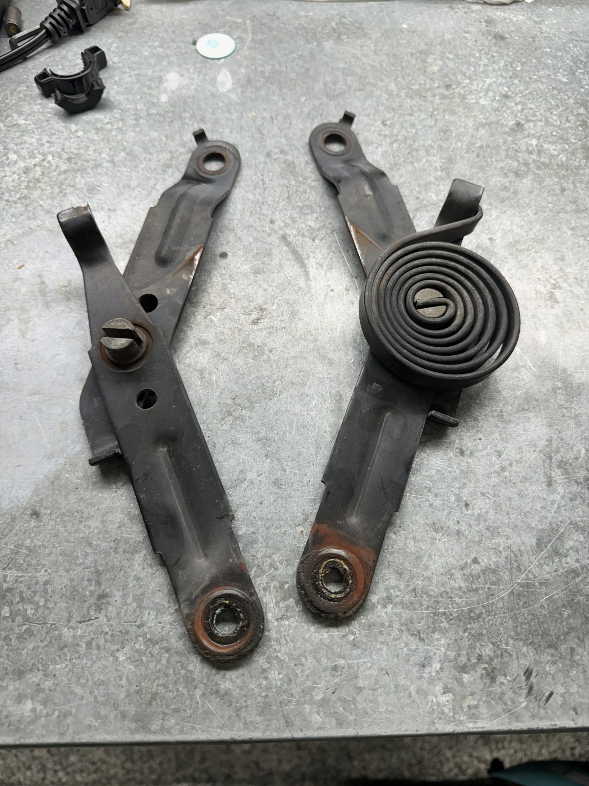

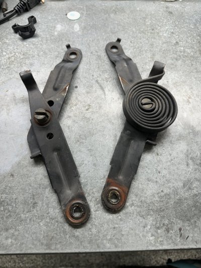

Craziest thing. When I was doing my brakes last weekend, I had my hood up and as I’m laying under the truck, I hear a metallic clang and then the hood slams. One of the springs broke or popped off of my driver side hood hinge. I never did find the spring…
33,199
51,438
I'd hate to be on the receiving end of that spring--whatever it hit.
