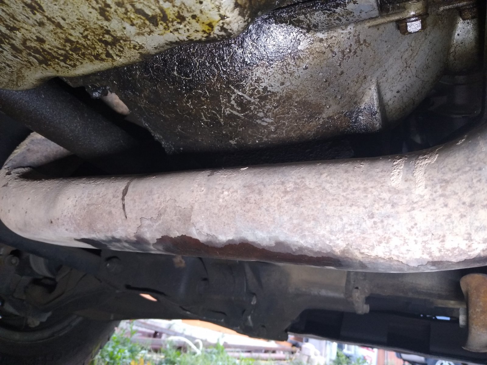

I'm used to 70s/80s trucks and I've seen heavy seepage, this is really small and not even creating a loss. The oil is full and clear after 4000 miles and there aren't any drops on the ground. This guy that saw it yesterday was just unrealistic.
I think the Yukon will find a deserving owner just the way it is. It is a highly original vehicle that was owned by an Air Force base for the first 20 years or so.
yours looks wayyy better than mine, and I wouldn't even consider mine leaking

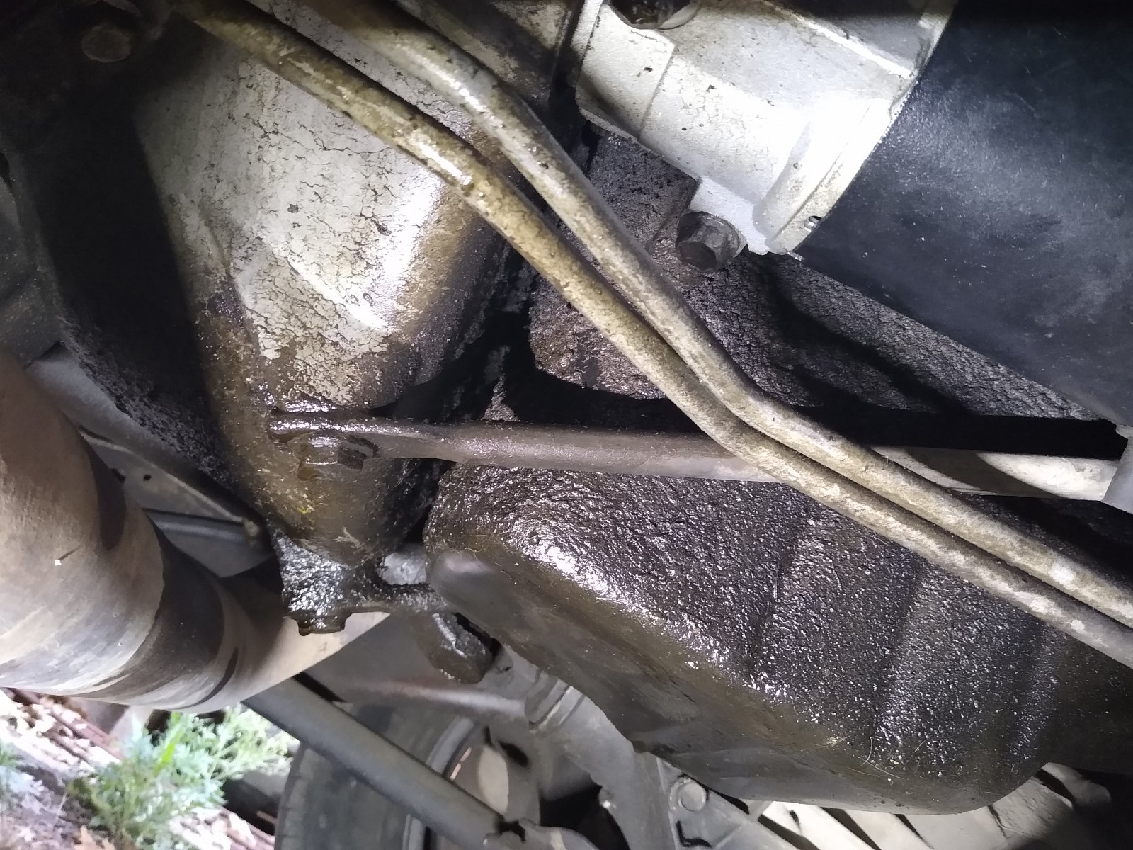

Yeah, that guy was DEFINETELY being unreasonable. Here's what my 2000 OBS K3500 looks. Yuck!
