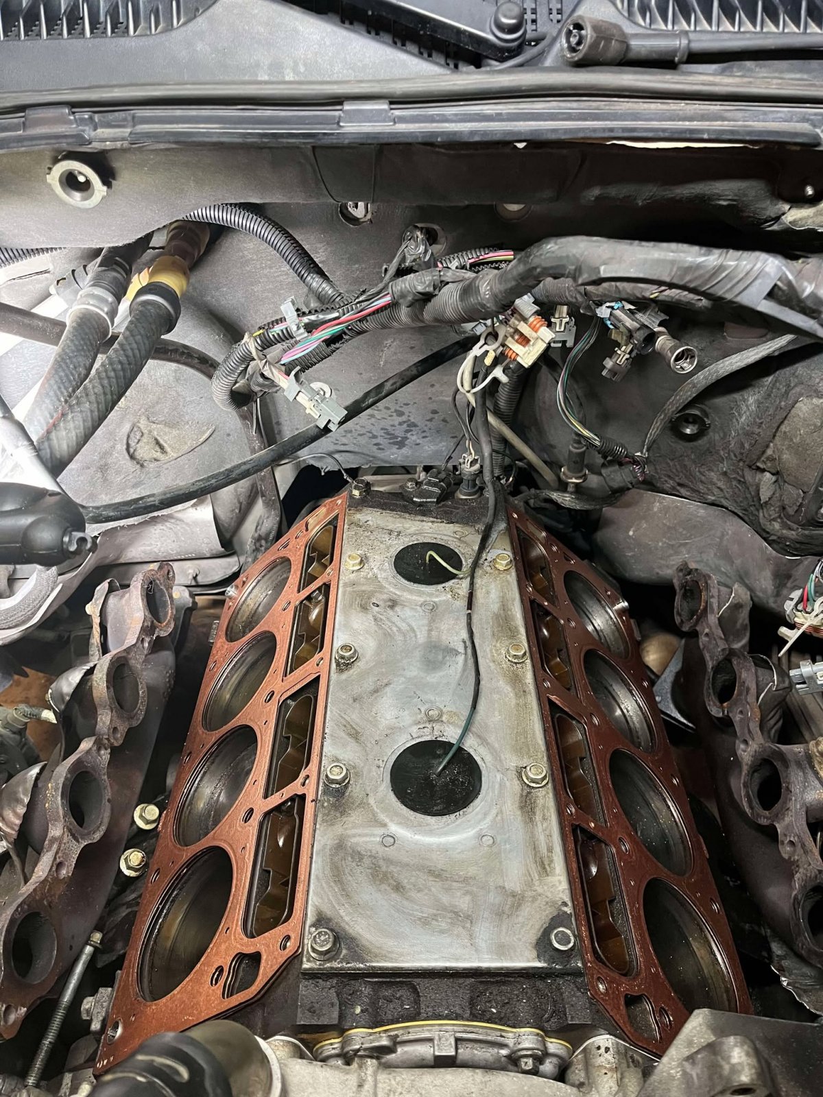

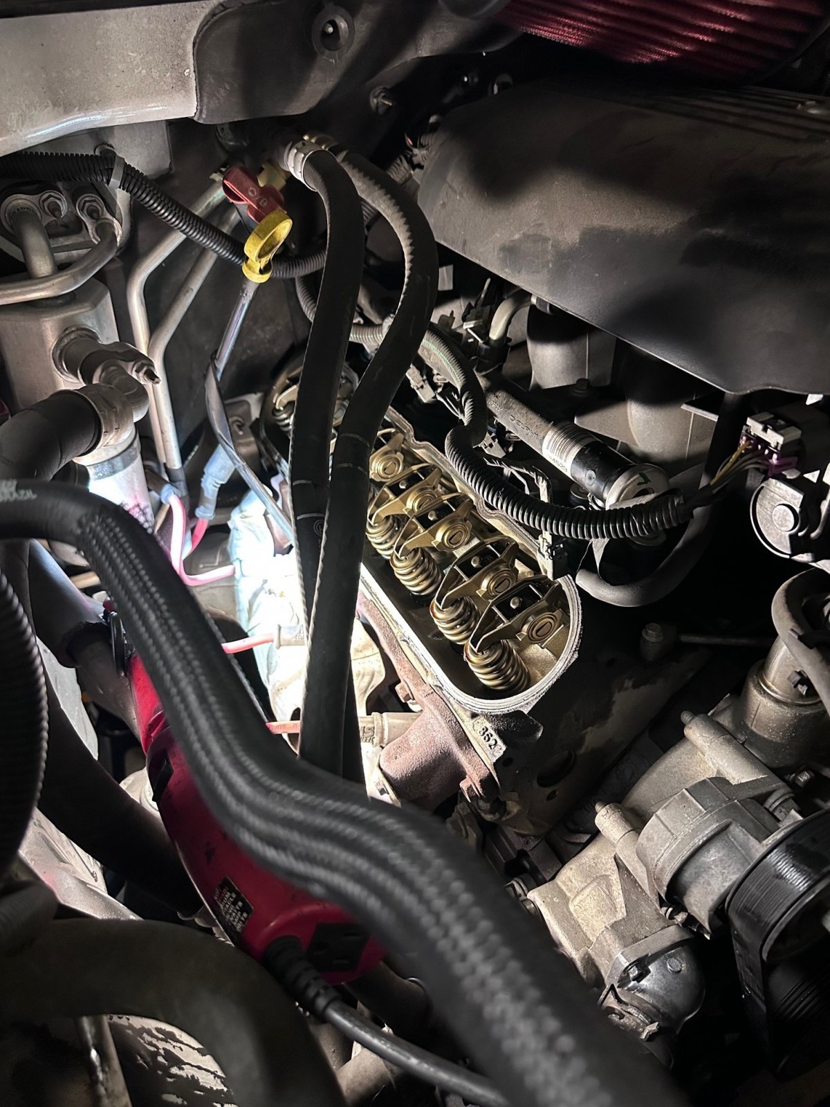

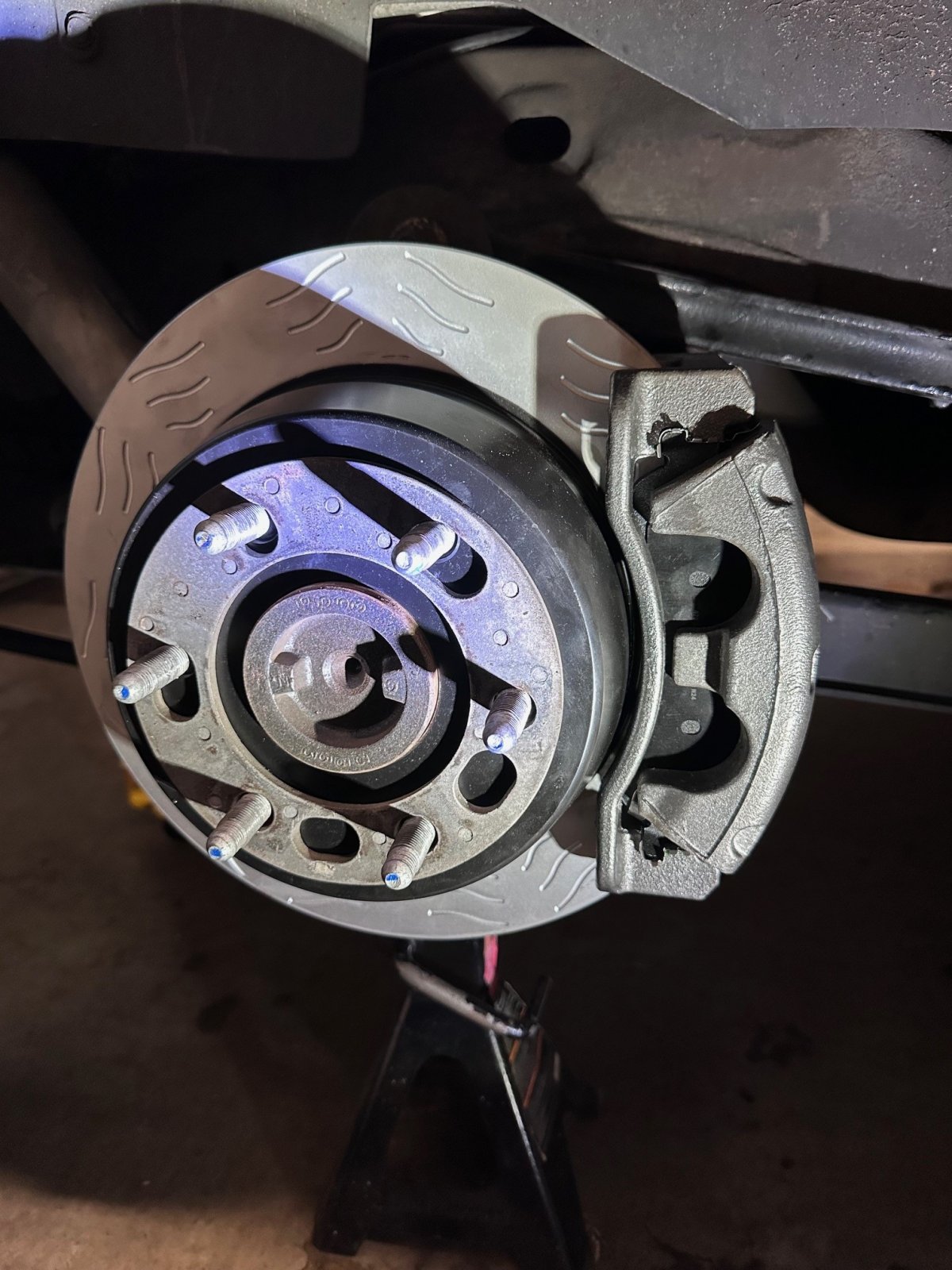

Hope everyone had a great Christmas! Been kinda busy and haven't posted much, but have done a lot to the Tahoe. Finally bit the bullet and purchased a Blackbear tune, front and rear pads and rotors, steering box (didn't fix the inch of play in steering wheel). Along with a t-stat and coolant temp sensor yesterday. It was weird timing that the fans seem to all of the sudden be blasting away after the tune. But once I sent them a follow up log (all data was good). They suggested it could be a t-stat. Then I thought, since I am already working in the area, let's do the valve cover gaskets since they were failing. Of course, my wife's Tahoe didn't have the petcock valve, so I had to remove bottom hose. Fans aren't running now, yes! Even have cold and heat coming from passenger side vents for now. Another item on the list is the blend motor behind vent...

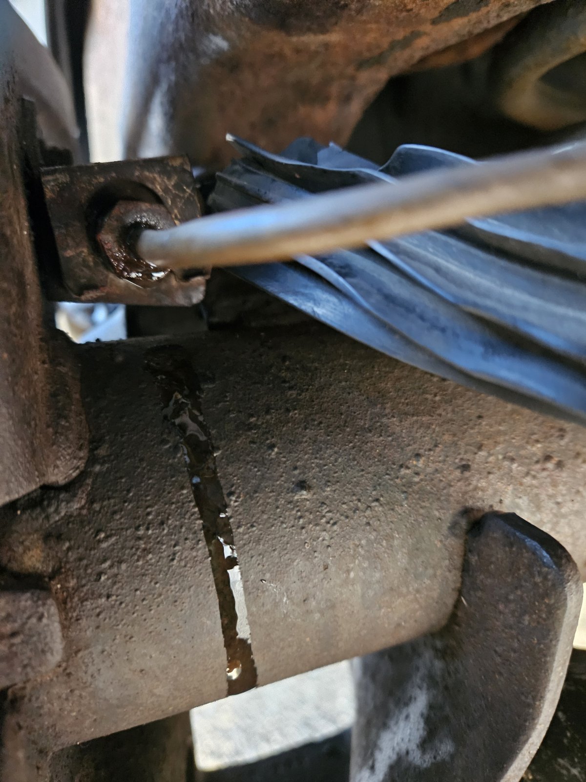

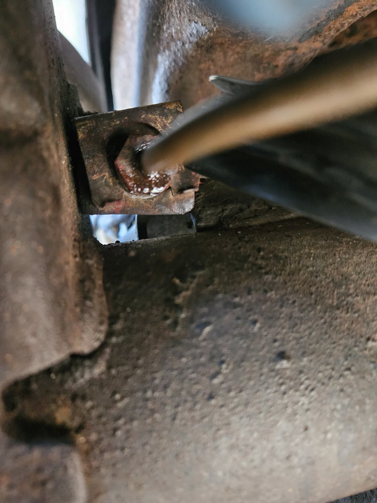

Im not sure if all the lines were replaced--I've owned it since 2012--the rears were definitely replaced as I blew them out slamming on the brakes once.
There's no drips of brake fluid under the truck. Only my rear ds.20241207_152732.jpg20241207_152604.jpg
Solid advice though. Thanks.
There's no drips of brake fluid under the truck. Only my rear ds.View attachment 447339View attachment 447340
I just replaced mine. HIHGLY recommend Classic Tube steel braided hose kit. It wasn't too much more than OEM rubber hoses.
