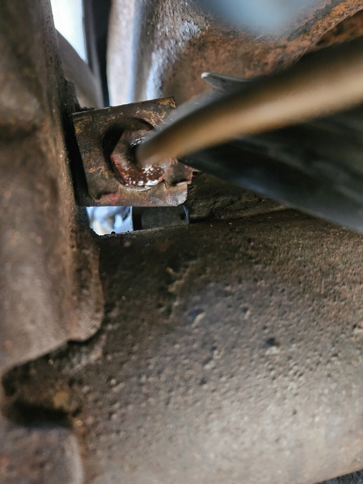

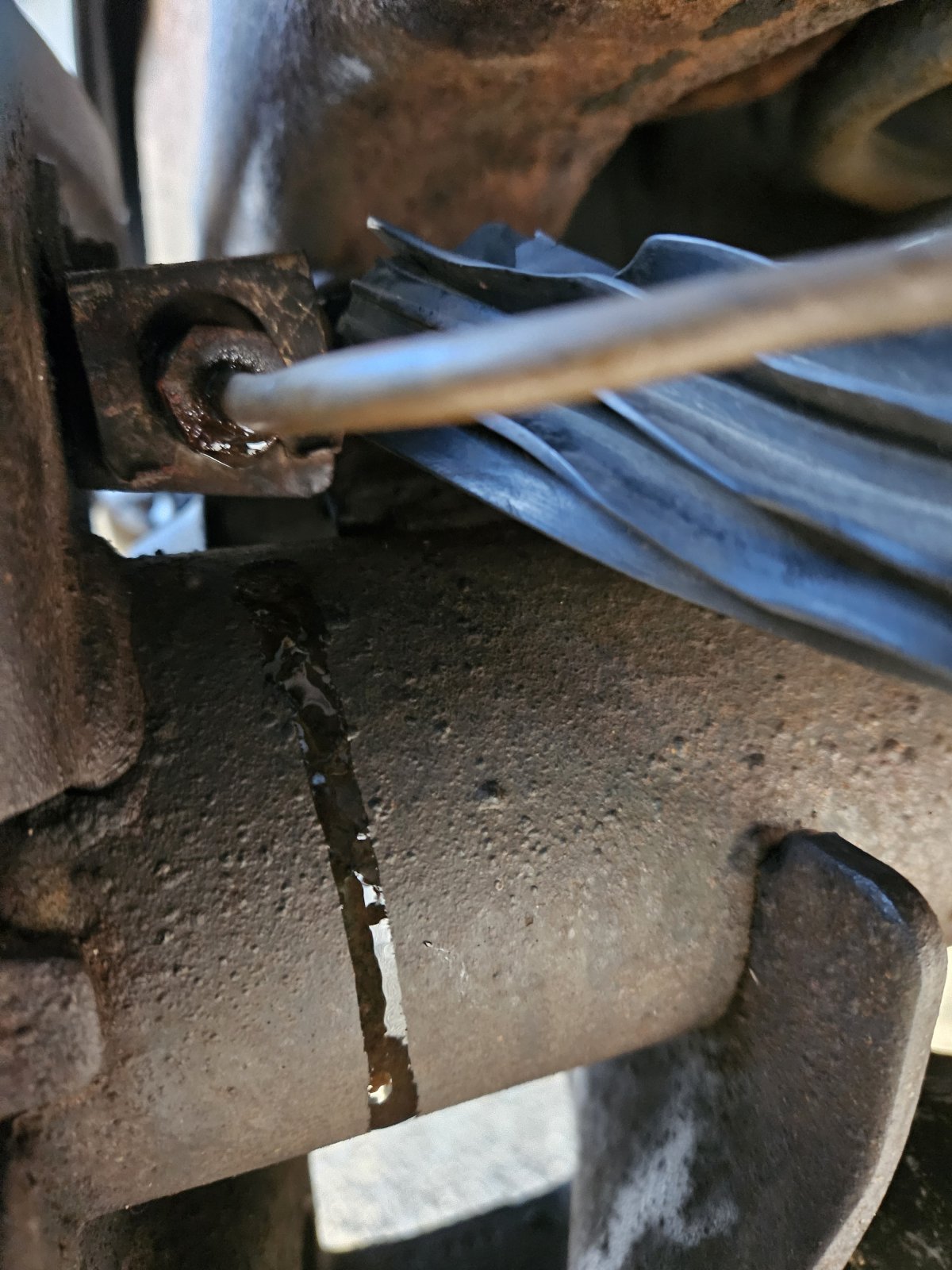

I had help. I was able to bleed 3 out of 4. Ds rear, bleeder wouldn't crack open and I didn't want it to break--you know how it goes. Other 3 bled fine. Pedal still yhe same--right to the floor. Doesn't stop any better then before. Funny--I paid a mechanic to fix a rear brake line--the one i couldn't bleed--it was leaking at the fitting. It's still leaking. I tried a few times, last time and i couldn't get it to seal correctly, that's why I paid someone else to do it. 20241207_152604.jpg20241207_152732.jpg
Same crap. I'm not sure if this is the reason the pedal goes to the floor.

I had help. I was able to bleed 3 out of 4. Ds rear, bleeder wouldn't crack open and I didn't want it to break--you know how it goes. Other 3 bled fine. Pedal still yhe same--right to the floor. Doesn't stop any better then before. Funny--I paid a mechanic to fix a rear brake line--the one i couldn't bleed--it was leaking at the fitting. It's still leaking. I tried a few times, last time and i couldn't get it to seal correctly, that's why I paid someone else to do it.View attachment 444429View attachment 444430
Replace that section of brake tubing w a new piece and high pressure compression fittings. Not a bad job to do
Smokin' gun, I would bet on...
I once had my mechanic do some front work to my 99 Silverado and he somehow left the brake hose with too much slack. The next day my brake pedal went straight to the floor on the first light leaving work, with very little brake power. I was able to stop by a Home Depot and then saw the the line ruptured because the rim was making contact on the line, and abraded it away.
If the hydraulic system has a leak, it can't possibly build pressure (or not enough pressure, depending on severe the leak is.)
Im actually scared to mess with it. What should take a few hours usually takes me a whole day--or longer. The other brake line flare I did wasn't right, and I couldn't get it right--thus the Teflon tape. Who knew there was so many different kinds of flares.

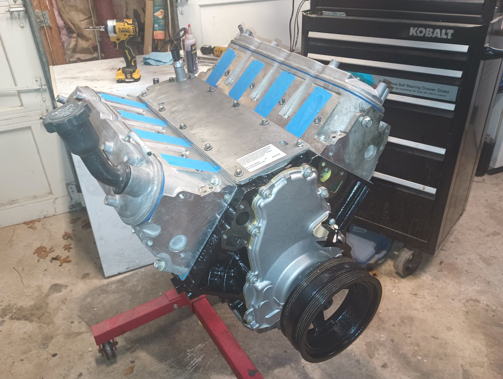

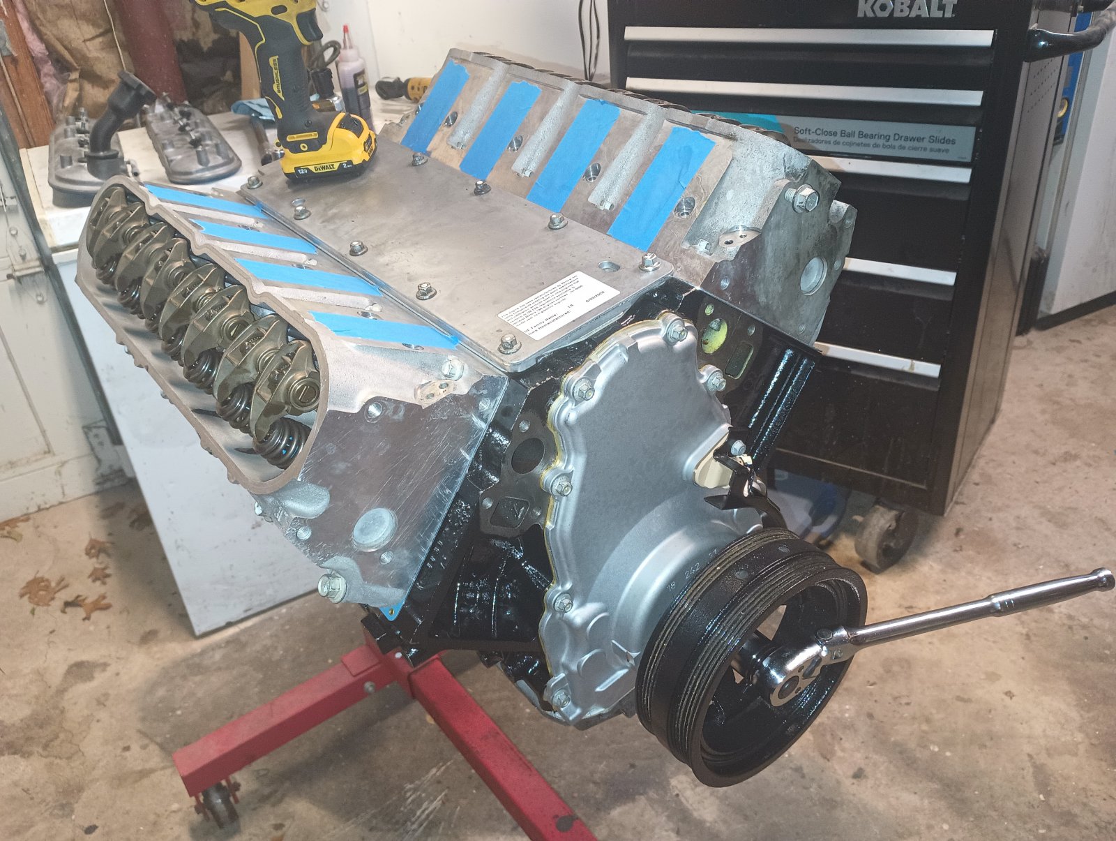

Finished my 6.0 LS engine I started building over 1 years ago! Installed pushrods, rockers and valve covers. L96 block with Gen III reluctor and the associated mods to run it on a Gen III vehicle or ECU.
I had originally planned to swap it into my 99 Silverado, but the 5.3 I swapped (from the V6) in it is running just fine...so?

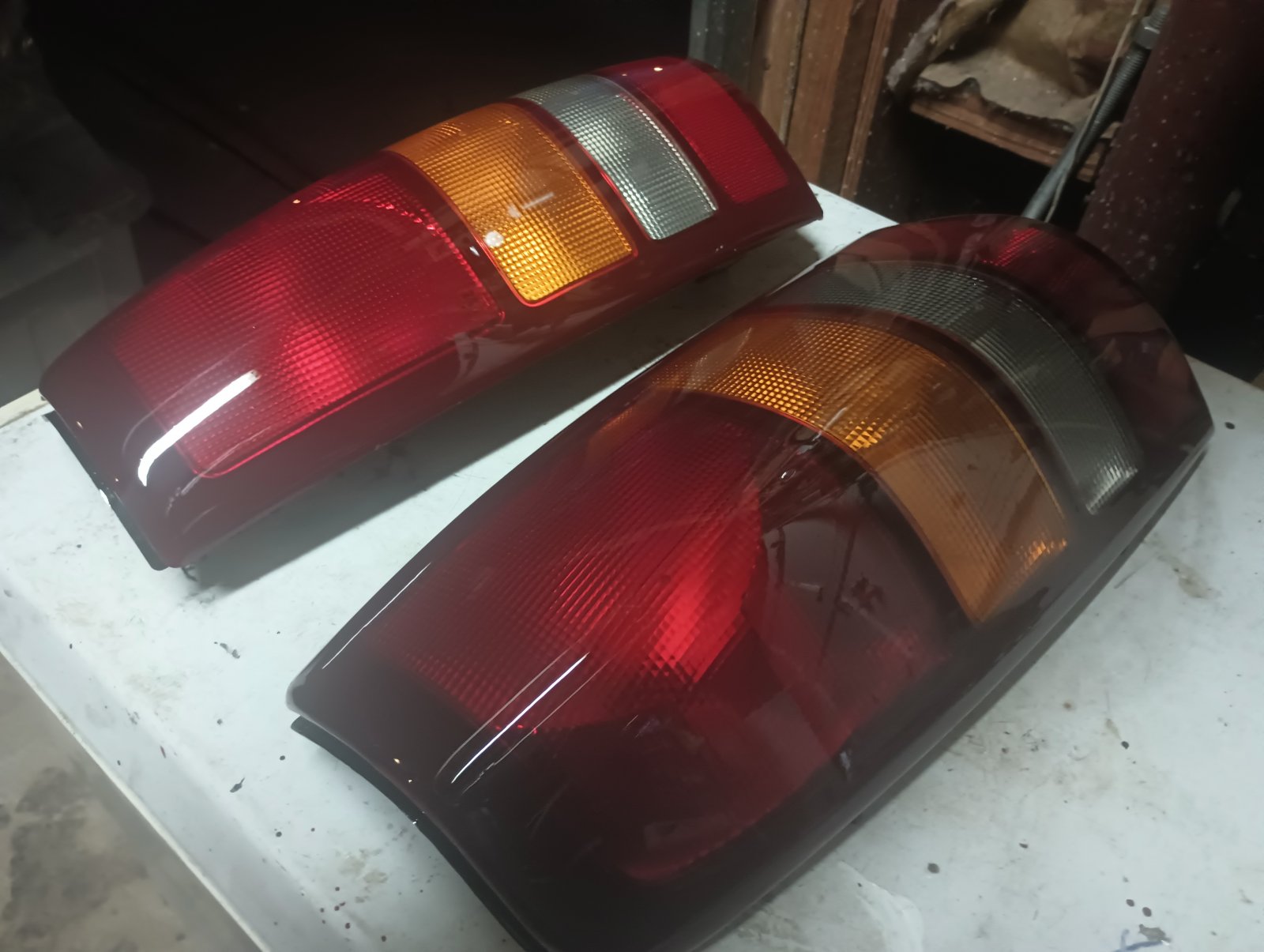

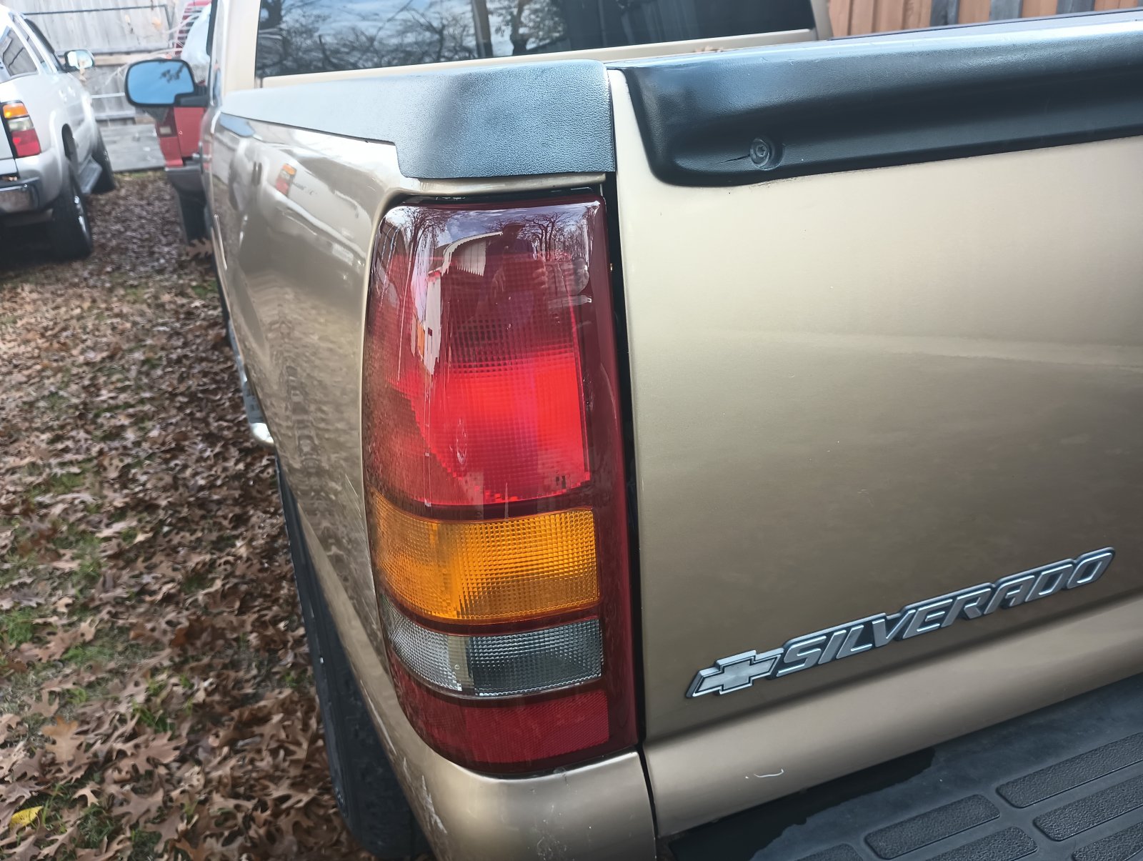

I removed and wet sanded the rear taillights from my 99 Silverado. Pretty easy removal and a lot of yellowish residue came out on the sanding slurry.
I didn't use the rubbing compound that came with my 3M kit because I'll clearcoat them over the weekend when I paint the roof of my 04 project Suburban. I'm sure I'll have a few ounces left over of clear.
It's one of those little projects that literally don't take any money, except for elbow grease.
I cleared these yesterday...just reinstalled them. Not bad, eh?
I wonder if I should do the rear taillights on the suburbans now?
