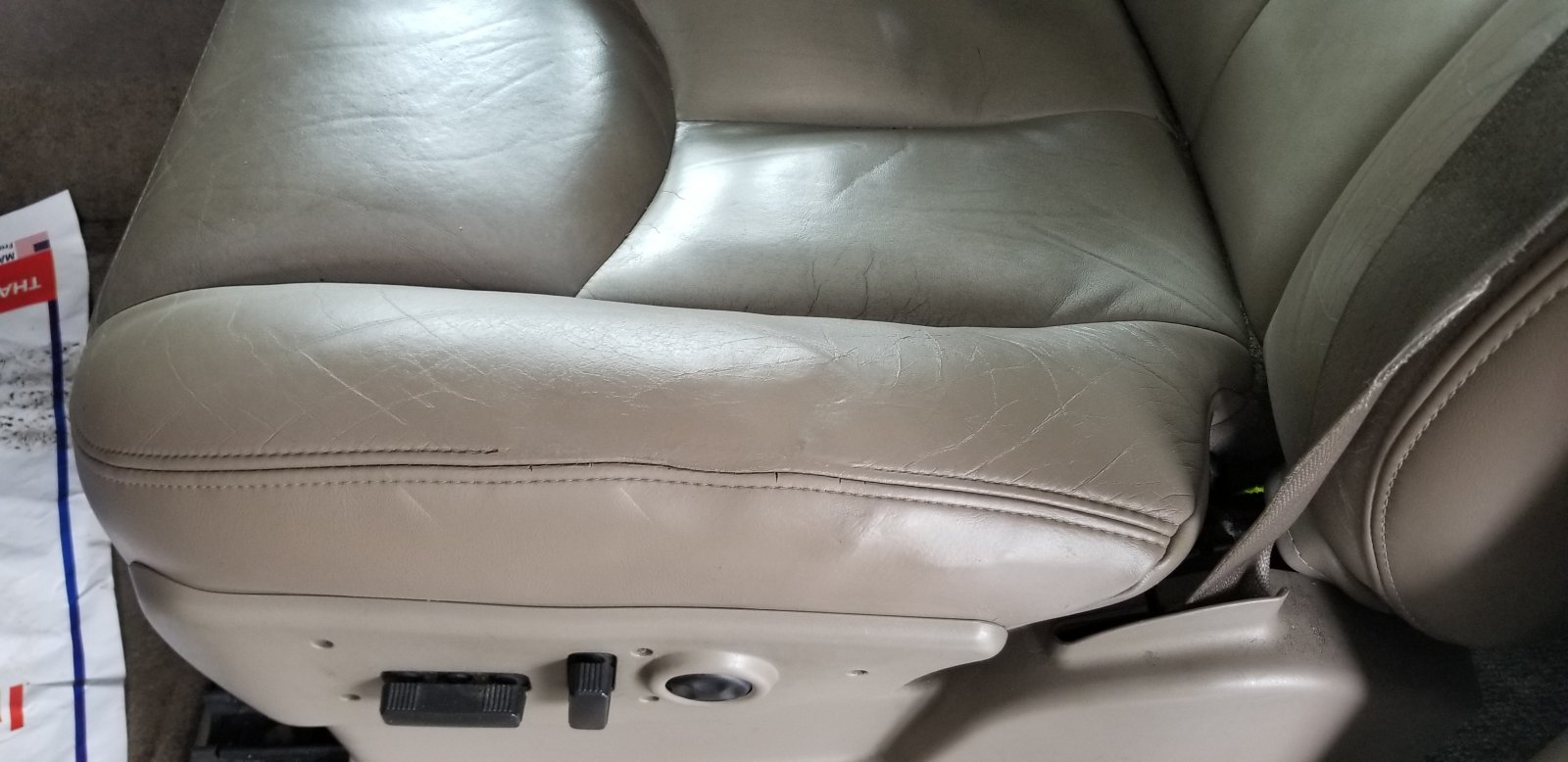

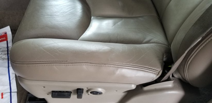

Painted my rear seat with SEM looks 100% better now have to do the other side.

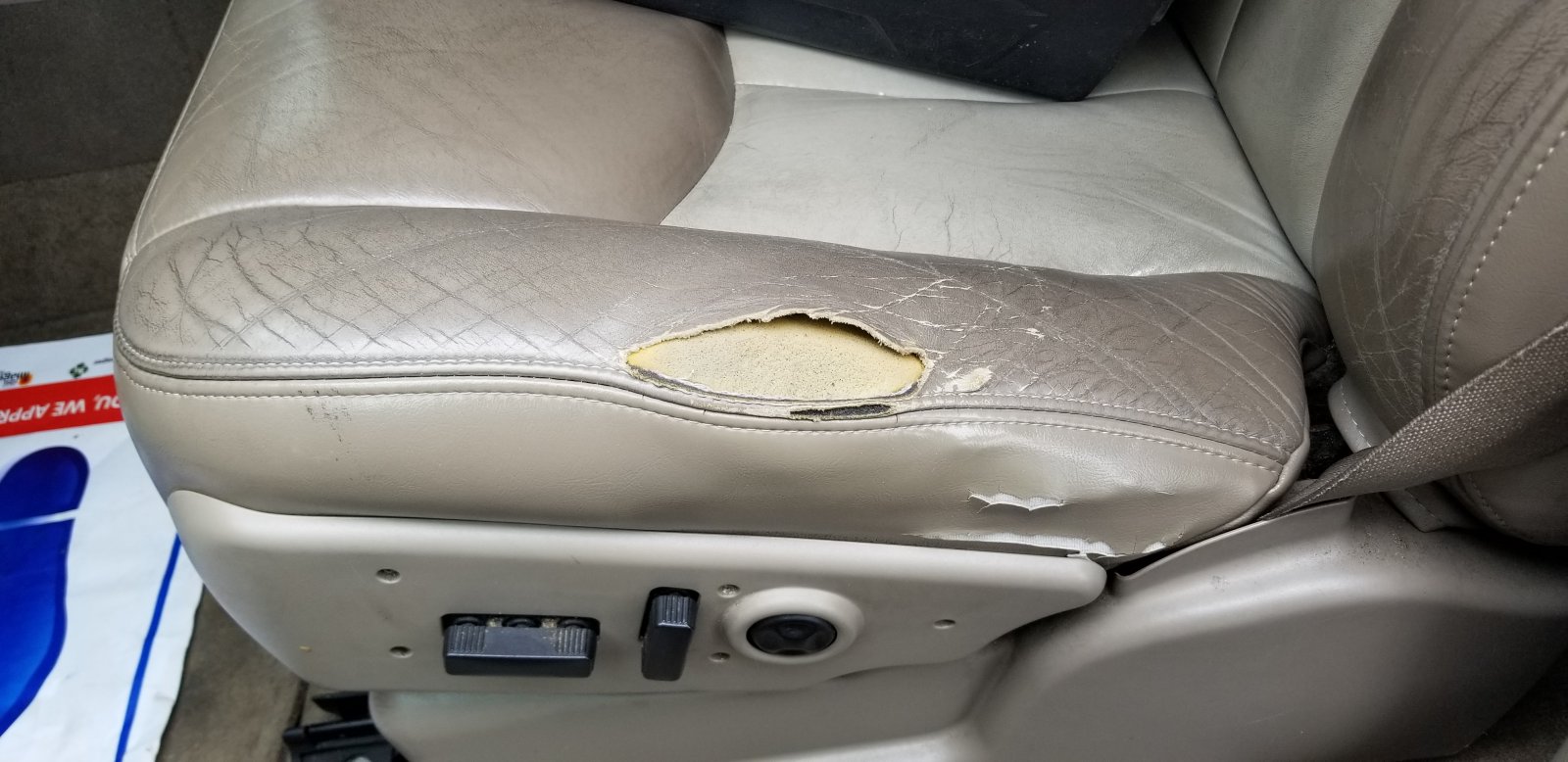

Why did I paint my seats you might ask, well that's a long story.
When I got the truck the drivers bottom was ripped and the passenger bottom was close to it. I knew a detail/paint correction, kinda do it all guy who said he could fix the seats - yeah this is where it all went wrong.
So I go to pick it up and he replaced the drivers cover and used basically a type of bondo for leather on the passengers seat, the kicker was he says you can't get the original color int dye so he had to "custom" mix some dye....
So the color was close but has too much blue in it and now if I change any part the color won't match hence why I am painting the rear because yes he painted the rear to match the front. Plus I am sure he used paint which is why the drivers seat didn't last a year before cracking and the top cover is cracking as well.
So when I redo the leather on the front I will also need to fix all the overspray on the plastic molding pieces as well.

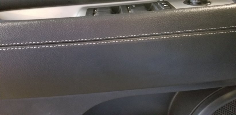

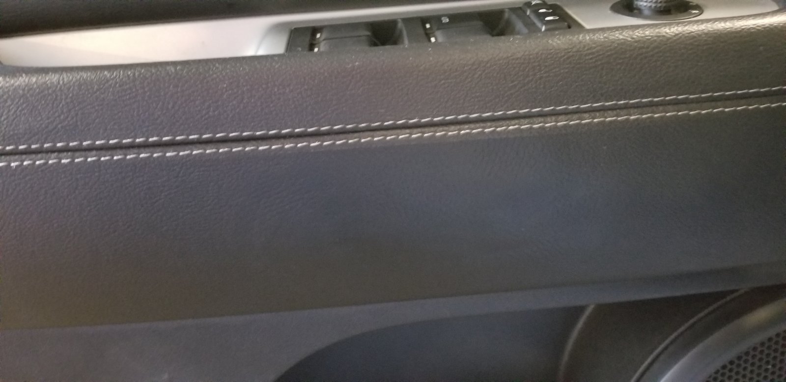

Depending on what product he used on the seats it doesn't last. Also the repair on the seat won't last either. I used to repair seats for dealers. They still sell the exact leather colors for the NBS. Did you use SEM products?
Here's the kind of stuff I used to do.
Good work! Yeah I used SEM and when he told me he couldnt get factory color I knew he didn't know what he was talking about but by them my seats were already painted so....here I am LOL
