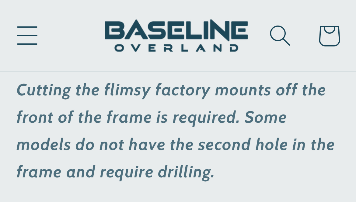

I don’t know about that sob story…

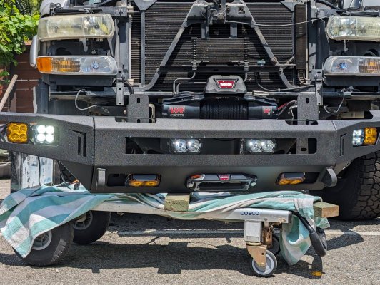

Still false advertising on the main page... No cutting, grinding, welding? All the rookies like me who think it's just a couple of screws are falling for it. Either way ... Almost done putting it together anyway.

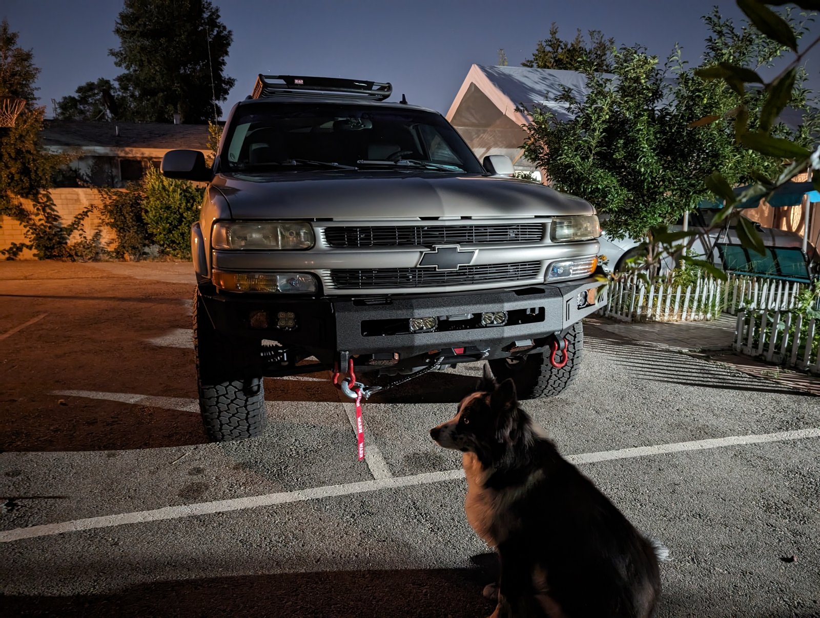

Here's a night photo for now... I wrapped up an hour ago. Finished at 6 but as you could see from my previous pics I make a ton of mess everywhere.

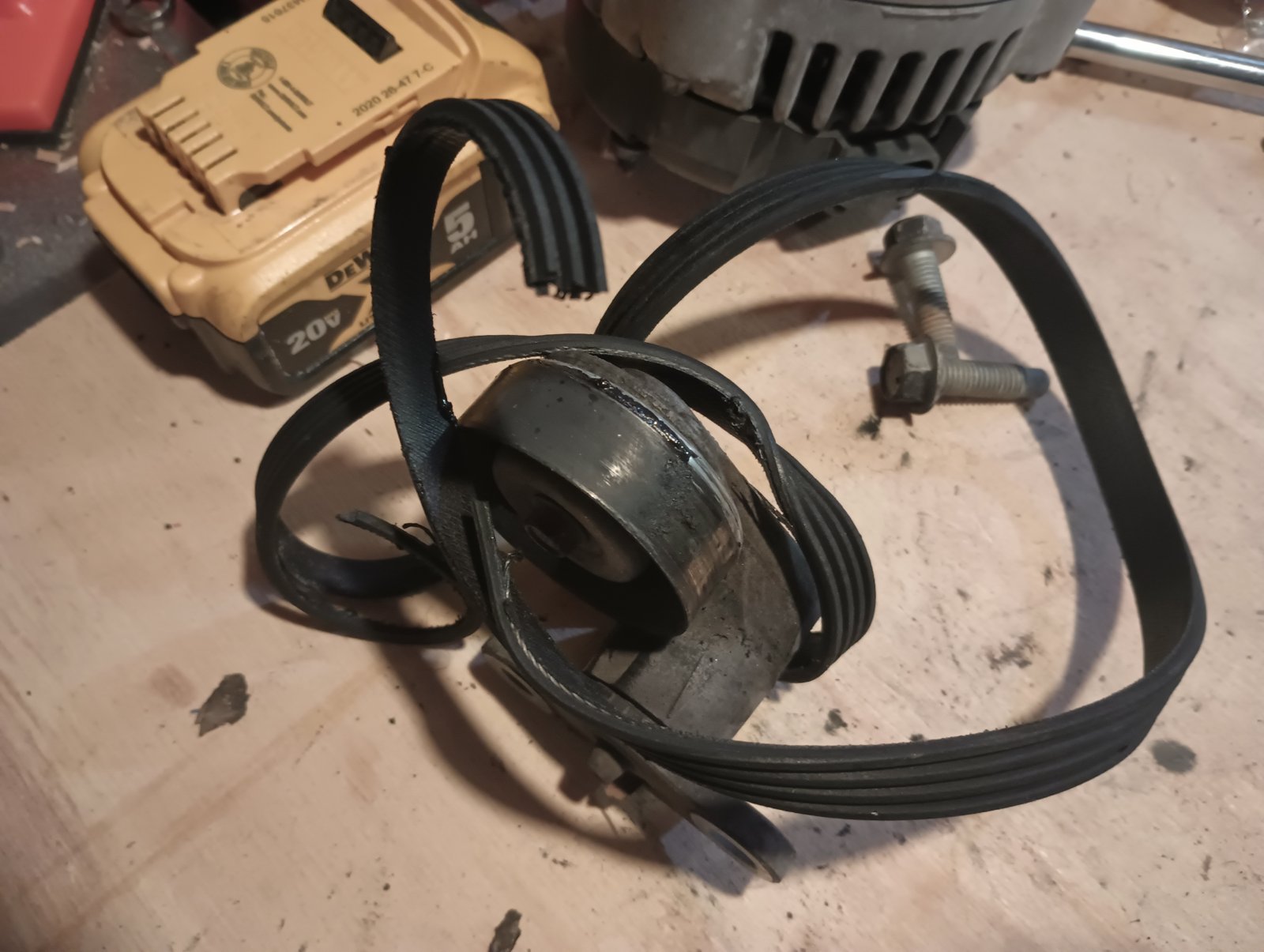

Do it again Tony.
Now my 06 Suburban did the same. AC tensioner seized and snapped the belt. DejaBoo!
I think this is a fairly common issue because the tensioner is mounted so low on the engine. I think it's prone to getting wet a lot and getting exposed to debris, and over time it just gives up the ghost. Did you replace it already?
It's been a few years since I replaced mine, so I'm expecting mine to seize up soon too lol.

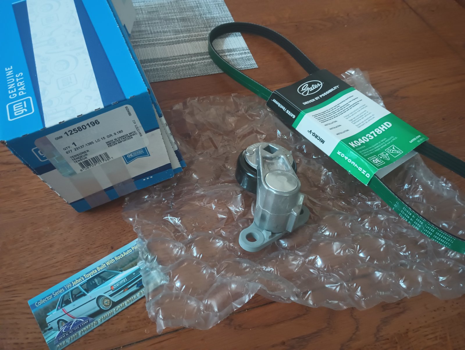

Yeah, I think you are right. The tensioner sits low in the engine and I would imagine it gets a lot of water and debris.
I didn't replace it yet. Will order new parts today from RockAuto.
This is the engine I just overhauled and had replaced the belt because it had some cracks on the ribs. The lesson learned is: replace the tensioner along with the belt.

from personal experience, if the belt snaps and the the tensioner pulley breaks. your ac compressor is on borrowed time.
so if the belt breaks again in a weeks time. just replace the compressor. or you will be buying another belt, then another belt and so on and so on lol fml type of deal. i went 3 belts deep and a tensioner lol

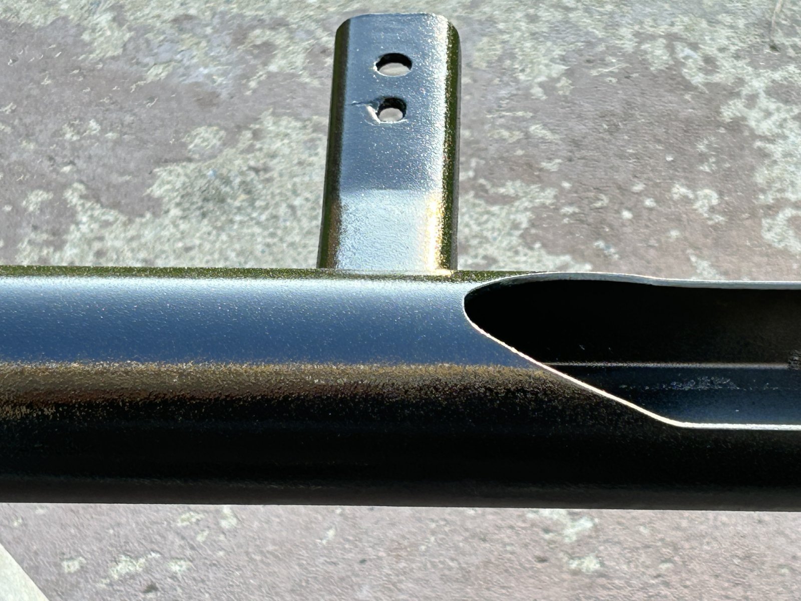

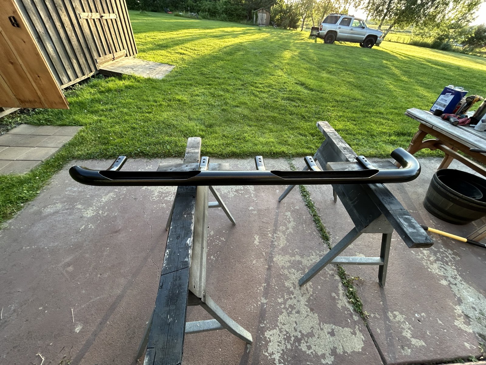

My OE z71 running boards were starting to oxidize and peel paint in certain spots, not to mention the amount of rock chips on the front.
Pulled them off and ground down the corrosion with a fine 3” blue fiber wheel on my 12v mini polisher.
I’m going for looks good 10ft away, not a show truck. I cleaned them meticulously with degrease and acetone, then primed them with self etching primer. Tried some satin black but wasn’t a fan of seen all the imperfections… plus it just didn’t lay down right.
Remembered I had a few cans of bed liner spray in the cabinet. Tried that and was pleased with the appearance.

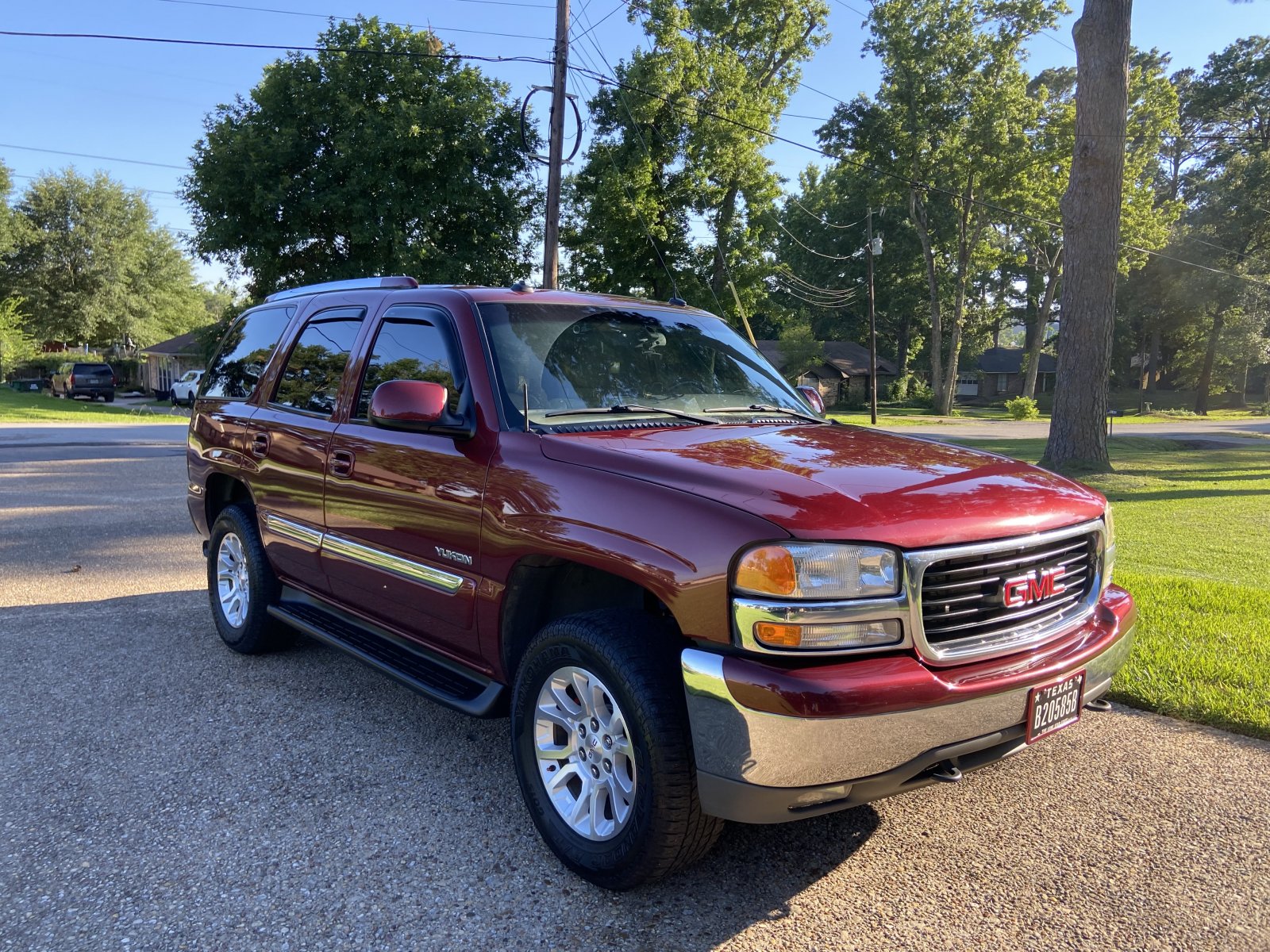

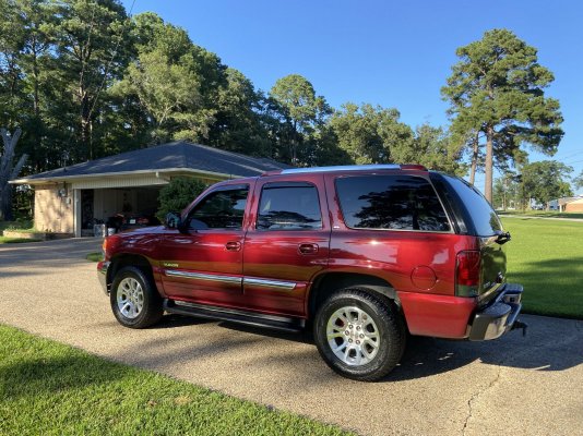

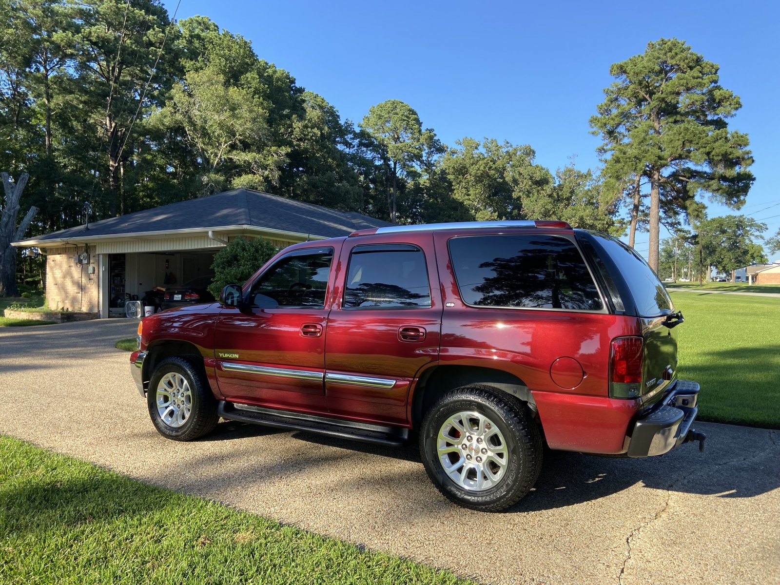

Finally took some time to clean her up a bit. I hate having a dirty vehicle, but just don’t have much time these days..

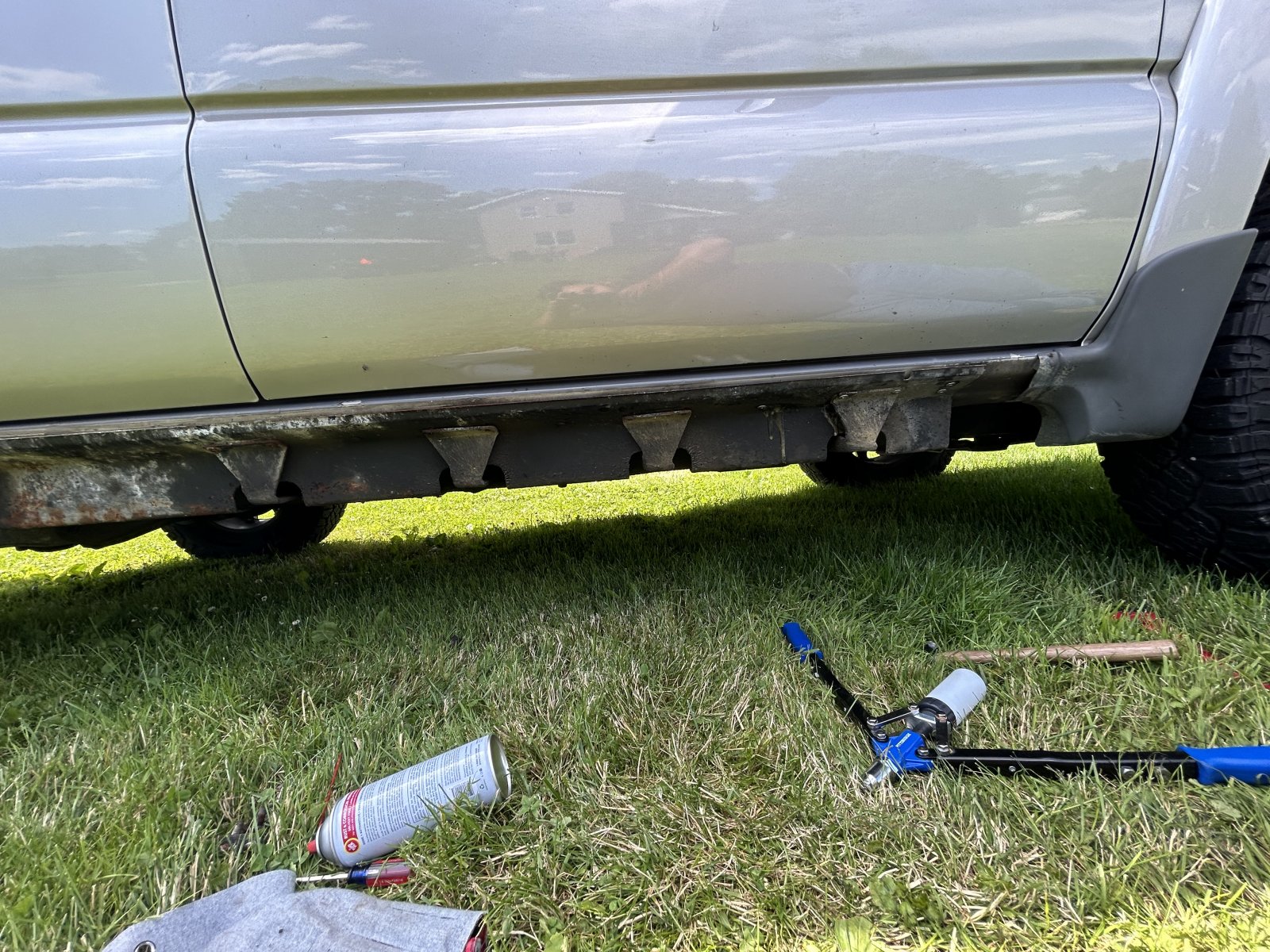

While I was doing my running boards, my passenger side Z71 cladding has always hung low. Took it off to find the cladding bracket missing some of the 1/4 rivets. Also found most of the 1/4” rivets holding the top of the running board mounts to the rockers gone.
Spent the after noon re-riveting everything. Man these running boards are solid as all get out now. Super pleased.
Also super happy with how the truck is holding up. 20 years and a NY truck, rockers are mint. I will continue my liberal oil undercoating and washing routine.
Huge fan of rattle-can bed liner for hiding imperfections. Used on my Z71 running boards as you did as well as the rear appliqué’s… also did the rear bumper and the used a top coat / clear coat over it to match the body color…
