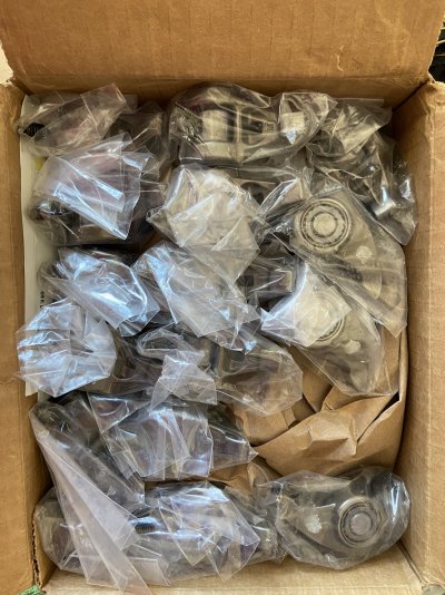

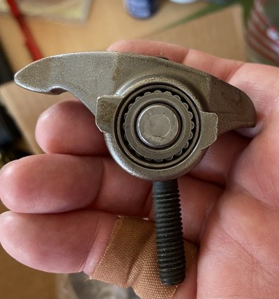

Received my rockers with built in trunnion upgrade a few days ago…

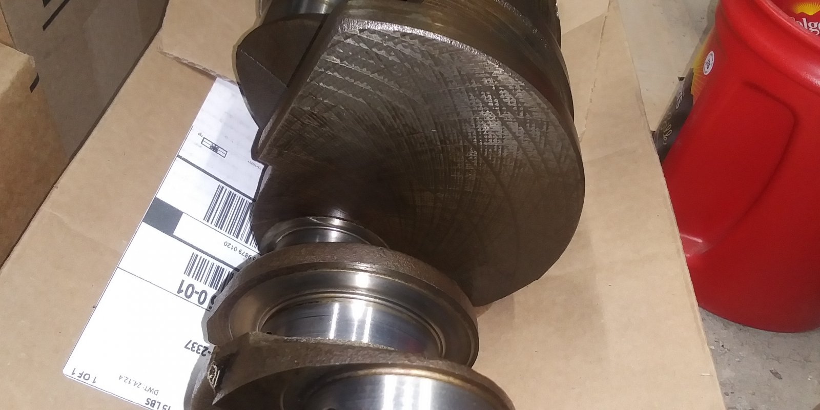

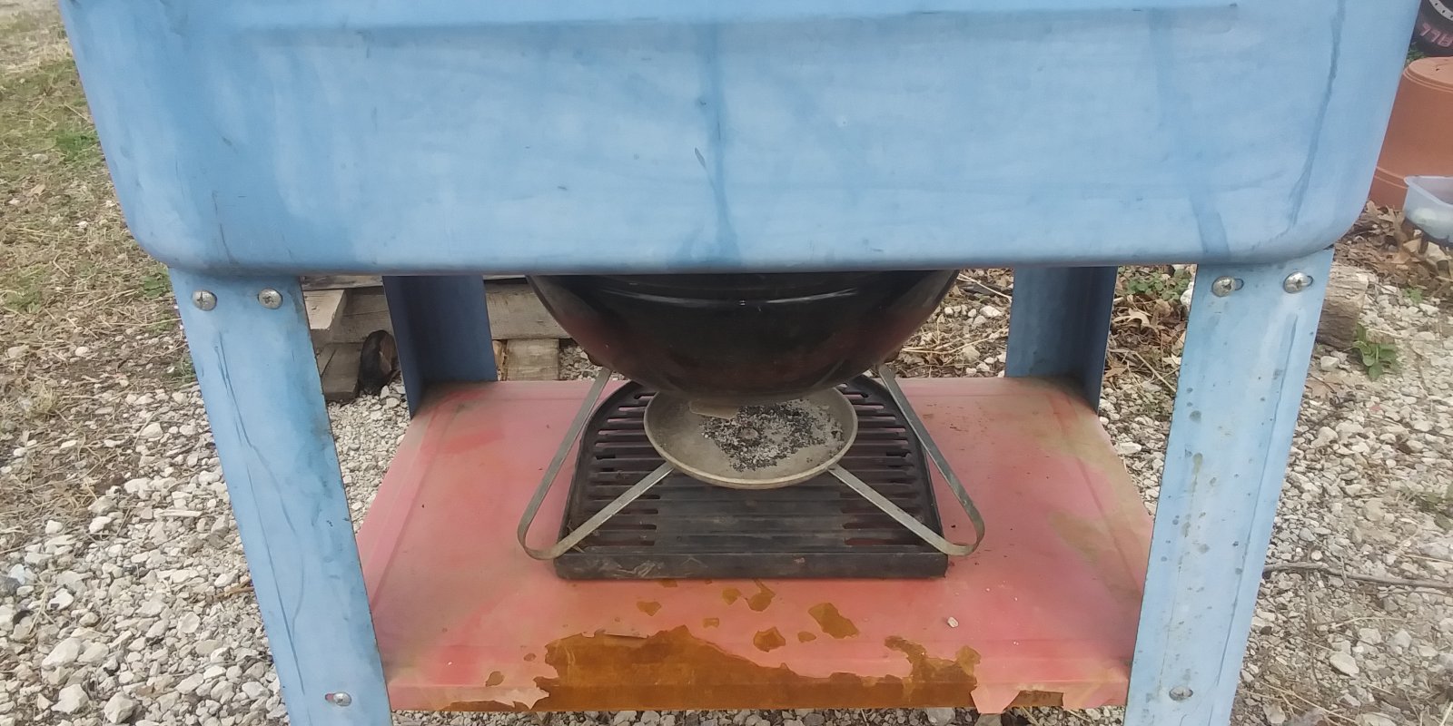

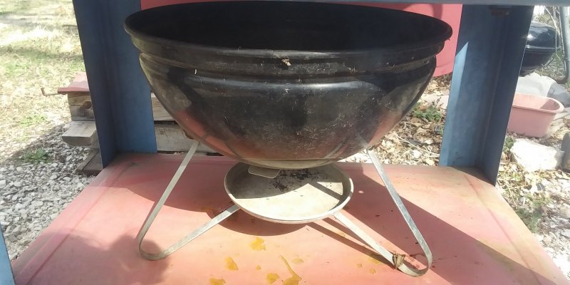

Built a hillbilly hot tank for this crankshaft. It's windy AF, so I raised the Smokey Joe up closer. If I get the gap at the top right I should be able to load it with coal and regulate the temp with the bottom damper. Its only at 115° right now though.

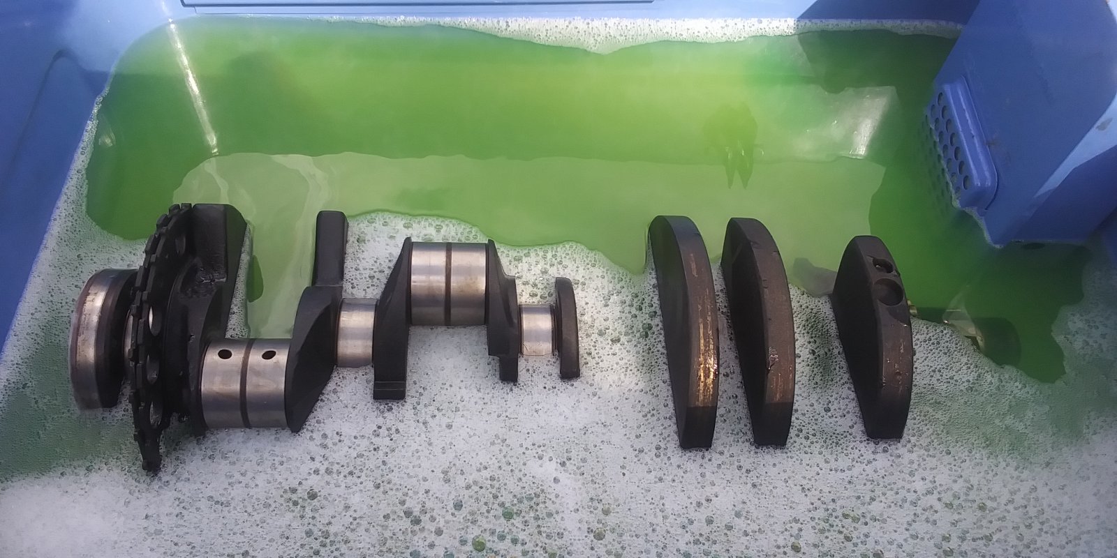

Dang wind is killing me. Got this baffle pretty clean though. Took it to the diesel/psc100 tank afterwards to stop the flash rust. This crankshaft gets heavy trying to scrub it. Thinking about tossing it in a trash bag and going to the car wash

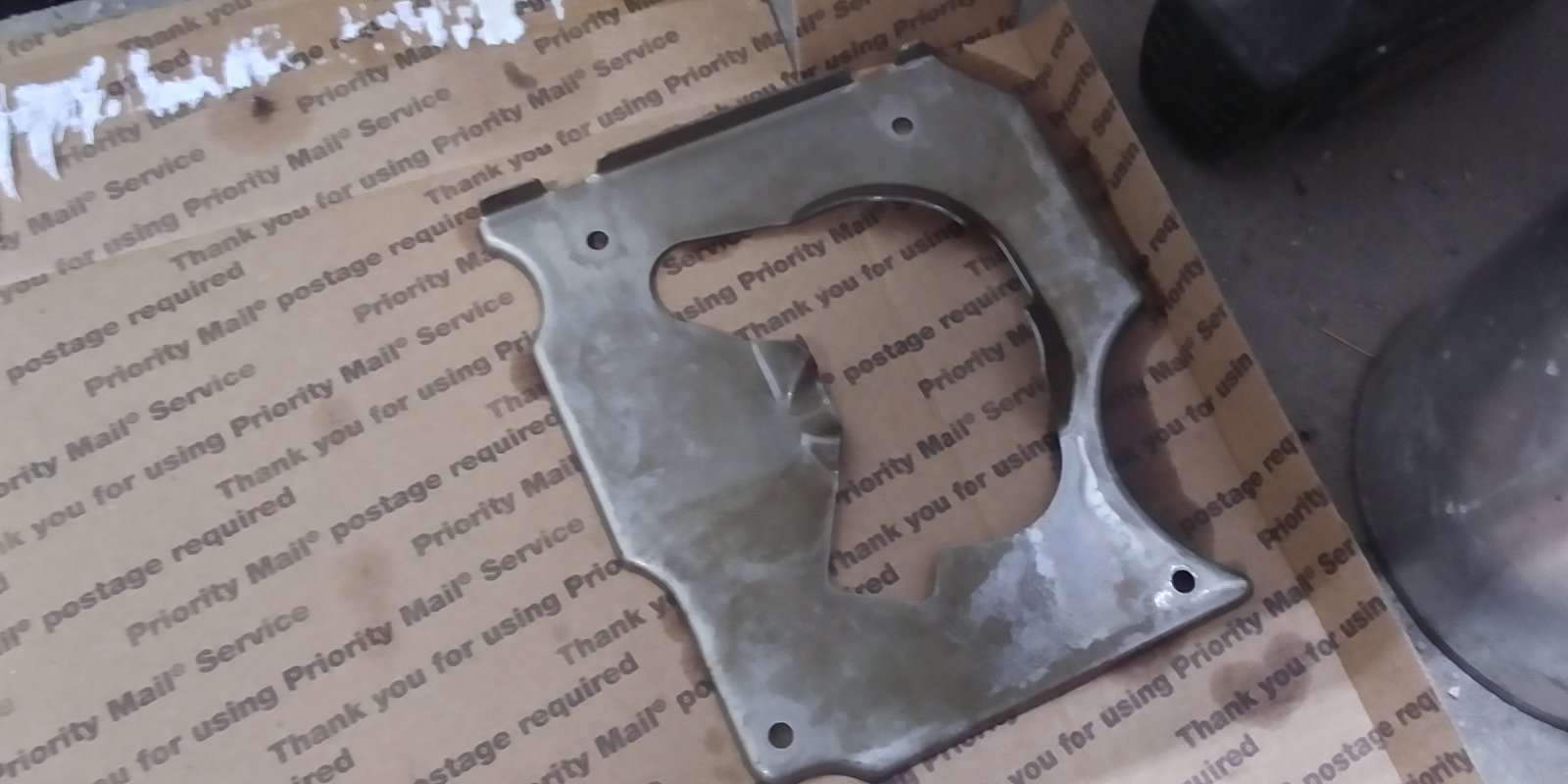

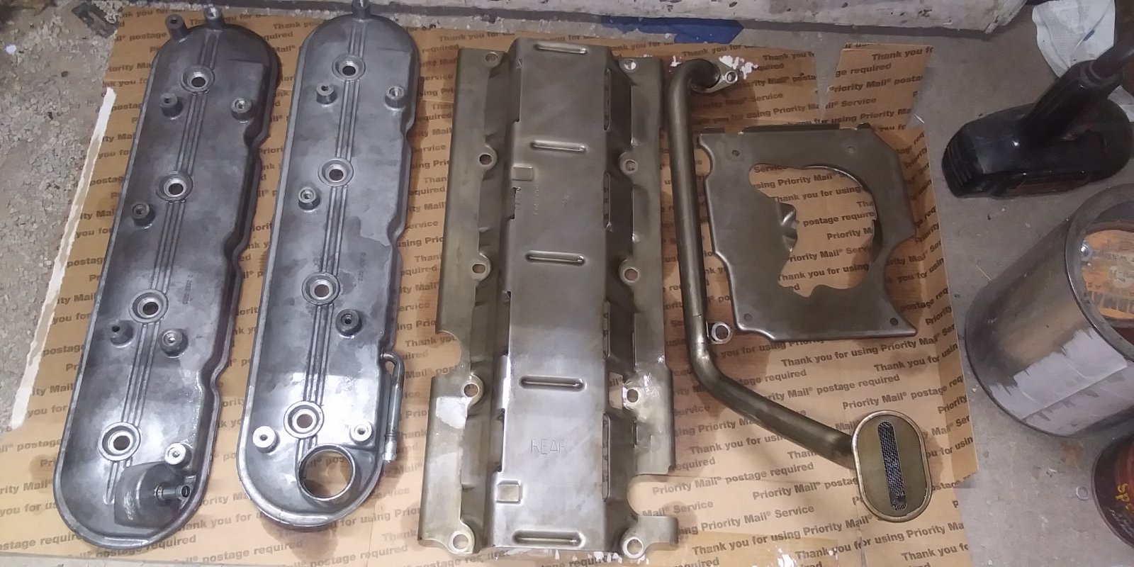

I can live with this.
Forgot about the oil pan though, so I just put it in. Hopefully it doesn't take all night.
Oh, and these are the updated valve covers right? I picked them up for 50, came with a set of 862 heads, rocker arms and 15 pushrods lol.

Hopefully they're not Castech 862 heads. I think one on my van is cracked. Got a pic of the logo on them? Castech logo looks like a battery.
