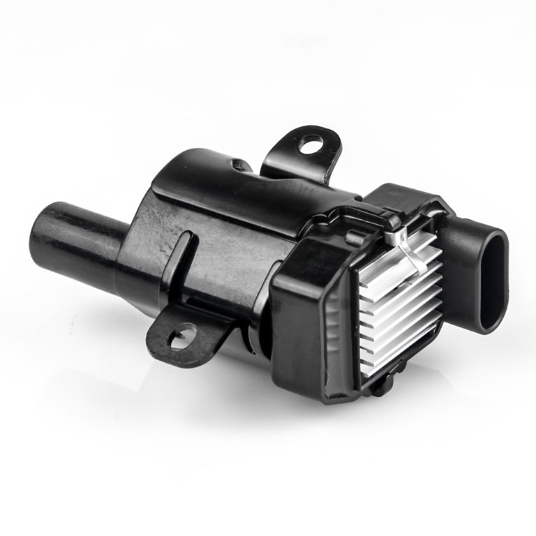

10 mm? Have a link? I MIGHT just buy a set. My old 10mm Taylor's were almost $100. Stupid kid ruined a few, so he replaced with stockish wires--no name.
These are $129 but they’re the only ones I haven’t burned through. You need to have the right coils, yours should be. Look at the description. You can’t go by the fitment chart.

The coils should look like this. It they’re the square ones the wires won’t be long enough.
Thx Mark. I'll check the coils out later on. I never burned through the Taylor's, the moron broke a few pulling them off.

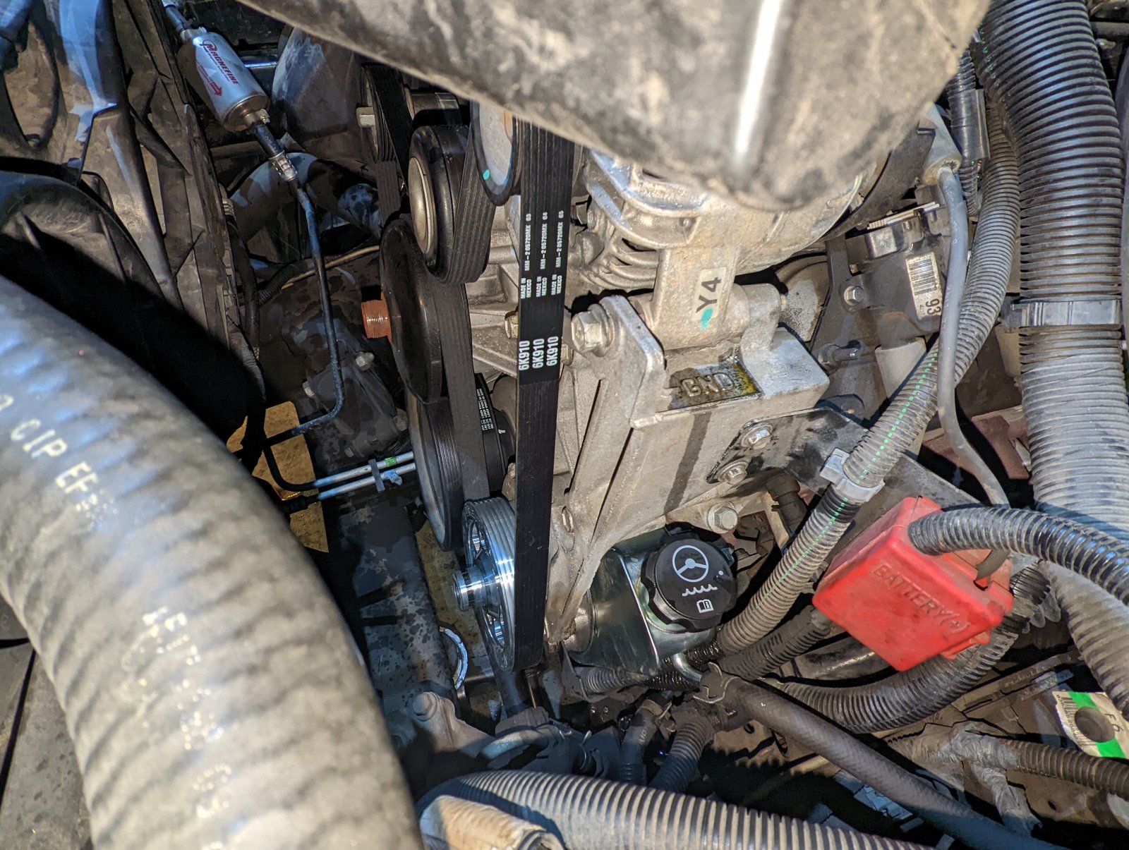

Power steering pump and filter.
Have yet to drive it. But it's in! Ended up swapping a smaller pulley in as well. No issues with it, but I have a habit of whipping my wheel fast enough that I was out-pacing flow rate at idle LOL.
Brake pedal feel is MUCH improved. If I mash it, I can feel the assist allll the way down, then pump goes into bypass. Never got that on the last one. I'd feel the assist cap out, then nothing from the pump.
Put a block heater in as well. Have that running to see if the thing works before I take it out for a spin. Might have been a DOA unit, behavior is odd. but nonetheless: letting it go for an hour or two to make sure before I start dicking with a product exchange.
Yes I know my engine bay is filthy. On my list of things to clean when it isn't freezing

Nice. I struggled so much with the pulley on my ps pump. Didn't get it all the way seated at first and it ate belts and squealed. Now it's not eating belts but doesn't squeal until its warm. Driving the wife nuts. What's your secret?
Also what pulley?
Also what pulley?
I rented a pulley tool from the local parts store
OEM pulley goes until it's flush with the nose of the pump. Just crank the tool in 'till it stops
This pulley had slightly different dimensions. So I pressed it in 0.96mm short - the nose of the pulley protrudes 0.96mm from the nose of the shaft. i.e. I didn't push it in all the way. Just measured the offset with some calipers
Here's the pulley: https://www.amazon.com/dp/B0711QW7NR
Note you will need a 2" shorter belt
Also block heater is DOA. BAH. My luck
