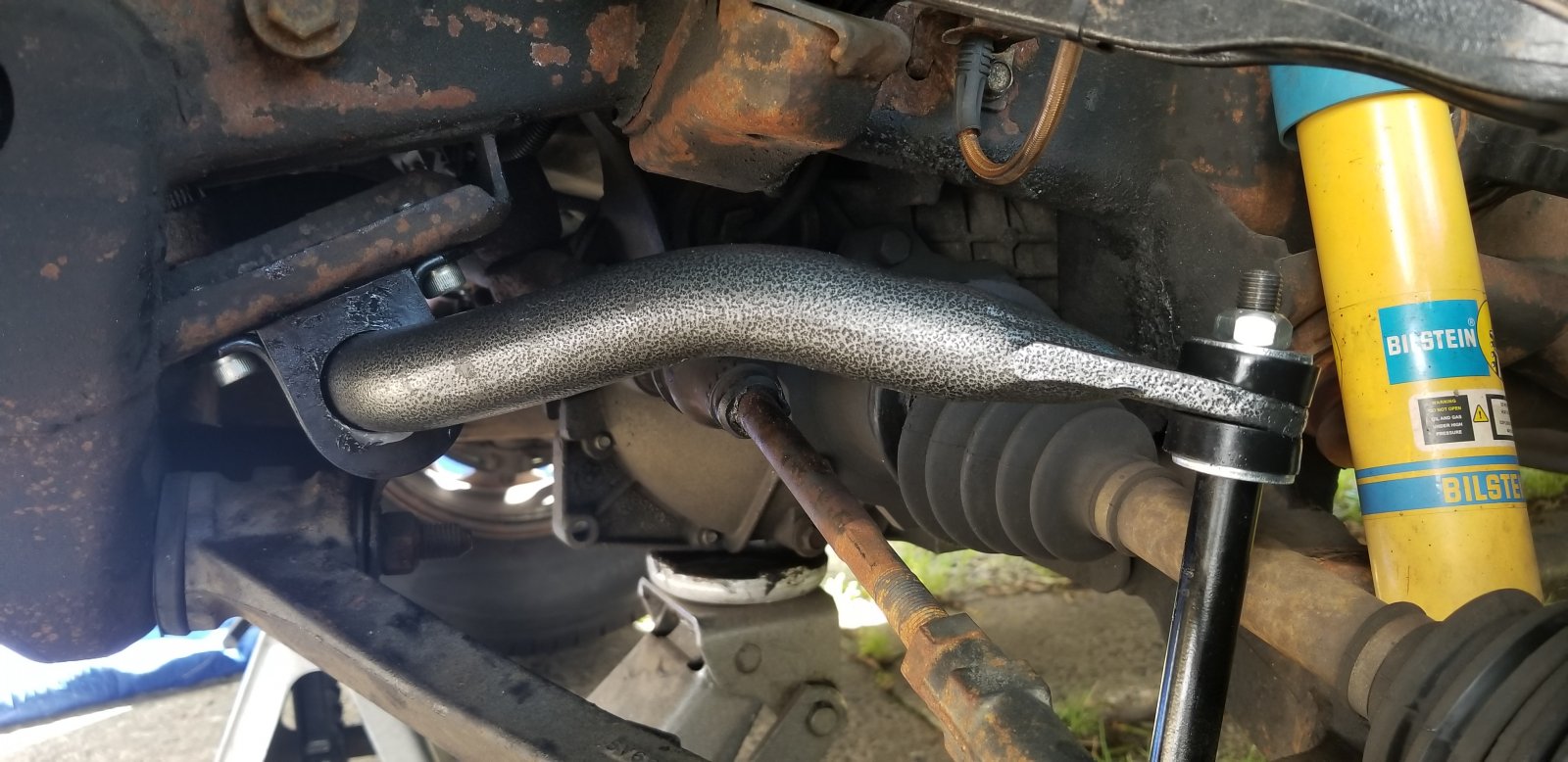

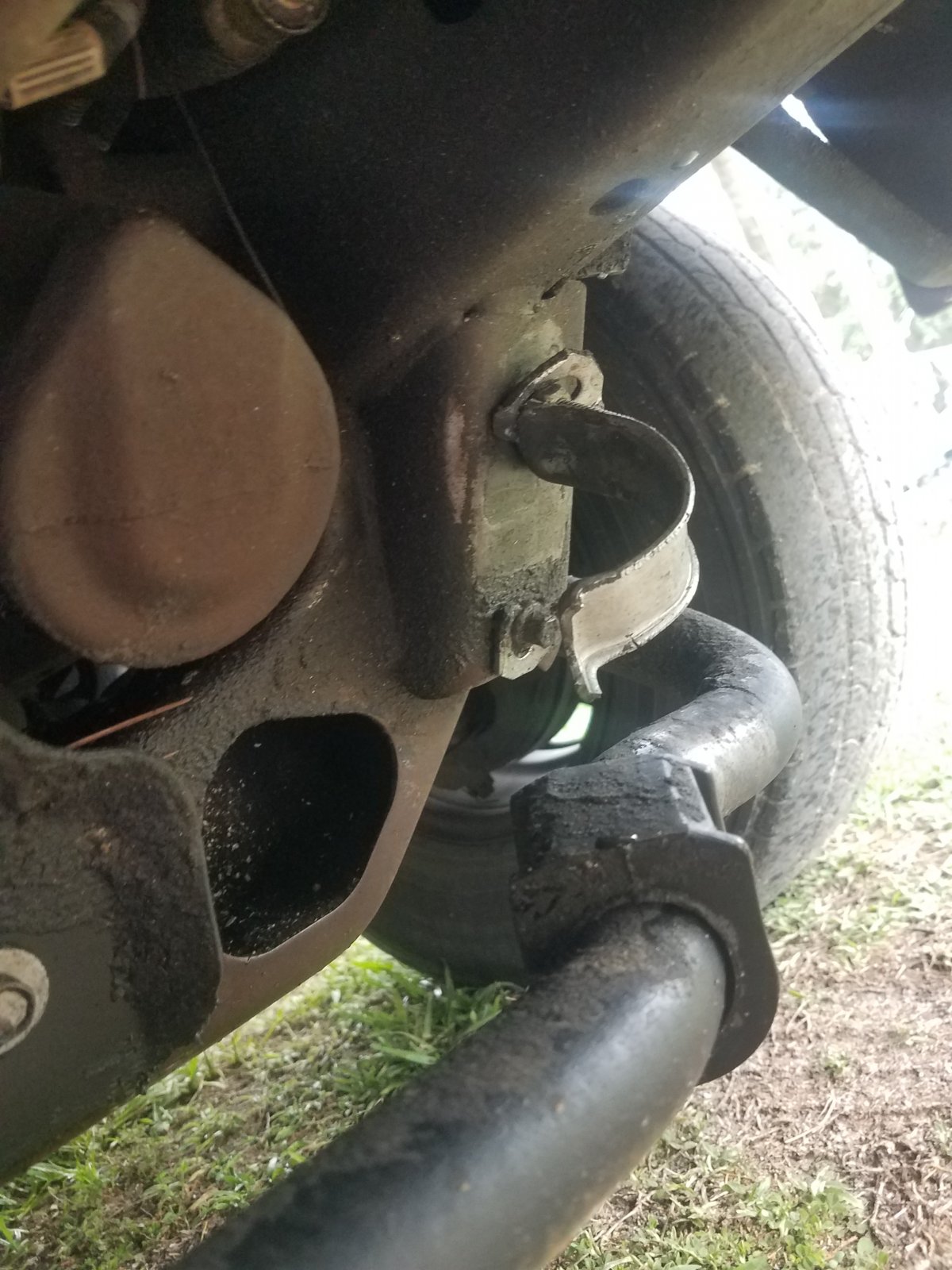

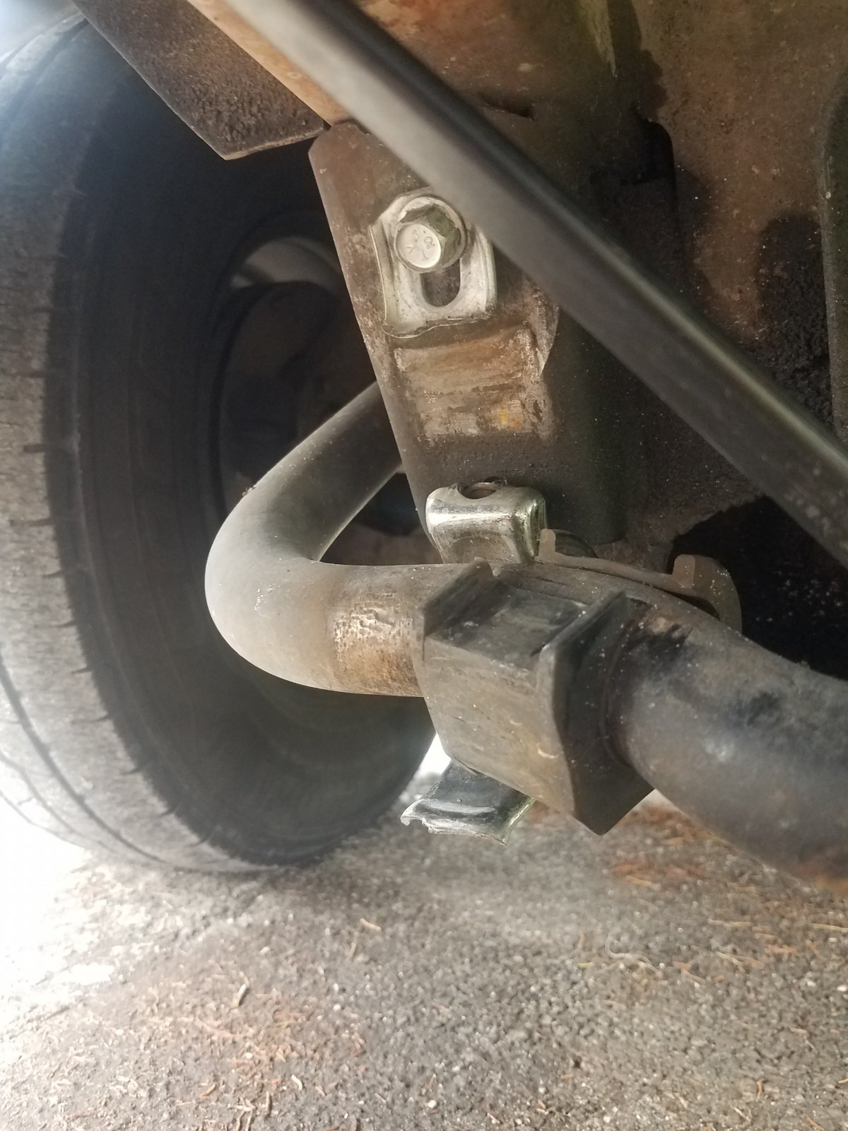

Anybody ever see sway bar brackets break like this? It's on a 2007 Savanah 2500, short wheelbase, AC service van.
no but looks like they were not the original? some cheap aftermarket? is the bar on upside down? anything else not stock? something damaged or not stock height? vehicle accident?
Bone stock with nearly 200k but this is the third or 4th time it's happened according to the owner. Bar doesn't appear to be upside down the original endlinks look proper and are actually in great shape even. This set was after market from some parts store they said, they will be replaced tomorrow with my original Tahoe brackets since I upgraded to the Hellwigs and have a set of steel ones on the shelf.
Maybe its just the angle but the bushings look bad. Probably some cheapo brackets and rust and slack in the bushings allowed the bar to move around too much.

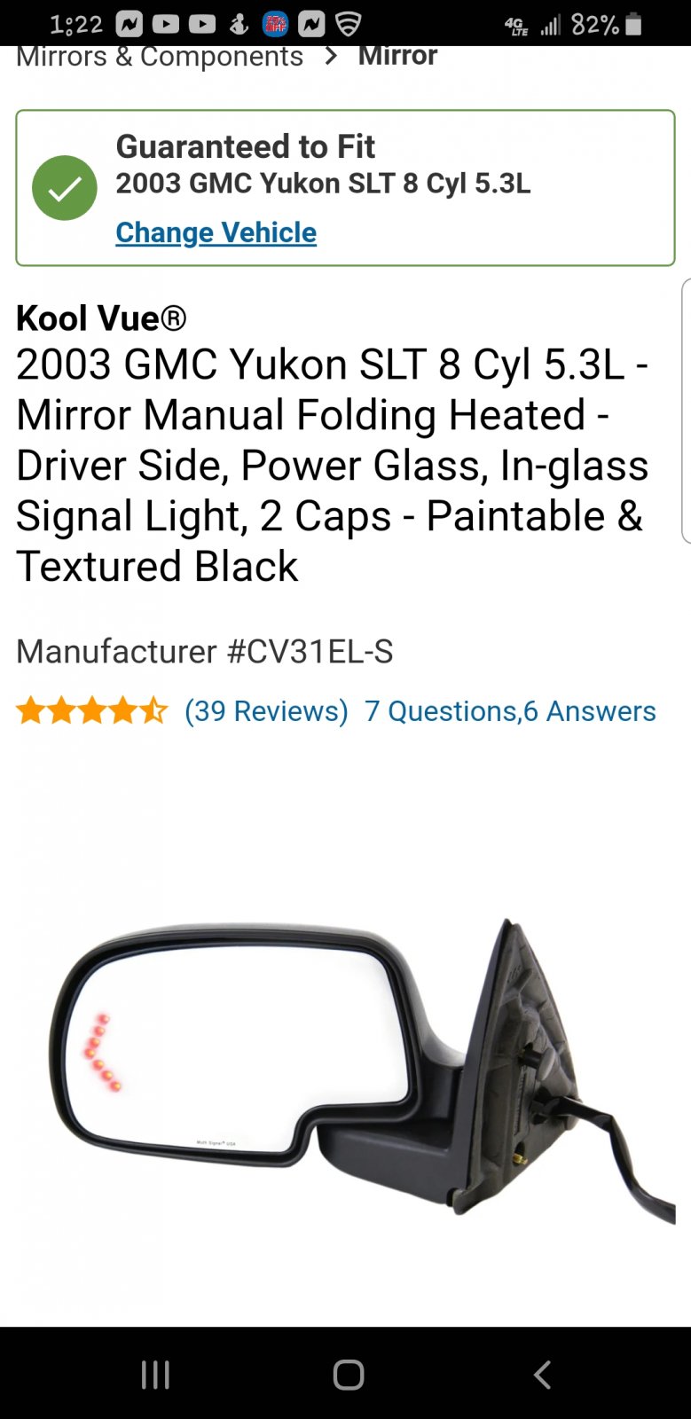

So I’ve replaced both mirrors on the Yukon at one time or another. The driver side was shot when I bought it. Now, the passenger side has several LEDs out, and I’m looking for a better replacement. Looking on RA, they have quite a variety, but the ones that would be correct are $150-200, and still not OEM. Does anyone have suggestions, or a part number..? I’m guessing the OEM is no longer made / available. It has heat, turn indicator, and auto-darkening.
ETA:
ok, so OEM is available, for $300+… I don’t think I want to spend that on a damn side mirror, but I do want all the original features. Most aftermarket ones are not auto-darkening.
So I’ll edit my request.. lol. Looks like the OEM part is: 88944392, which has heat, turn indicator and auto-darkening.
Does anyone have a decent aftermarket replacement that has these features, and you’re happy with it? I replaced this one probably about 18 months ago, maybe less, and the LEDs are already going out
The bushings actually look good, and stay steadily soaked with oil from everywhere that's leaking do they certainly arent dry haha. I slapped it all back together with the OEM steel straps and it's back to work!
ETA:
@Sam Harris You could try this one. I'm not sure if you have pwr fold or not.
You could always pop the mirror and leds out. I ordered from them before and the mirror itself (the glass)looked fine.
