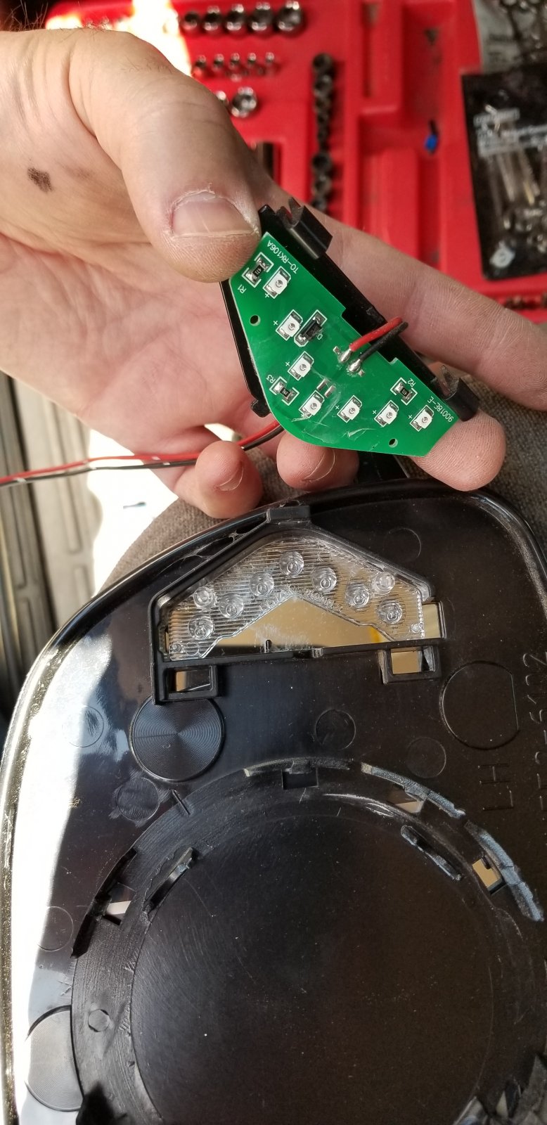

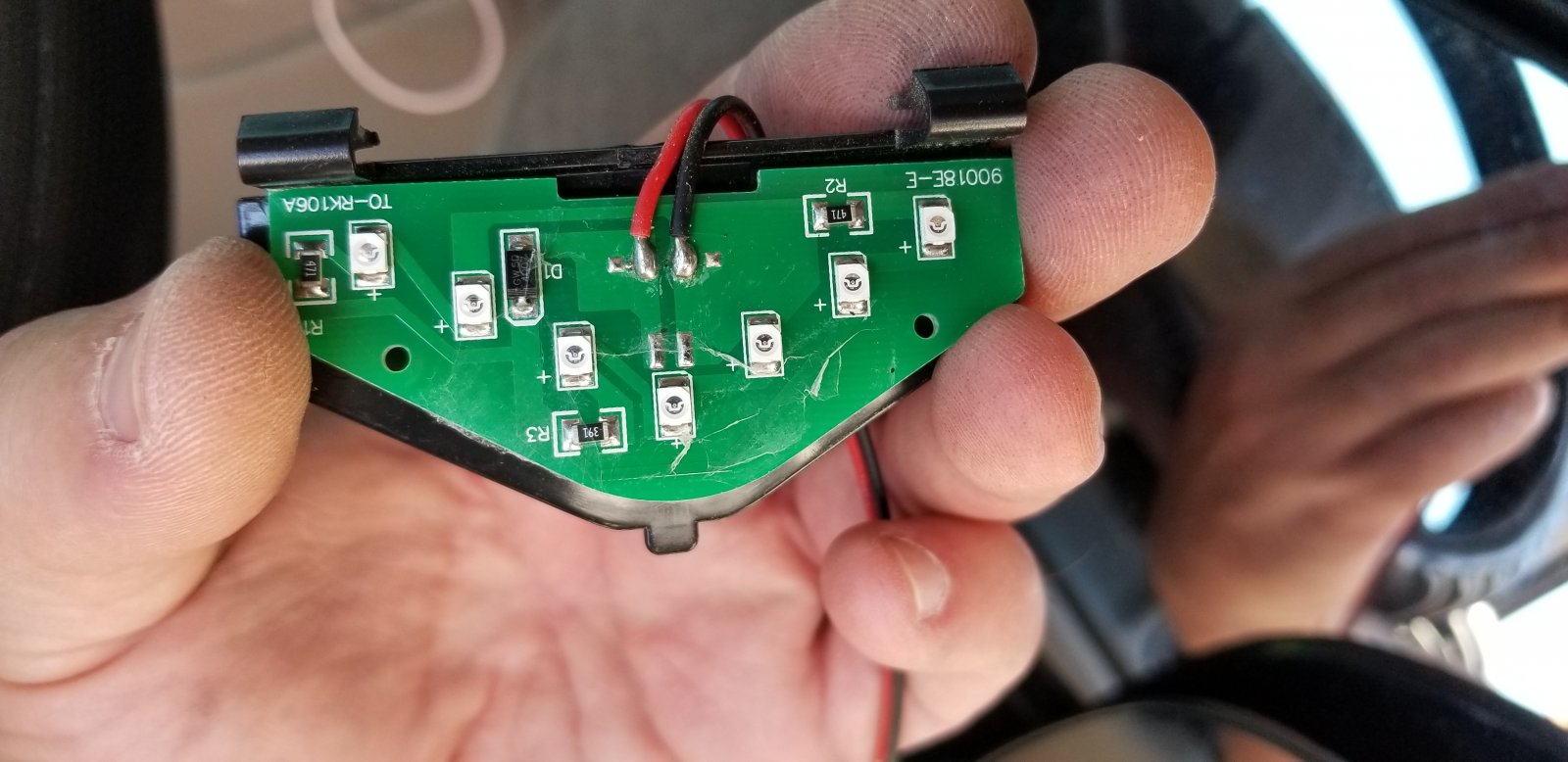

This is what the leds look like under the glass.20190511_135431.jpg20190511_135519.jpg

So I’ve replaced both mirrors on the Yukon at one time or another. The driver side was shot when I bought it. Now, the passenger side has several LEDs out, and I’m looking for a better replacement. Looking on RA, they have quite a variety, but the ones that would be correct are $150-200, and still not OEM. Does anyone have suggestions, or a part number..? I’m guessing the OEM is no longer made / available. It has heat, turn indicator, and auto-darkening.

Does anyone have a decent aftermarket replacement that has these features, and you’re happy with it? I replaced this one probably about 18 months ago, maybe less, and the LEDs are already going out

Oh I know this. I’ve replaced both. I was hoping to find someone who had replaced theirs with maybe a Dorman or something not quite so no-name, and had them last longer.
One might wonder if the solder joints might just need to be reflowed, considering the issues we've all had with other components and the lead-free solder.
This is a good plan… since there are the 3 middle ones out, I think I’ll try the chip in the middle as well, as there are 3 separate chips in there also. (Of course, being careful not to overheat it)

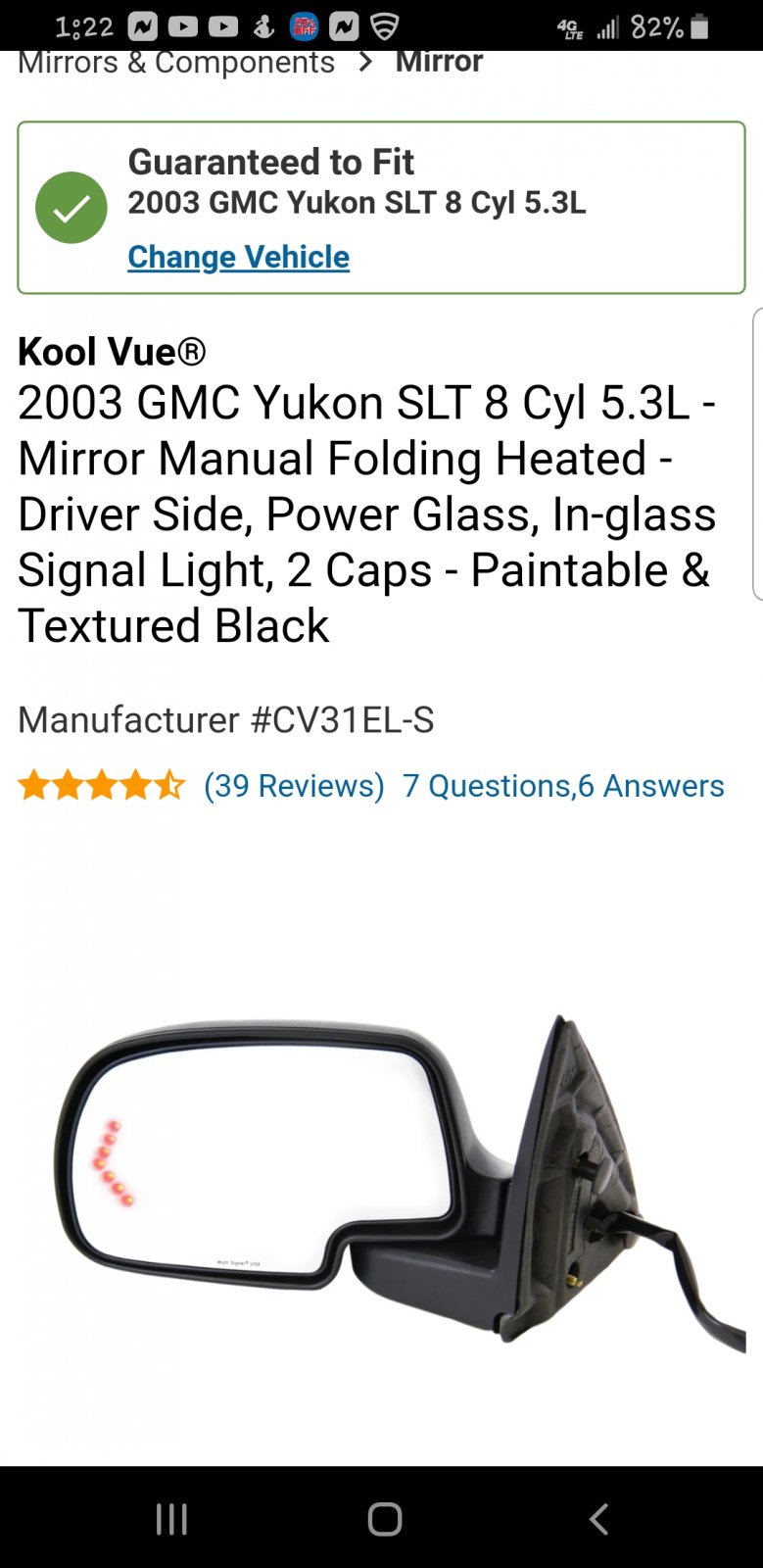

I have used a couple of the cheap replacement mirror glass assemblies with mixed success. Some of them look like a funhouse mirror so I read reviews and go from there. Amazon takes them back if they don’t look right so I buy through them. But when faced with $300+ for an OEM glass I figure it’s worth it even if it takes me 3 tries until I’m happy. Never had any LED’s go out though.
mwilson62000
Senior Member
Jan 20, 2015
432
1,428
@Sam Harris. Same here. Bought 3 mirrors from Amazon and they all sucked. Funhouse look. Returned them. Found KoolVue brand worked the best on Drivers side. Clear view and defrost worked pretty good. Unfortunately, just saw no longer available through Amazon.
