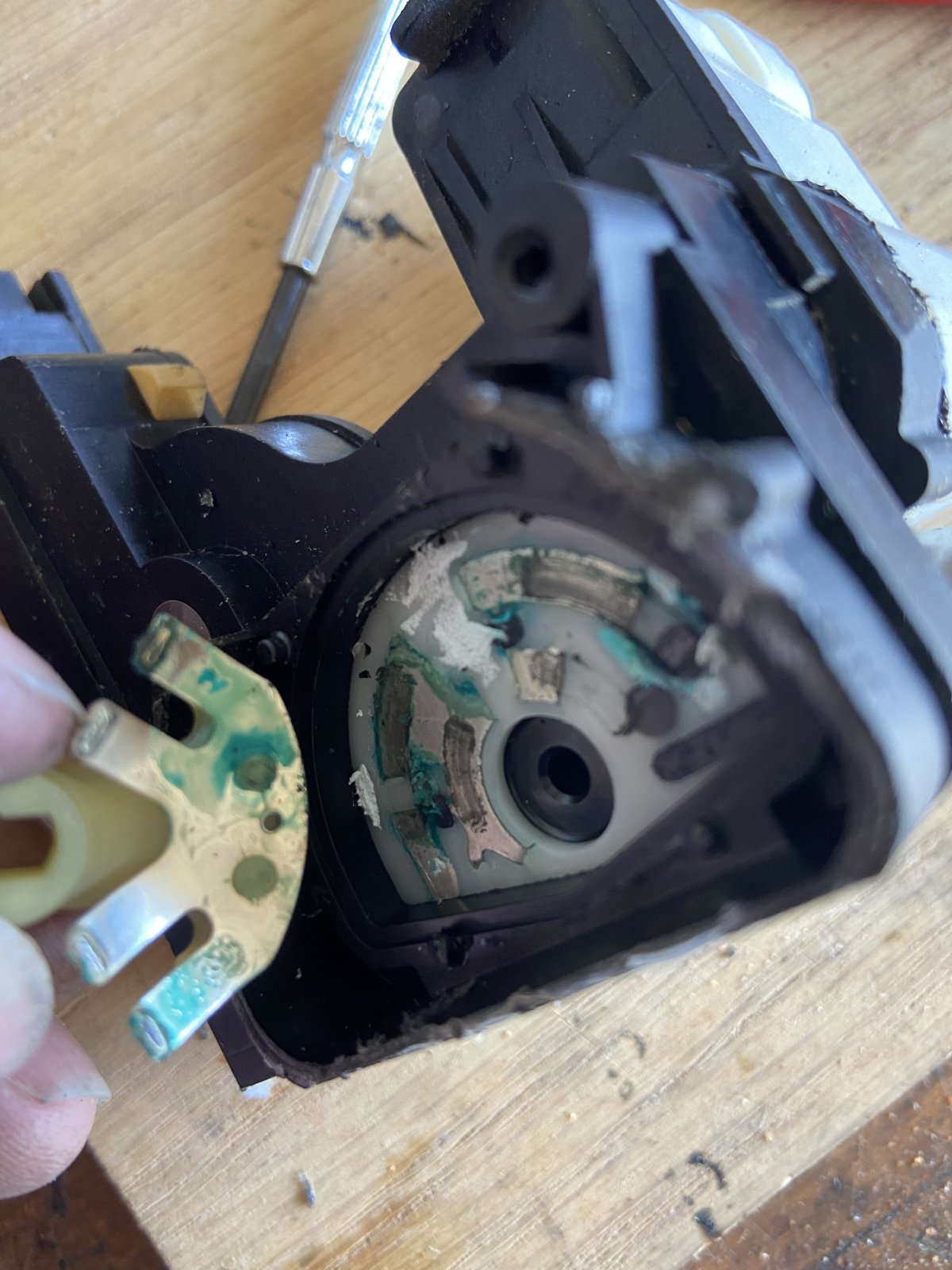

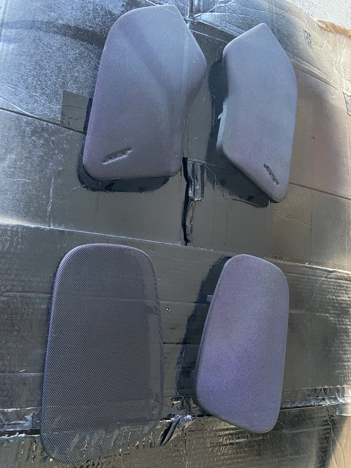

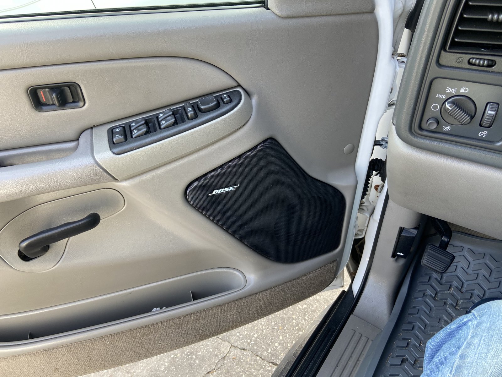

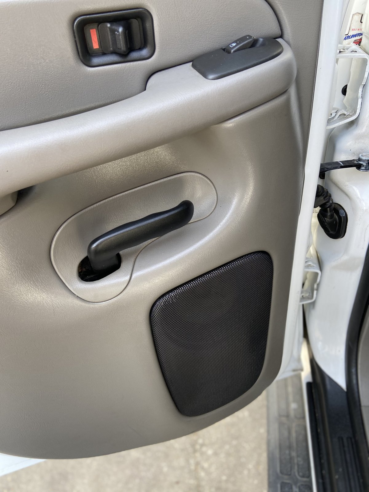

Finally got around to painting the speaker grilles. Decided krypton semi gloss black was good enough for $4, couldn’t get the right SEM paint locally (and it’s like $20). Had to disassemble the passenger side lock assembly, it wasn’t turning on the dome light anymore, so I said “might as well paint em.” Lock contacts were nasty green. Hopefully it works after reassemble heh heh 25339A79-2B6C-4147-85AB-83FAF4845ED0.jpeg

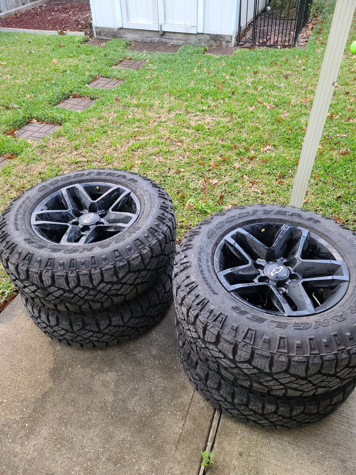

Picked these up last night on offer up. Were down the street from my house. Guy took them off a 2021 Trailboss in favor of some aftermarket 20s and 35" tires. His truck still had paper plates in the driveway. Can't wait to mount them!!

These are 18s on 275/65/18. Will let you know if they don't fit my 2005. Yeah the guy I got them from had nice set of Fuel Off Road 20" wheels. I need locks and wheel locks. Going to crank on the front keys a bit to minimize front rake. I plan on lifting it with 3" spindles as I don't want to deal with poor suspension geometry and
