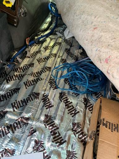

Got a little bit of time on my hands so decided to put in some sound deadener in the truck. It’s a work in progress, I don’t really have any space to store anything.
Couple pics, because it is happening and I know how we all love pics!
Finished the rear...
Moved up to second row...
I have a few spots that I need to place some trimmed pieces but wanted to get as far as I could using full sheets. But that’s where I stopped for the time being. Still need to remove the front seats and center console so can finish up. Still undecided on whether or not to do the roof or how far up the side I’m going to go. Im a little hesitant about removing the headliner. The headliner does need to get redone but I’m hesitant about doing that as well!
I am glad you are sound deadening but it is not necessary to have complete coverage with cld tiles. Like 25% is enough. Better to take that money and put it in to ccf and mlv. Those you would want full coverage.

Would have liked to have known this before hand! Lol...could’ve saved a lot of time. But since I’ve made it this far, I might as well continue on to the finish line. But I will take this into consideration before moving on after I finish the floor section! Thanks!

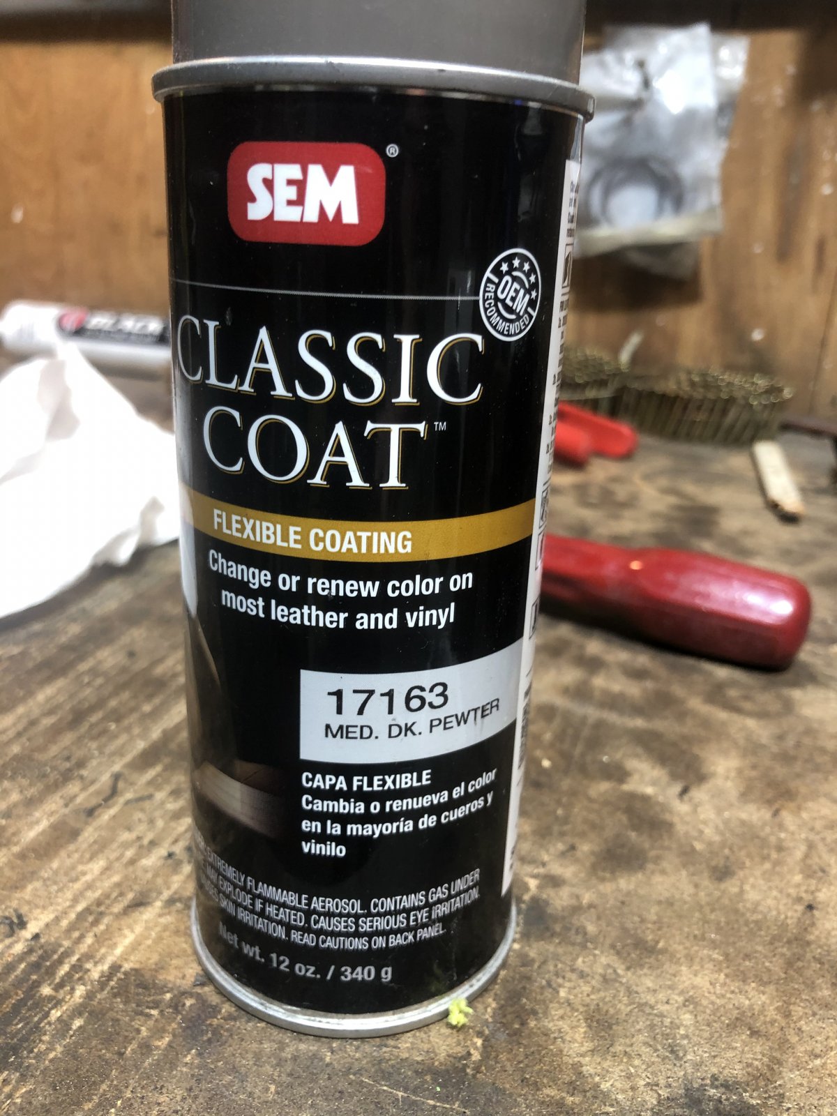

Does anyone by chance have or know the SEM part number for the 05 GM 922 interior color? I’m finding several different color names for this RPO code.

The lighter color. I’m finding pewter, dark pewter, shale and graphite. I want to re-spray the speaker grills. If you know the darker color that’d be great too. I have a stitched dash grab that I could dye lol.
