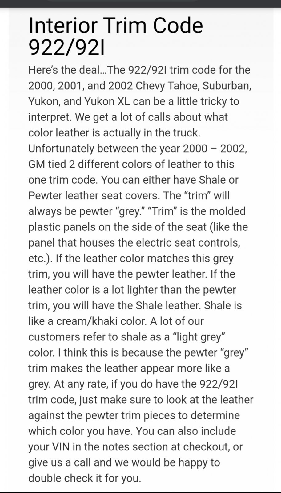

Ok. Here's the thread (in which I posted a link to another one, as well)...
https://www.tahoeyukonforum.com/threads/grey-carpet-color-dye-recommendations.105841/
The info is from theseatshop. Screenshot....

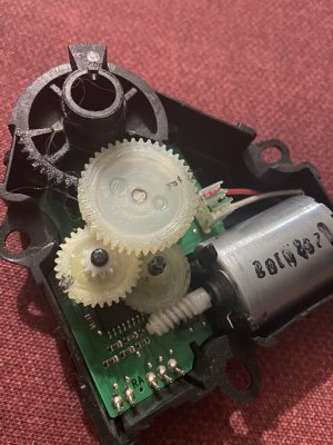

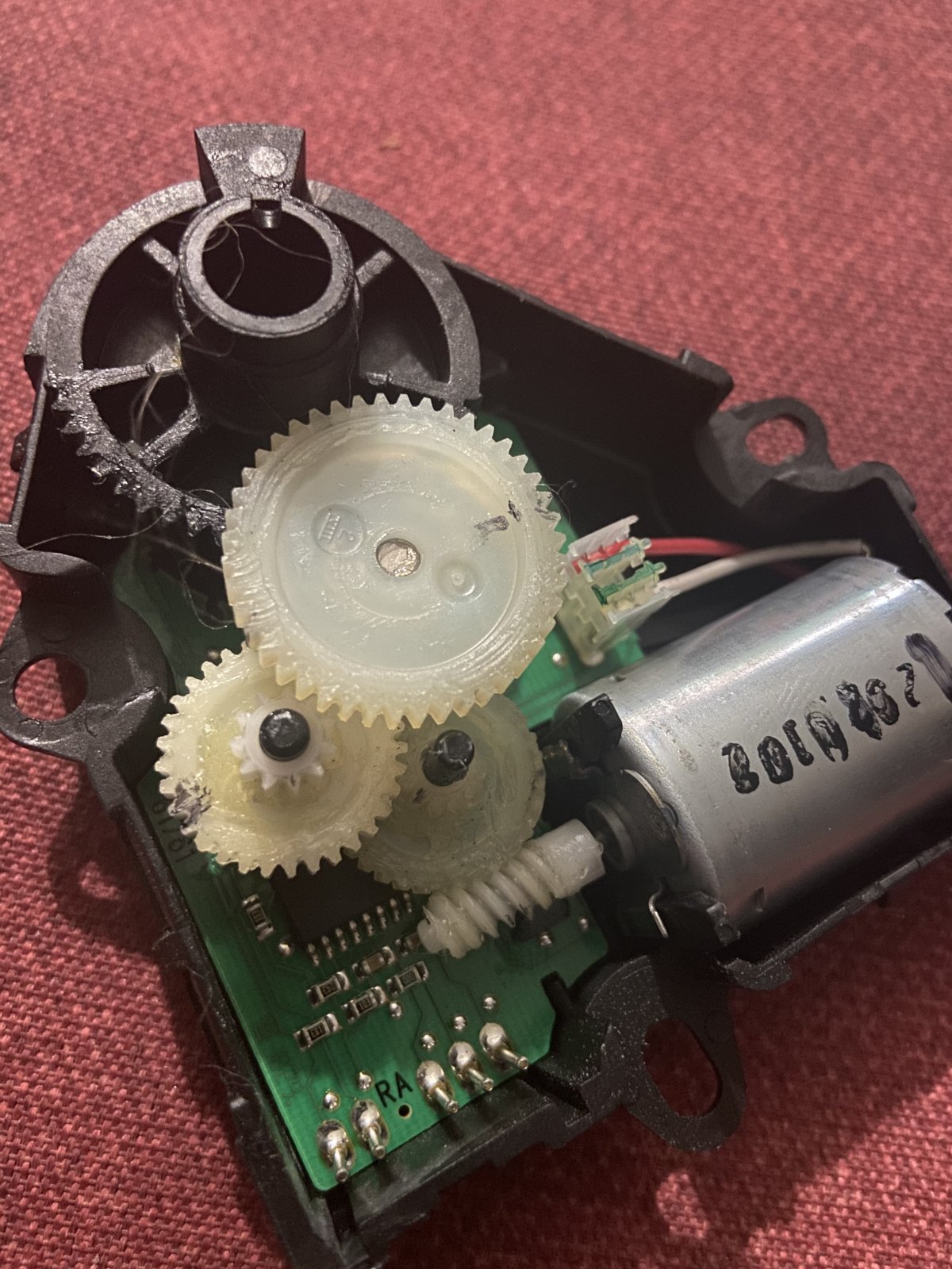

Finally replaced the driver side blend door actuator that I’d had sitting for 4 months. 3 years ago it turned hot once, I took it apart and cleaned etc. worked fine until a couple months ago, it did it once. This week it happened 4 times, so in the new one went. Old one still clean this time, the contacts weren’t green and gooey this time under the black gear
